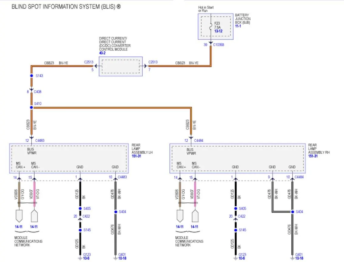

Unfortunately, the Wiring Diagrams for the BLIS are lacking (DETAILED) wiring pinouts and if you are not attentive to it, you can get confused.

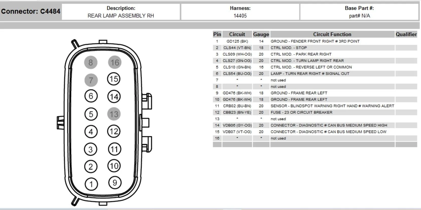

1. Ref Ranger Bills - Diagram above, 1 item on that diagram is the C4483 & C4484 are not at the Taillamp connectors - They are located just below them.
2. The Taillamp Connectors - Downstream of those connectors are C4471 & C4472 - The ones at the taillamps.
3. No detail is given past those connectors, C4471 & C4472 as it is not part of the chassis wiring and that is the (BLIS) module connector (internal & integrated) to the taillamp assembly itself
I saw it somewhere in a wire print, (listed C #) but that number is not found in a search and for the like of me I cannot locate that diagram again.
4. No detail is given on why the RH side has an extra Ground- (Pins 9 & 10), this is something I have not had time to dig into (Indepth) as I am curious for the need.
I believe this is for (Bulb Outage) Monitor - Not sure yet

Ref the Ranger Diagram Below:
In trying to determine the reason for the Right Taillight Assembly to have an internal ground wire difference from the Left Side.
I believe that the when the Right Side gets a Reverse signal, it triggers the Ground to close via Pin 9 - which is spliced with Pin 10 - Pin 10 is used by both sides for BLIS Ground.
So, my theory is that Pin 9 is the Trigger for the BLIS to switch from BLIS to Cross Traffic (CTA)
In other words, All Lighting uses Pin 1 as Ground and the BLIS uses Pin 10 as the BLIS Function Ground and uses Pin 9 (Which is spliced with Pin 10 - On the Right Side (Only) provides the Ground for the CTA function.
This is just a theory as none of the manuals cover this part of the operation and the only thing that makes sense is Pin #9 is a - Trigger from an input and the only thing would be to switch the module from a BLIS Function to CTA Function when it sees Reverse Gear (either from the MS-Can) or seeing Power applied to the Reverse Lights Circuit.
Another Possible Theory and that ties to - Trailer Connected & Cross Traffic, I do not tow but the manuals are not 100% clear as it states both (Active & Deactivated) for CTA with a Trailer Connected. (And if a Message is Displayed) CTA Deactivated - Pin 9 may be taking away the ground from pin 10 when it sees Reverse Input & Trailer Connected
In other words, this could possibly be the way the CTA gets deactivated with a Trailer Connected.
Again - Another (Switched based input - Trigger)

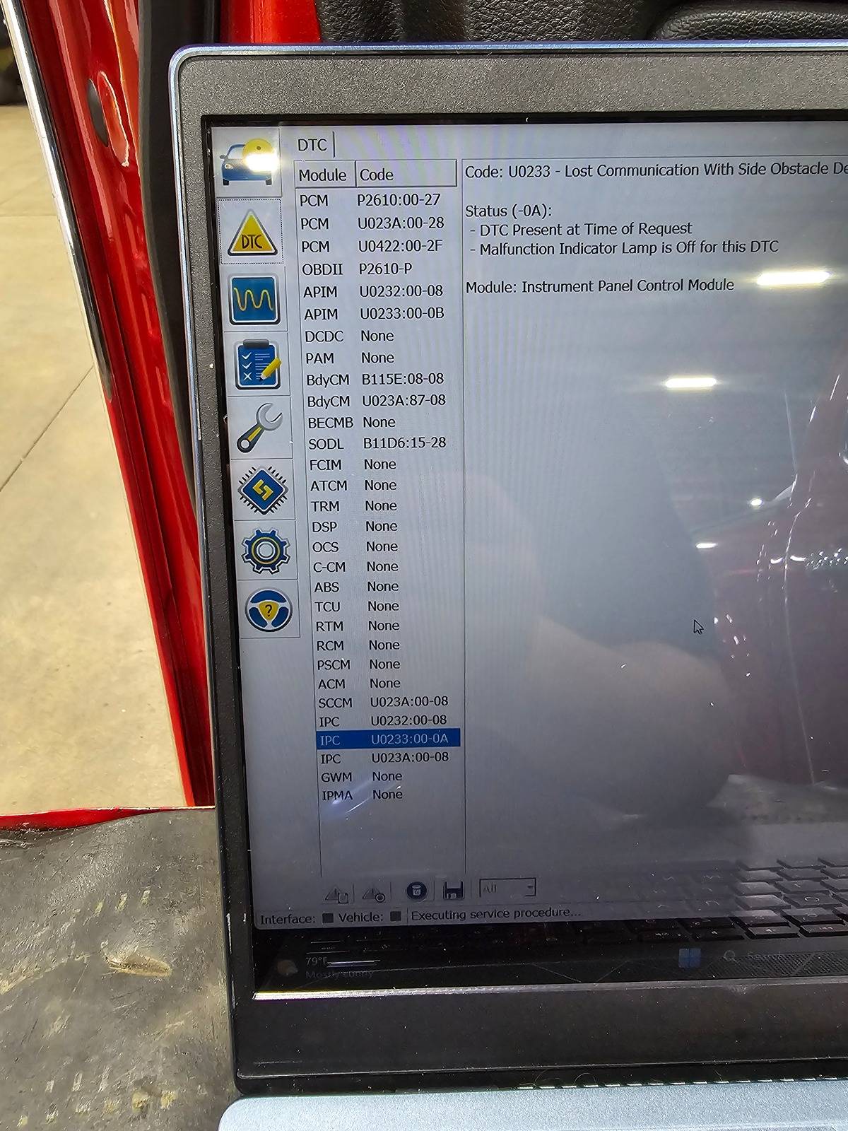

So this is what I got yesterday when I plugged my OEM passenger taillight in
The SODR needs As-Built data loaded to it
If you don't have your As-Built data files go here:
Index - FordServiceInfo.Com (motorcraftservice.com)
Note if you download the file it will be an (AB) file and unreadable, so save it as a PDF file.
Scroll down to your SODL & SODR - Data
SODL = 7C4
SODR = 7C6
Then go to the Forscan (As-Built) SODL & SODR and ensure each line matches the As-Built data you got from the Ford Database.
Make a note of all lines or take a picture or back up the file before you change and write new data. This way if something goes array you can set it back to the previous data.
For ease of finding the lines that do not match - only look at the last 2 characters of each line
as the last 2 of each line are the (checksum) for the data line - if any character is changed on the line the (checksum) will change
The lines that are the most important is the Vin # lines, that is what is triggering the code
But check ALL lines to ensure they match, note SODL & SODR are coded different
An example:
7C6-08-01 - will most likely be 3146-5445-5238 (this is the first 6 of you Vin# in Hex)
(1FTER4) almost all Rangers the first 6 are the same
SODL
7C4-08-01 - Vin# 1-6 (in hex format)
7C4-09-01 - Vin# 7-12 (in hex format)
7C4-10-01 - Vin# 13-17 (in hex format)
SODR
7C6-08-01 - Vin# 1-6 (in hex format)
7C6-09-01 - Vin# 7-12 (in hex format)
7C6-10-01 - Vin# 13-17 (in hex format)
When the dealer performs a PMI- they download the As-Built data from the site above or from the installed module and then load that data onto the new module.
Being that you have swapped modules around, it appears that module data just needs to be loaded and the most likely item its looking for is Vin data
