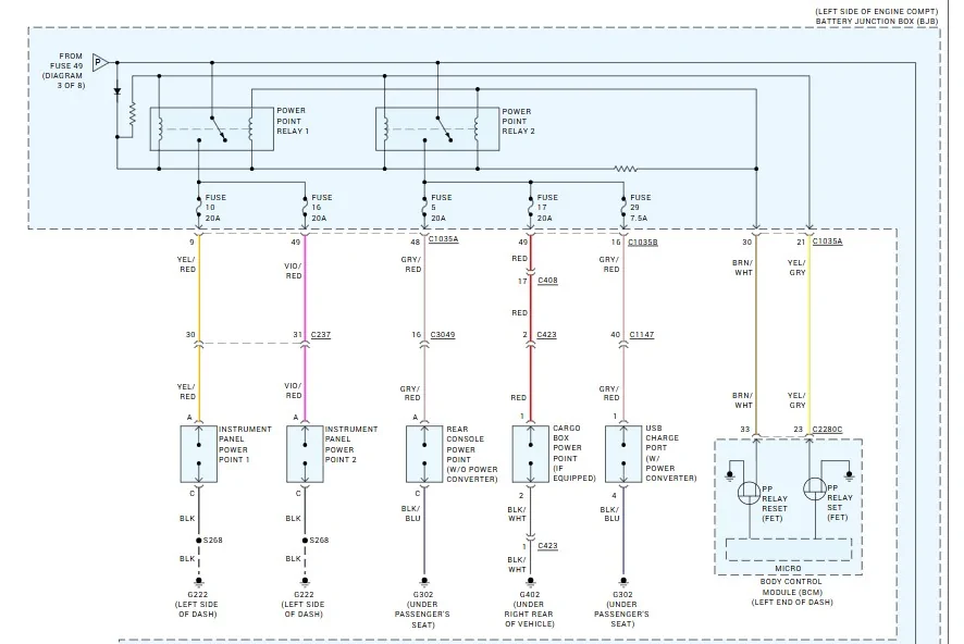

Ok, I was viewing on my phone on my last update - After the post I remembered previously looking at the diagram from the manuals (like posted) above which leads you to think that the relay has 2 separate outputs for each relay (except not depicted)
This diagram makes more sense.
as @RangerBill points out
The Relay (SET) latches the relays (Pulsed Ground) (This enables the Power Point Timeout) of 75 Minutes
The Relay (Reset) Unlatches the relays, so after 75-Minutes (Pulsed Ground) and the relays power off.

Is there voltage at F10? I think F10 feeds the left dash power point. Check with truck running.
I verified on my truck that F16 feeds the driver (left) side dash power, not the passenger side.
I will have to check mine, but I think Ford (since the 5G is a variant based off of the ROW) that Power Point #1 if a RHD Truck would be RH, I am curious if the ROW diagram depicts it that way.
Thanks for noting that - this points out that the wiring diagrams may mislead sometimes.
I would have to dig for the answer, but do some trims only have (1) Power Point? I know that some only have the single USB vs the dual USB Hub.
As I have understood all trims had the 2 Power Points in front and the variance was in the rear center console.
I was thinking the same on the wiring designations being based on the ROW Rangers.
Checked mine today - my 2022 is the same - Fuse 16 = Drivers Side and Fuse 10 = Passenger Side
