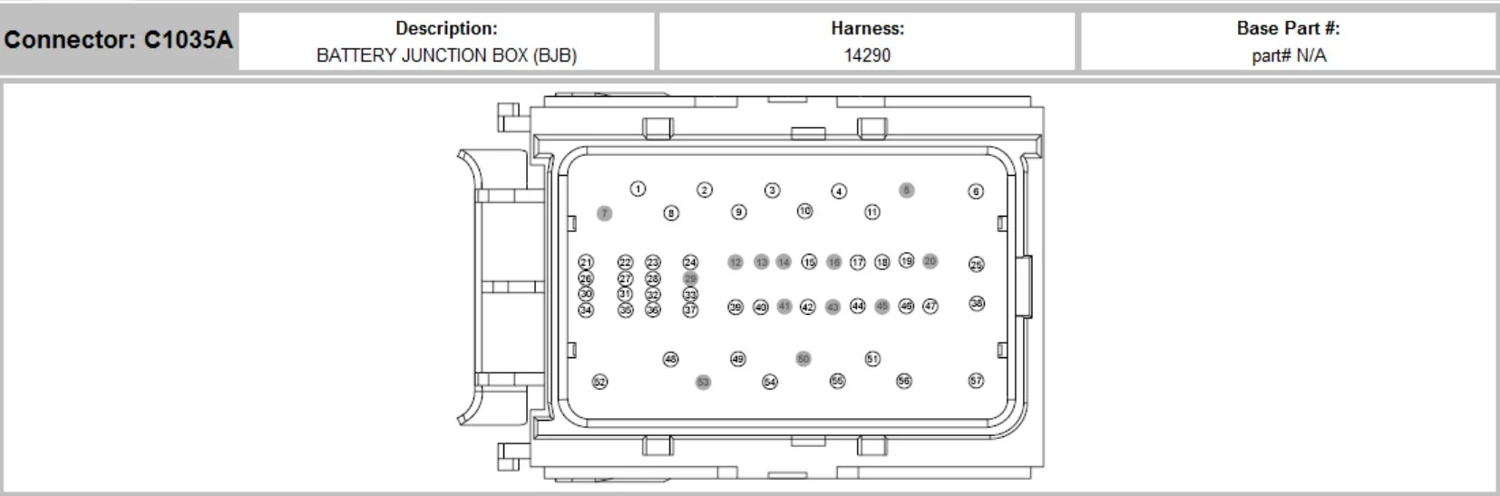

Can you explain how you are testing for voltage across the F10 fuse ?
If you have a good F16 fuse and are seeing 12 volts to ground on F16 driver's side fuse socket, then you should see 12 volts on the other side of the fuse, if it is good. There may be an open connection from the load side of the F16 fuse to the BJB plug or anywhere in the circuit to the power point socket. Check for voltage on pin 49 of the BJB connector C1035A (violet-red wire) with the truck powered up.
I was pulling the fuse (both slots) and placing both test leads onto the pins in the slots. F10 is showing 12+ Volts, F16 does not. I've rechecked a few times.

If you are measuring voltage across the fuse socket with the fuse removed, this is not a good test of the circuit.
If you have an extra fuse, pop the top off of it. This will allow you to measure voltage to ground on both sides of the fuse while installed. You should have 12 volts on either side of the fuse to ground with the truck powered up.
