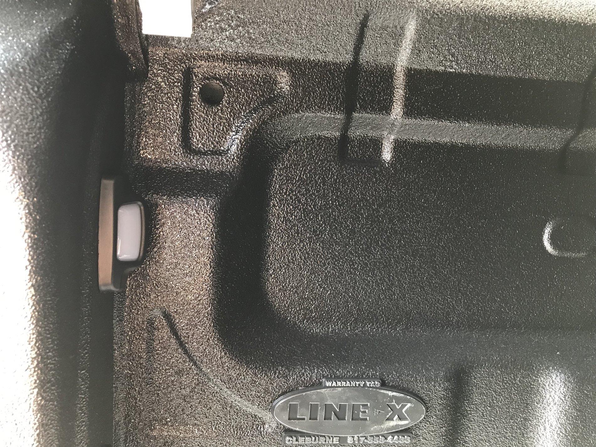

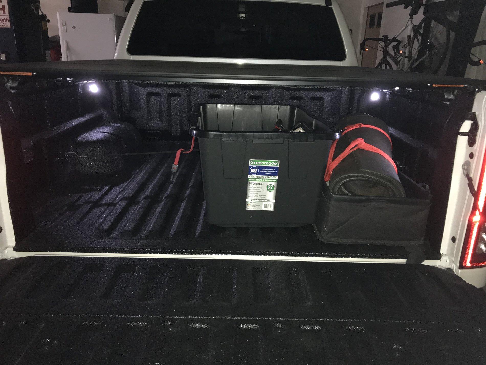

I got my $25 bed lights installed this weekend. Thanks to those who contributed to this thread on tapping the 12V bed power supply.
I spliced the wiring harness (part #KB3Z-14A411-A) for the bed 12V socket assembly (part #: 7A2Z-19N236-A) and used crimps with glue and some heavy duty landscape wiring for my pigtail to power the lights. Wired in an 18mm round rocker switch to turn them on/off as needed.
I can confirm, as others have, that the 12V bed socket (and thus my lights) stays powered for an extended period of time after you turn the truck off. The only downside is if you walk up to the truck and it has been turned off, you need to at least hit the ignition button once to fire up the electronics in order for the lights to work. Remote start can solve this problem.
The lights are 1” square and have 3M adhesive on the back. I took the advice of an Amazon reviewer and bought nickel sized round magnets that I attached to the adhesive/lights and then used the magnets to affix the lights to the truck bed. Super easy and the lights are now movable. The lights, 8 total, give off the perfect amount of illumination to let you see what’s going on under your tonneau.
The rocker switch location was my only mild miss on this project. I didn’t want to drill a hole in the bed, so I cut a hole out of one of the rubber oval shaped plugs on the sidewall. All was great until I found that there was not enough depth on the sidewall to accommodate the switch with the wiring harness on the back. It’s really close, but not perfect.
If anyone has ideas for a spacer or bracket setup to give it a perfect finish, please chime in. I probably need about an 1/8” more.

I picked up some #14 (3/4” inner diameter) O-rings at Home Depot. Pulled my 18mm round switch out enough to make the oval plug fit as it should and then slipped two of the O-rings on to give it a finished look. All good.
Thanks all for helping with the solution!

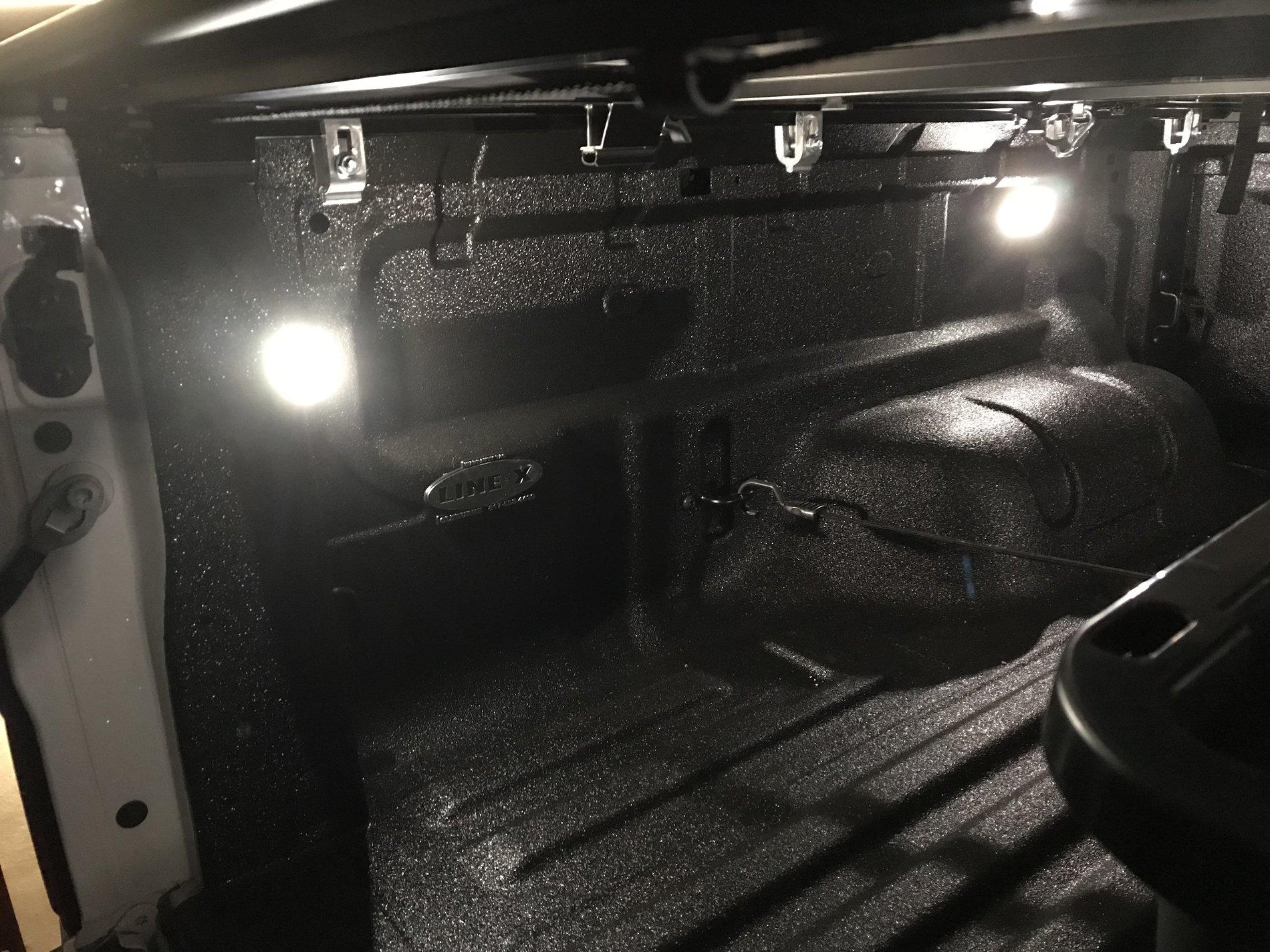

Unfortunately, I did not take a picture of the lights before install. Powered from the 12-volt bed port wires on the harness. I have a switch and the harness power also goes OFF after a while. The cover is closed in this picture.
Fuguang LED Truck Bed Lighting Kit 2PCS 60Inch Magnetic Attraction IP68 5050SMD High Brightness For Cargo Boats,Pickup,SUV
They are magnetic, so "stick" to the iron box.
