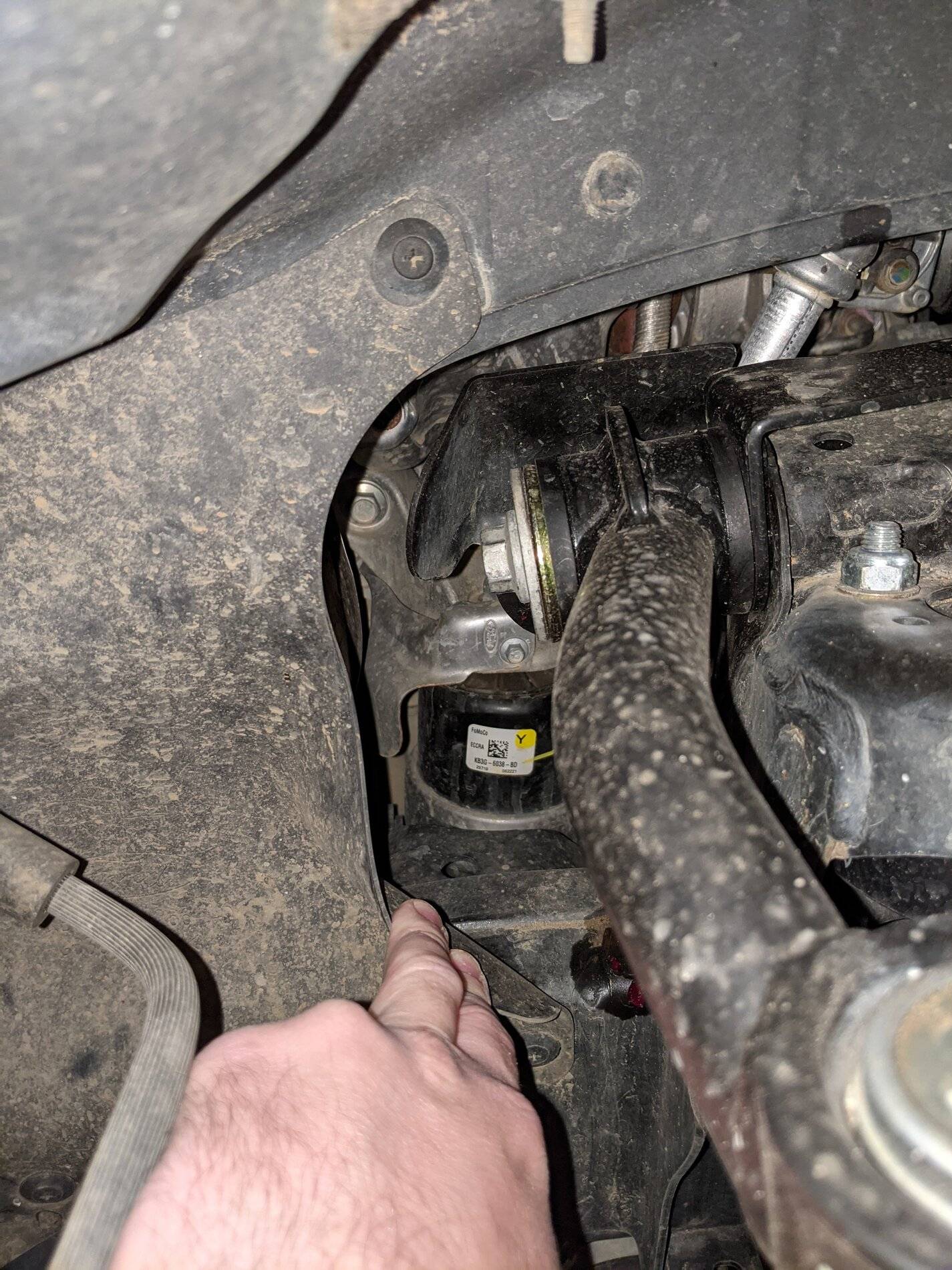

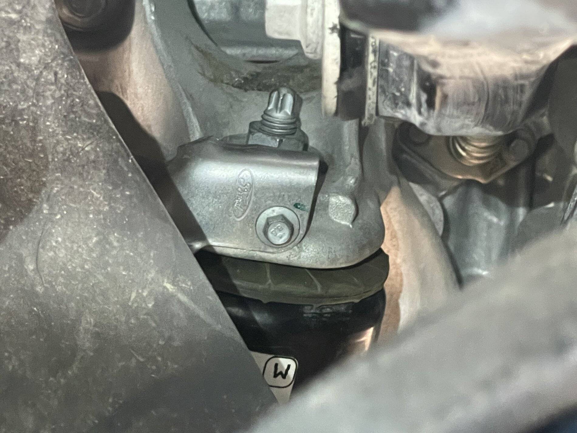

Ok I found my noise. The noise use 100 percent coming from the passenger engine mount. It sounds like little ball bearings moving around through my engine stethoscope. On the top portion of the mount is a big thick rubber washer thing. I can spin this thing with no effort round and round. I’m inclined to say it should t be like this.
The mount makes the noise tapping on valve cover, transmission, ac compressor, even bypass valve hose. You can tap with just your thumb and make the mount make the noise.
Could the mount be bad or improperly tightened?
If anyone is able if you can crawl under and thump your ac compressor and see if you hear a noise. Then see if your passenger side mount has the big rubber wager on top and see if it spins.
Im convinced this noise is causing false knock.
Thanks for any help.

It feels tight. Top is 18mm bottom is 21mm.
i'm not so concerned about the washer spinning at the moment because it could just be a dust cover.
but the knocking may be a sign of a loose nut.
can you get on them with a wrench to see, or get a borescope in there for a closer look?
they look like single piece units...I cant find a real picture yet, just schematics.

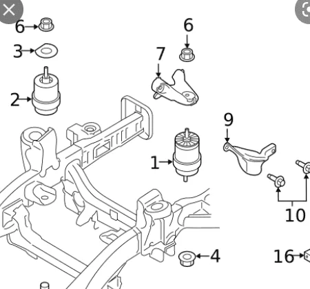

I've noticed a knock on mine when at WOT or under load. I went out and checked the passenger side mount real quick and the rubber washer thing spins and moves. Did your neighbors washer thing spin too? To be clear, the part with the label is what I checked. It would be #3 on the diagram @RANGER PRIDE posted so it doesn't seem like a structural part
