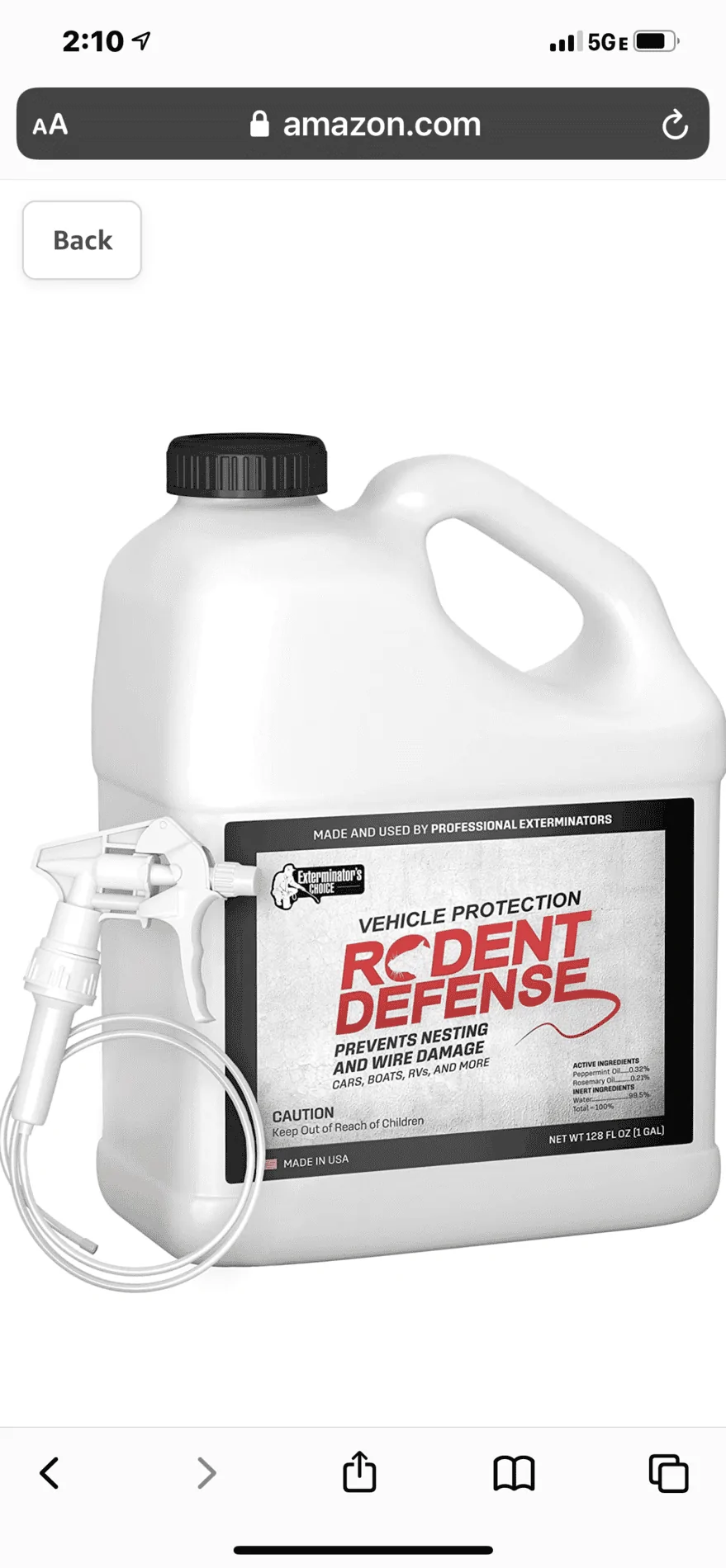

I’m using Grandpa Gus packets and spraying Rodent Defense under the hood and wheel wells. Time will tell.
