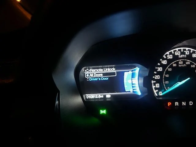

Don't forget you also have a Door Lock setting in the IPC:
You do not have to use the Key FOB Method
Settings - Remote Unlock (All Doors) or (Driver's Door)
