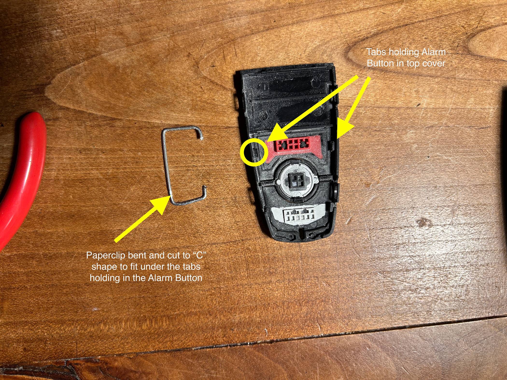

Last night, I tripped the Panic Alarm on the Key Fob for the hundredth time.

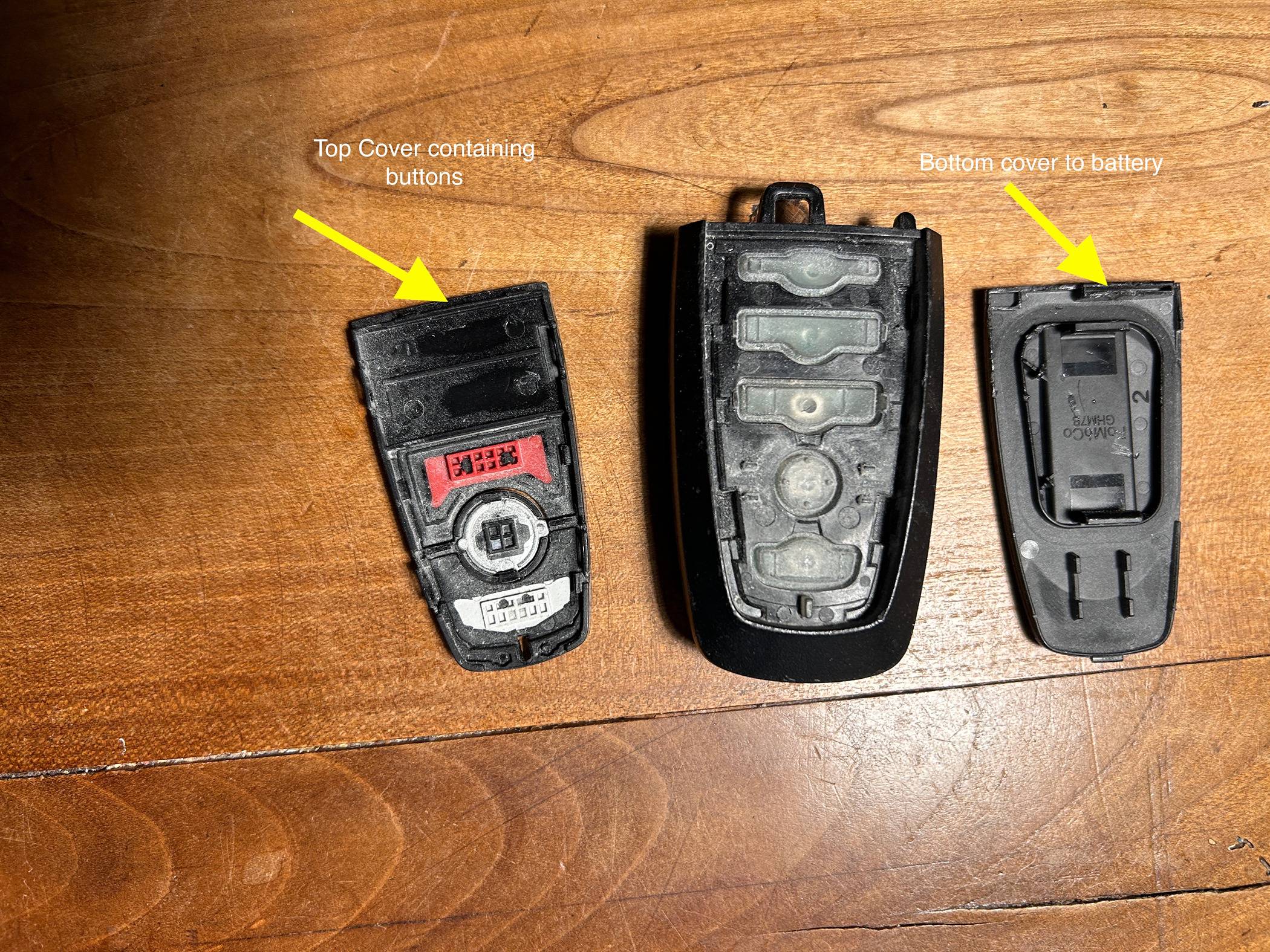

I said, no more, determined to find a way to stop it from being accidentally pushed. I also wanted a solution that I could back out if I sold the truck, so no glue. The Fob upper, button cover, comes off with prying just like the battery cover.

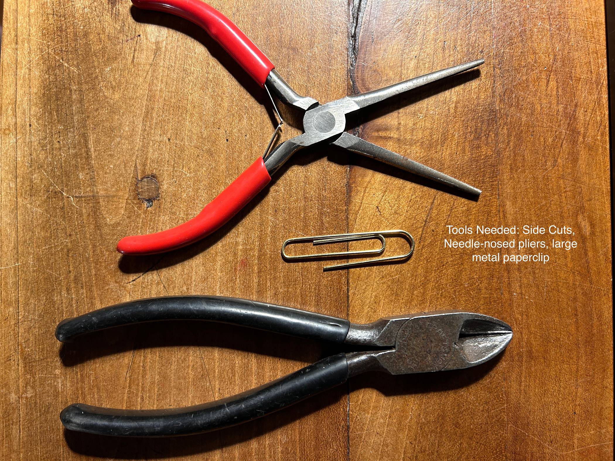

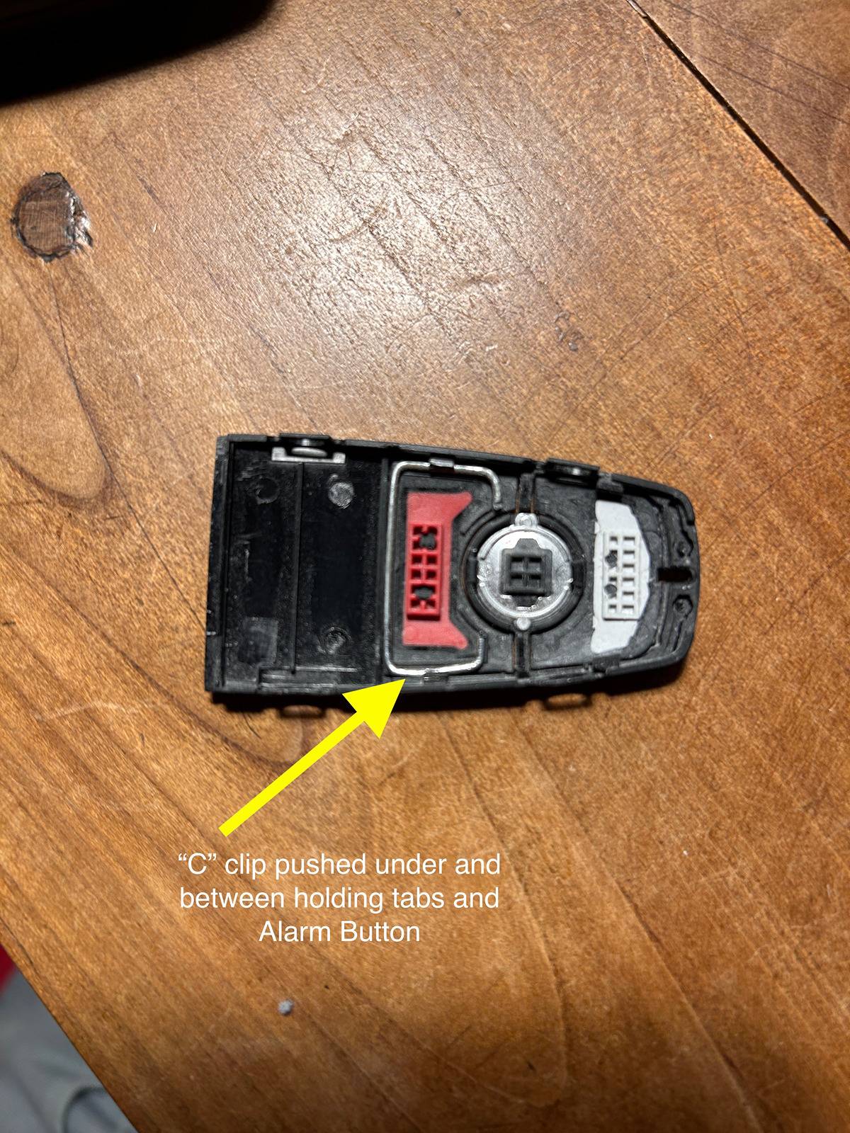

Taking a large paper clip and cutting and bending it into a “C” shape with the dimensions to fit the opening. I made it slightly oversize so that it would squeezed slightly to get it under both tabs. The slight “spring” in a paperclip holds it in place. When I press the Alarm button, it does not move at all. I consider my problem solved. Hope this helps someone else that is tired of repeatedly silencing the honking car in the garage.

This looks like a fairly simple fix for folks not interested or comfortable changing things using Forscan. And, it’s free - bonus!
I’m not sure my keyed fob comes apart the same way as the push button start version. Has anyone done this or something similar to their keyed fob?

Love it. I don't have FORSCAN (would like to get it at some point) but I do have paperclips!
I like your MacGiver approach and you shaped your clip to greater precision than many aftermarket mods!
