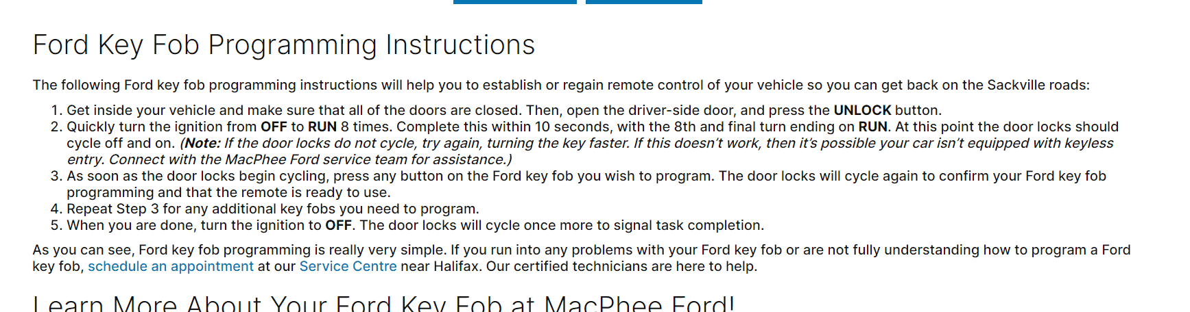

Ive seen many techniques online how to do it. not sure if they apply to an online purchased fob or not.
has to do with cycling the key, pressing buttons, chewing gum at the same time etc....
Never tried it, so mileage may vary.
End of line 2 states "If this doesn't work, then it's possible your car is equipped with keyless entry. Contact Ford service team for assistance."
OP has a Lariat. Do all Lariats have keyless entry??

End of line 2 states "If this doesn't work, then it's possible your car isn't equipped with keyless entry. Contact Ford service team for assistance."
I saw that too... (corrected as noted).... do they mean keyless start? My XLT has keyless entry.
also, if they truck has a pushbutton start, how are you supposed to turn the key when there isn't an ignition switch to turn it in?
Turning the key with keyless start is just pushing the button once but do not have your foot on the brake the truck will boot up but will not start.
