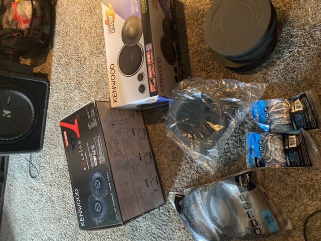

I just installed the 7 inch kenwood excelons and the kenwood performance series components in the front. And BOY these things sound way better than stock and have surprisingly a good bit of bass that makes it seeks like I have a 10 in the back.
