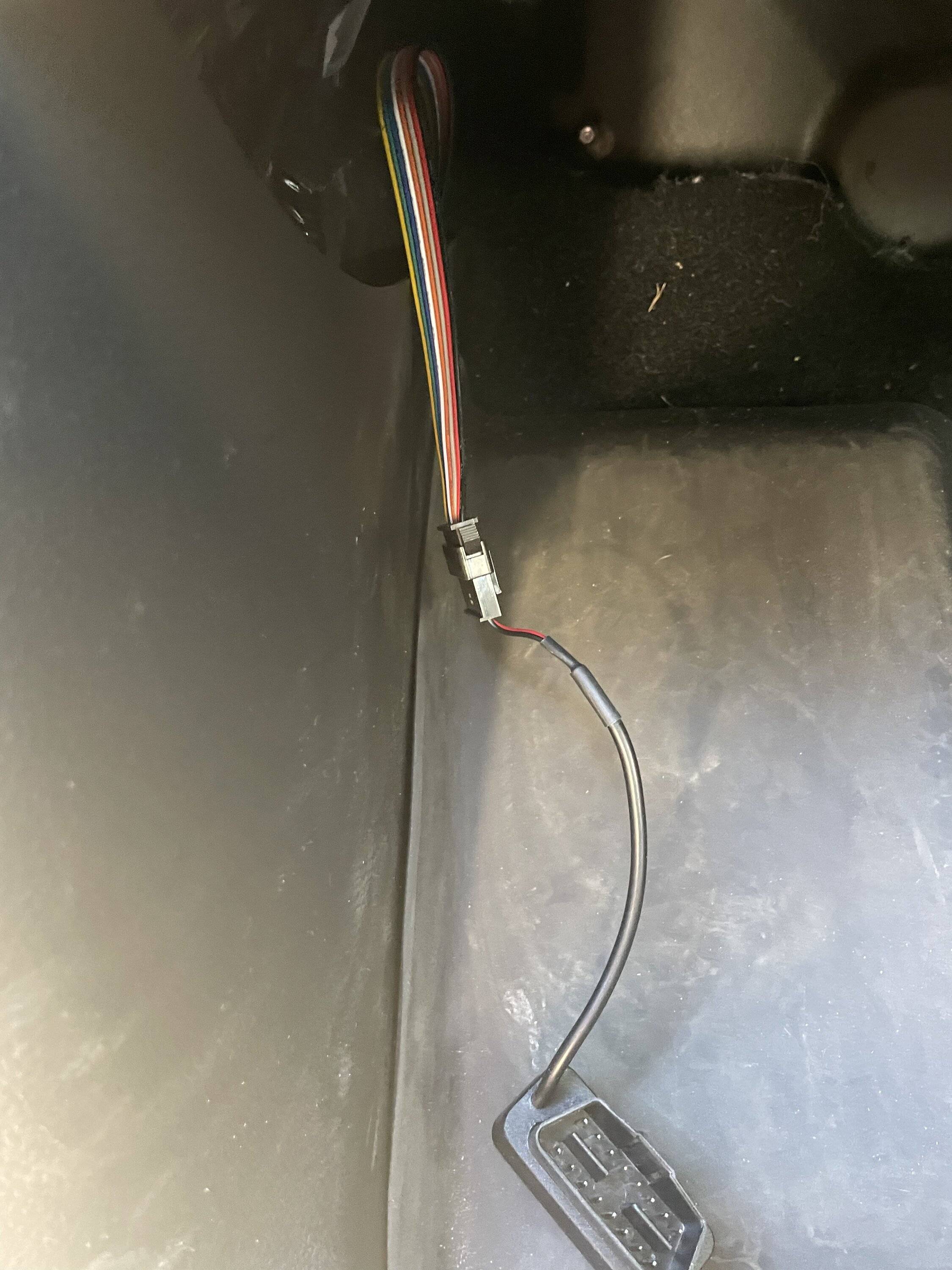

Because it's not just a plug -- it's basically a box with circuitry. Something like that could easily tamper with intended functionality or influence readings by devices (i.e stuff DEQ depends on) trying to monitor the vehicle.
Except that the only way a device can do that is be resetting things in the PCM. If devices did that so easily by just plugging in then you would have plenty of signs while driving the vehicle if you can get it started.

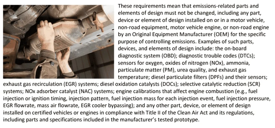

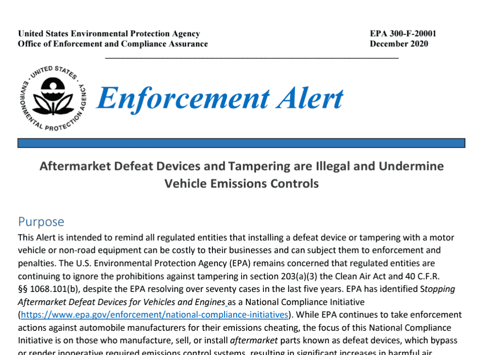

I would want them to cite documentation that proved it was illegal. If they cant identify it how do they know it’s illegal?
this might be a good start:
Its sketchy enough to raise a red flag.

OK, unless I'm missing something we have not seen what @banerjek is talking about in post #11. The only picture I've seen is from the OP, and that definitely looked like a power take off. The current discussion sounds like something entirely different that we haven't been shown.

allow me to translate this epa / govt document.
The Revenue militia has discovered that defeating devices and tampering with electronics that the government has not taxed and not made a profit on or taken over are being used. someone is making money that we are not getting kickbacks from. This must stop until we figure out how to subsidize it. oh and clean air...

I would like to point out that the initial poster who provided the picture, and the person complaining that they were held up in emissions because of a non-OEM port are two different people. Additionally the poster complaining about the non-OEM port and emissions issues has not provided any photographic evidence of the issue.
For all we know they have had a obd2 splitter cable installed with a tracker/power take off installed and the free female end hanging loose.
It is different -- I should get a pic. It's some kind of in line box. You have to unplug something to get to the ODB port which is in the box. My gut reaction was to remove the box, but it's not something that was just plugged in. Also, unplugging to get to the ODB port, but doing so, caused terrain mode warnings to appear.
What I find interesting is that others are not seeing this in their trucks. My truck is one of the really early ones. But it was ordered straight from the factory and I paid in cash so there's no reason to expect them to install anything extra that I didn't pay for.
