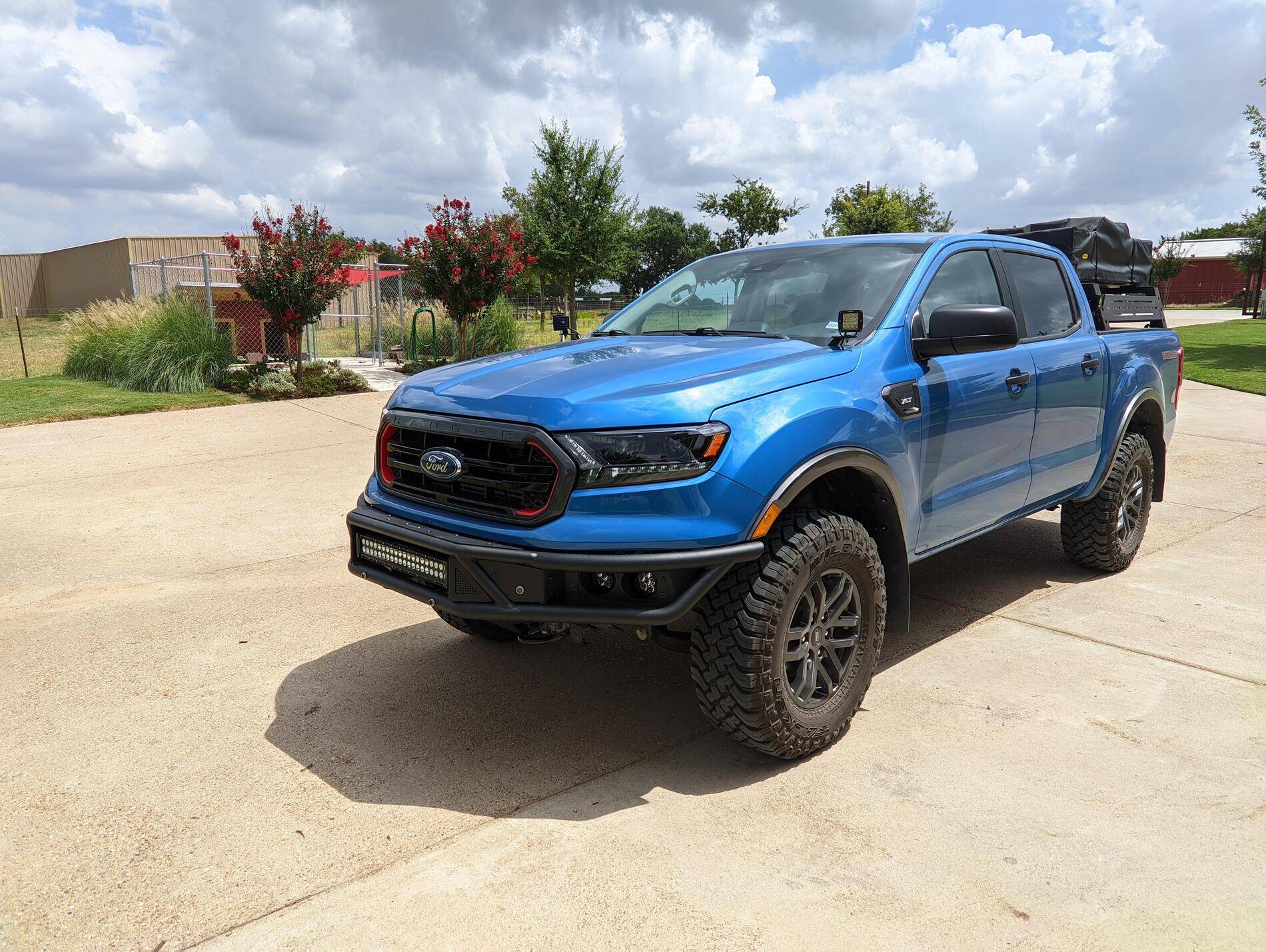

Installed the Westin Outlaw bumper today

Probably. I was like 5 hours into installing my Pro-Mod bumper and was pretty done for the day lol. But I believe there are direct fit options for anyone that doesn't want to modify anything else. It also looks like you'll have to extend the wires for the ACC module as well if you want to put it up there.
Did you have to do anything with the wiring harness on yours?
The Westin description says it includes 20 gauge pigtail and connectors
wyyup
May 11, 2021
Tulsa, OK
2021 Cyber Orange Tremor
The Westin description for the Pro-Mod bumper also said it fit 30" light bars. Their descriptions and installation instructions left a lot to be desired.
My relocation bracket did not come with any extension.

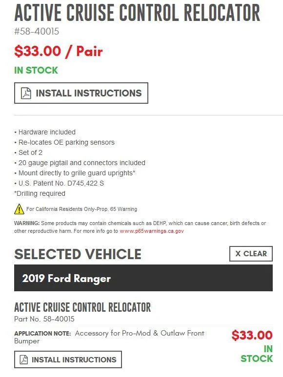

Now you mention it, here is the full description for the ACC relocation. Which clearly is meant for parking sensors....
That's the exact same part number as the one I ordered. So I guess it is just more of them being terrible at having accurate product descriptions.
I actually really like the way the pro-mod and outlaw look and they're the most affordable options.
The instructions for the pro-mod were historically bad. I ended up using Addictive Desert Designs instructions for removing the old bumper and then just tried to interpret what the westin instructions probably meant to do.
I am having an issue with the outer most parking sensors thinking something is in the way. I haven't figured that out yet but I haven't done a ton of research into it yet.
It was really tight, but mine reached using the Fab Four. I’d imagine that the Westin puts it in the same spot since there’s not much wiggle room there

I found another ACC relocation bracket late last night. This one looks optimal because it moves the unit below the air seperator behind the grill and should be much better on the OEM harness length.
https://caliraisedled.com/products/2019-2021-ford-ranger-acc-radar-relocation-bracket
I like this one a lot better. More disassembly required but I've been eyeing a new grill anyways so if I get them both I can install this when I do the grill.
Thanks!
Edit: This also looks like it gets the unit closer to the center of the vehicle. I had read of some people noticing a bias to the left lane on some other mounts.

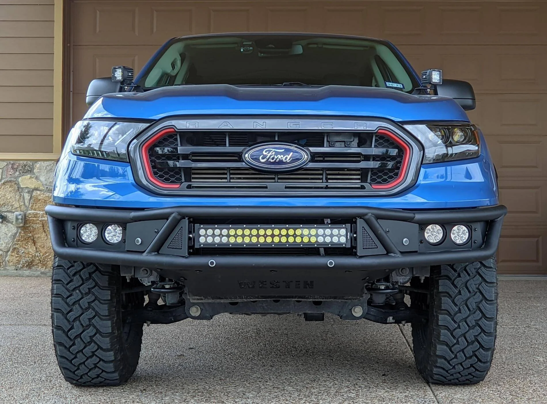

Product itself gets a thumbs up from me - however their install instructions are garbage. Overall satisfied even though it was a little terrifying trying to do it all on my own. I relocated my ACC sensor with the Fan Fours bracket.
Another disappointment was that Westin told me the light kit has DT connectors - so I ordered H11 to dual DT so that I could run these as my fog lights so now I'm waiting on some other connectors to come in.
Gained a good bit of clearance in the front - the lower skid plate comes in Monday to finish it off.
