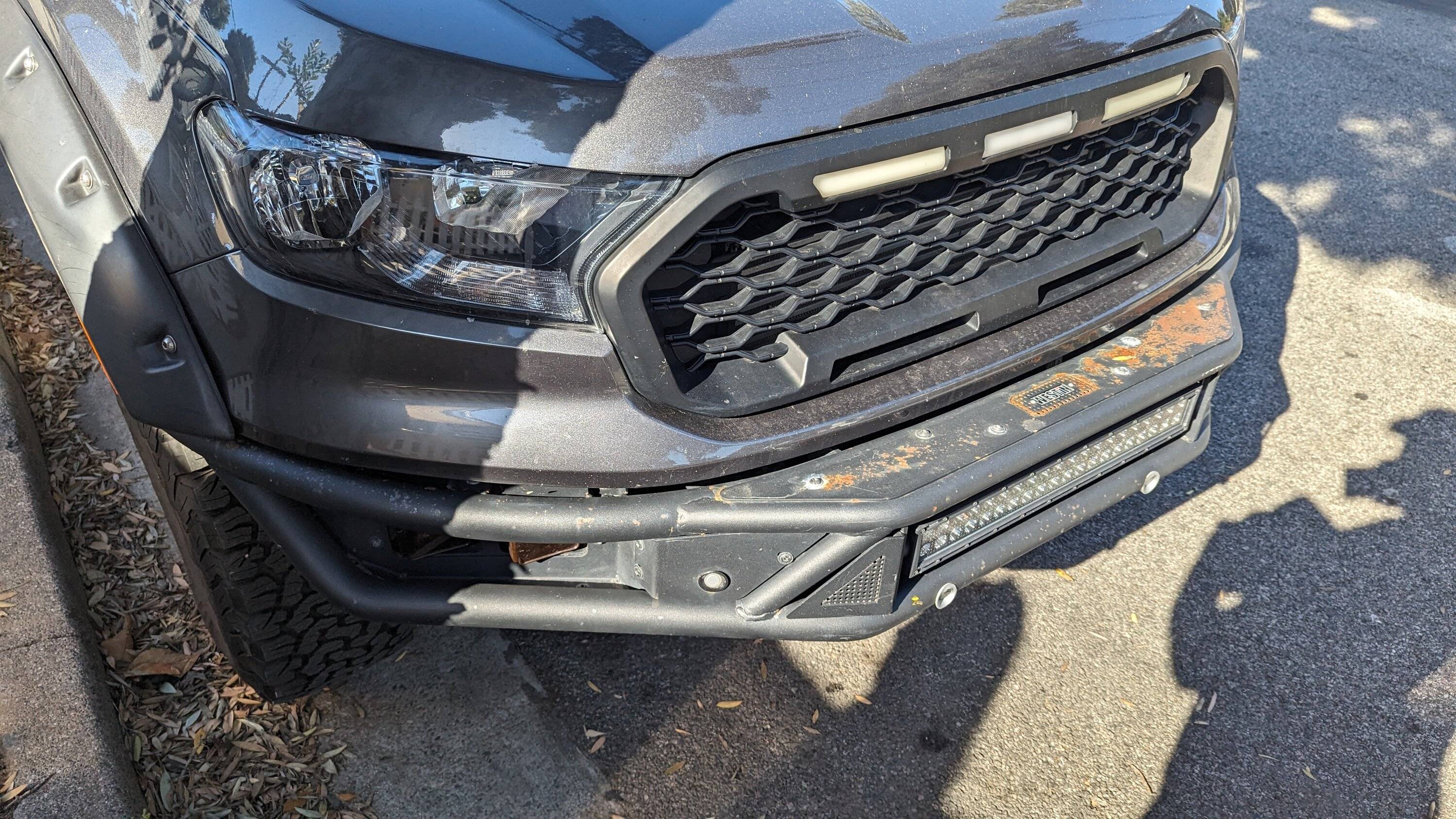

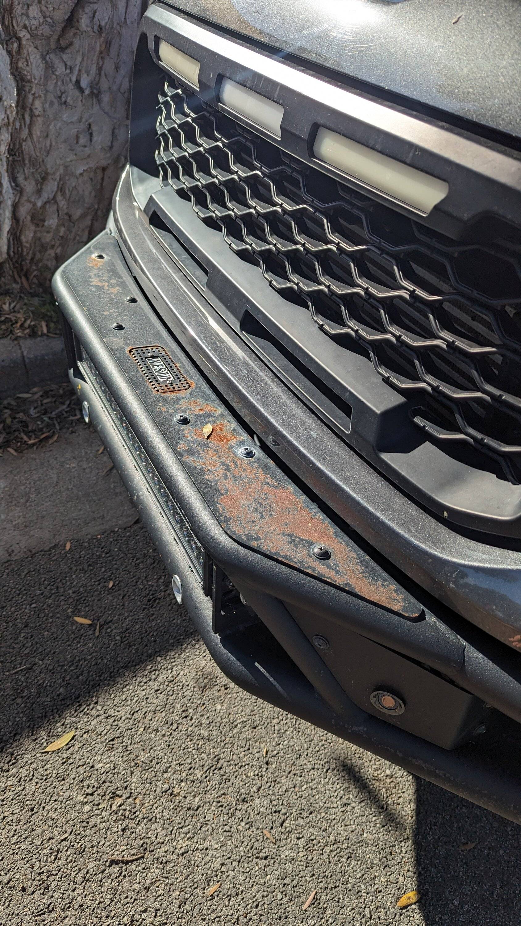

Hey all,
I installed the Westin Outlaw Front Bumper on my 2019 Ranger a couple years back. It's already started to rust (<3 years in), which is kind and of concerning. I'm reaching out to their customer service because it should be just barely covered under warranty, will report back with that experience, but probably won't recommend this bumper again.
Bumper bought April 2021. Rust started about 2 months ago, Sept 2023.

Is it just the top plate or are the pipes rusting also ?

Steel rusts outside if it gets scratched or doesn’t have good coat of paint. Thatā€˜s an easy fix, especially if it’s just that top plate. Sand it, prime it, paint it. I would use bedliner to paint it. You can get it in spray cans.

From what I see it's just the top plate. Simply remove the thing and go through the process to clean it all up and repaint it. After that you should probably be fine. When you get down to it Weston is one of the lower quality places anyways

They responded on the warranty and no replacement parts because they stopped manufacturing this bumper. Offered me the Westin Pro-Mod Front Bumper (which admittedly looks sweet) but they are out of stock until March. Other fun fact, Westin doesn't pay for labor for warranty replacement, wouldn't be a big deal for just a bumper, but the sensors + light bar are going to make this a full days job for me to do.
The saga continues. Will look into the cleaning/coating recommendations above. Appreciate that!

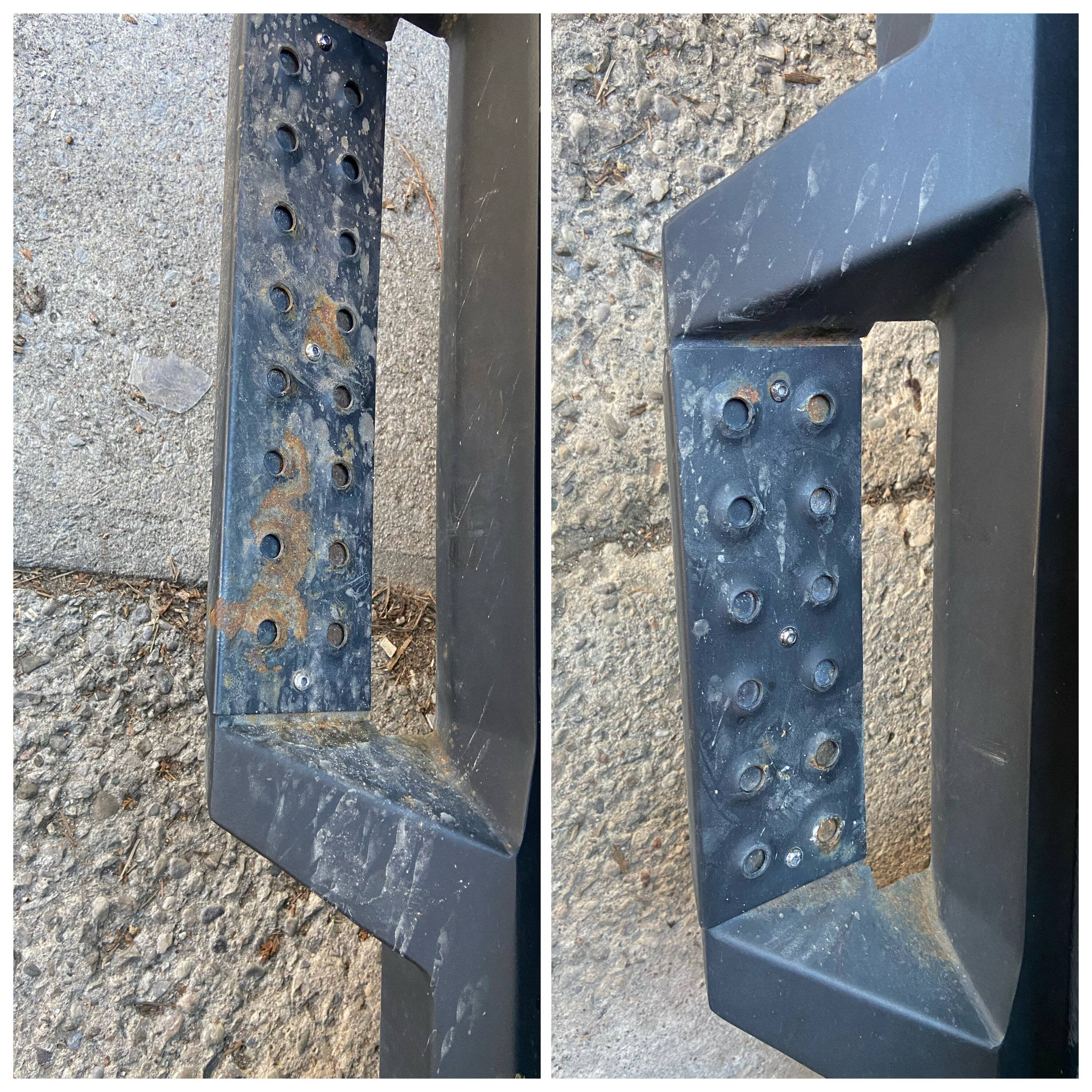

I had a similar thing happen with my Westin HDX side steps…
It seems their thin bolt-on parts aren’t as well protected as the rest. I removed them to fix them up for a Line-X type finish but summer and life got in the way and now I don’t miss them ar all so they might never go back on. ?
