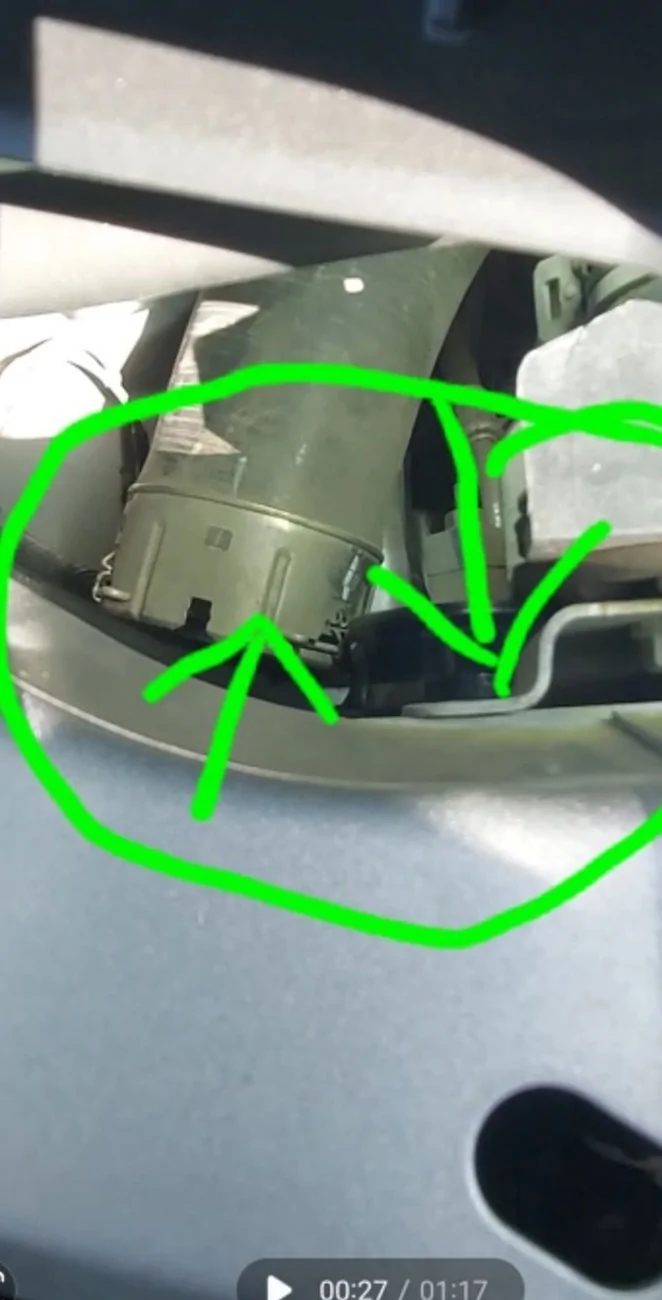

I was going about 60 and wanting to pass a car. Once i gave it a little gas humming and it seem like it was down shifting. The hose popped off. I pulled over and put it back in place and was on my way . Get it up to 65 and it popped off again. Anyone else having that issue?

or the clip is preventing the hose from going all the way on and letting the clip seat in its grooves. Try pulling the clip up and letting it rest on the outside of the coupler, then pushing the hose all the way on and seat the clip.

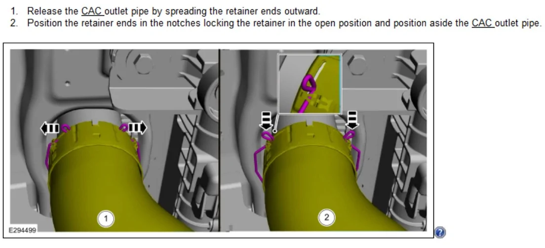

Put the clips in position shown in picture 2. then push hose onto cooler pipe. Then put the clips in the position shown in picture 1 to lock it in place.
