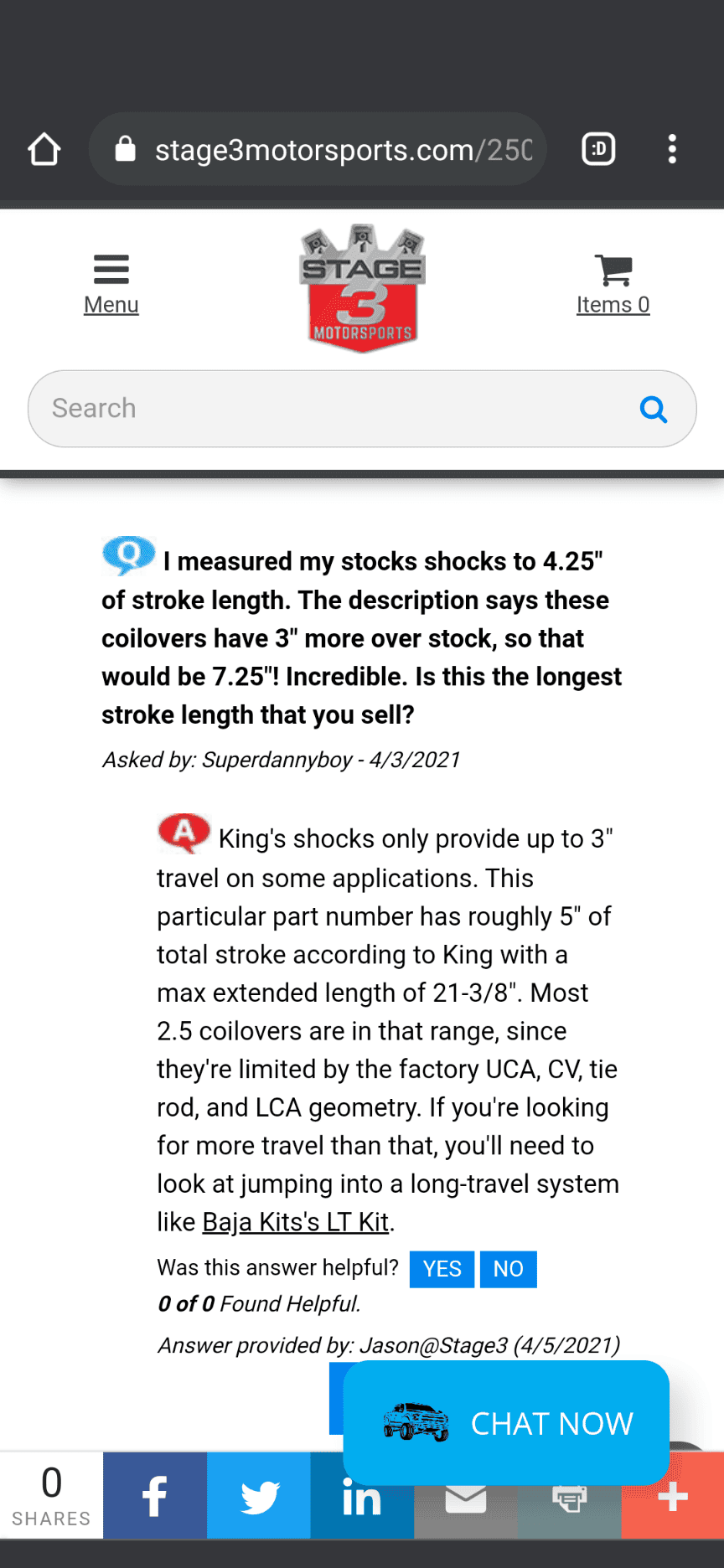

Here's what I got.
Icon extended travel = 5.25" stroke
King extended travel = 5" stroke
Bilstein 5100 = 4.67" stroke
Oem strut = 4.25" stroke
Fox dsc = 3.98" stroke
I wanted king because of the reputation I heard of, but icon got my money because they were available and took less than 24 hours to get to me. I value that, and after researching the company and the manufacturing processes and materials I stand behind them until I see different.
Here's the only info I got on the Kings stroke length.

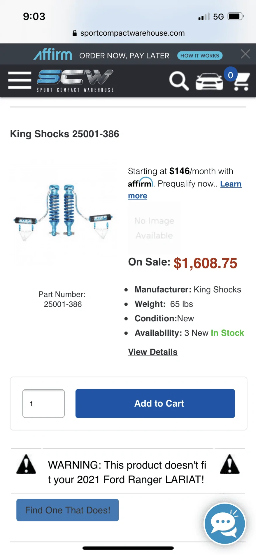

I picked up some king 2.5s 3 weeks ago from sport compact warehouse they were at my door in a week
That is a awesome site. Kings are not available there today. They don’t even list King as a manufacturer of anything in stock. Back to long lead times.
Megawatt
Joe
Feb 1, 2021
700
2,115
Sin city
Unicycle.
I make electricity
Shows 3 in stock. All you need to do is call them and ask if they have the adjustable in stock or the ET extended travel. Thats what i did
Your Google fu is strong Daniel san. I searched for 2021 ford ranger lariat and their database doesn’t like that combination, that is why I was getting zero inventory.
Warning is on the bottom of pic using a different search to find item for the king shocks.
But it’s a good idea for me in the future to cross check the part numbers with the manufacture to see if they do fit by searching older year rangers. There are small differences like cast iron spindles for 2021 lariats. No more sexy aluminum ones.

This is an update to Superdannyboy’s findings.
I contacted King to find out the compression and extended length of the ext. King coilovers (25001-386-ext) for our truck and these are the measurements.
The Ranger front coil overs measure 21.8” extended and 16.1” compressed. They have a total stroke of 5.3”.
