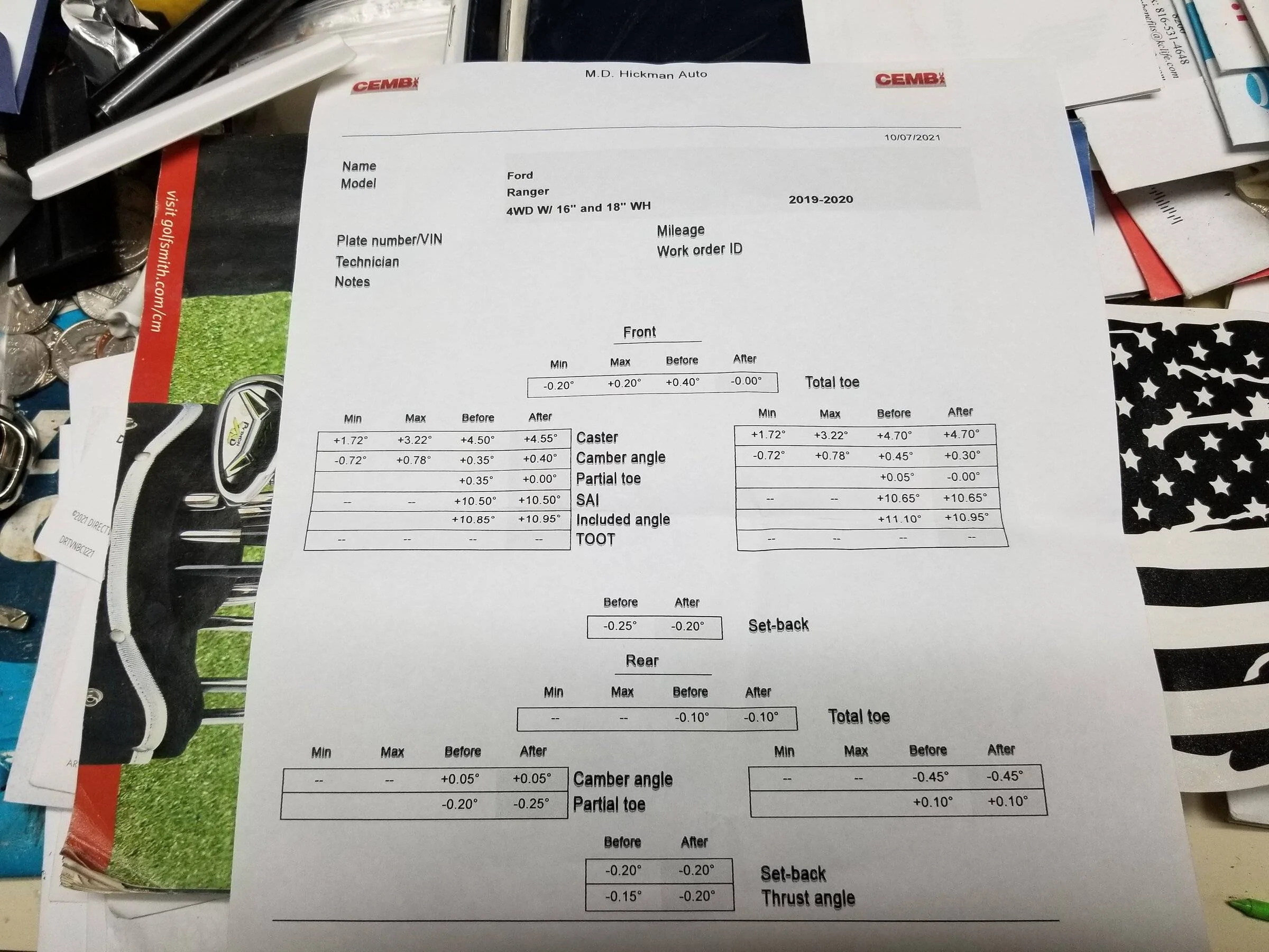

Frenchy makes valid points....when going to a 2.5 extended travel coil over several other upgrades are required to get the full use without binding and alignment issues...UCA and tie rod ends being the main two even with only a 2.5" coilover preset lift height...
And be aware that Ford Program alignment specs will no longer apply.
Pictures of my setup and alignment when I was at 2.5" of preload lift height....

Exactly as you described....I have the front drivers side at 3.0"" and passenger at 2.75"....I figure with me sitting in the drivers seat I am close to level driving down the road...I also have the ICON leaf spring pack in the rear....by getting the front more level, the rear went from a 3/8" difference in side to side height , to just 1/4" now,
