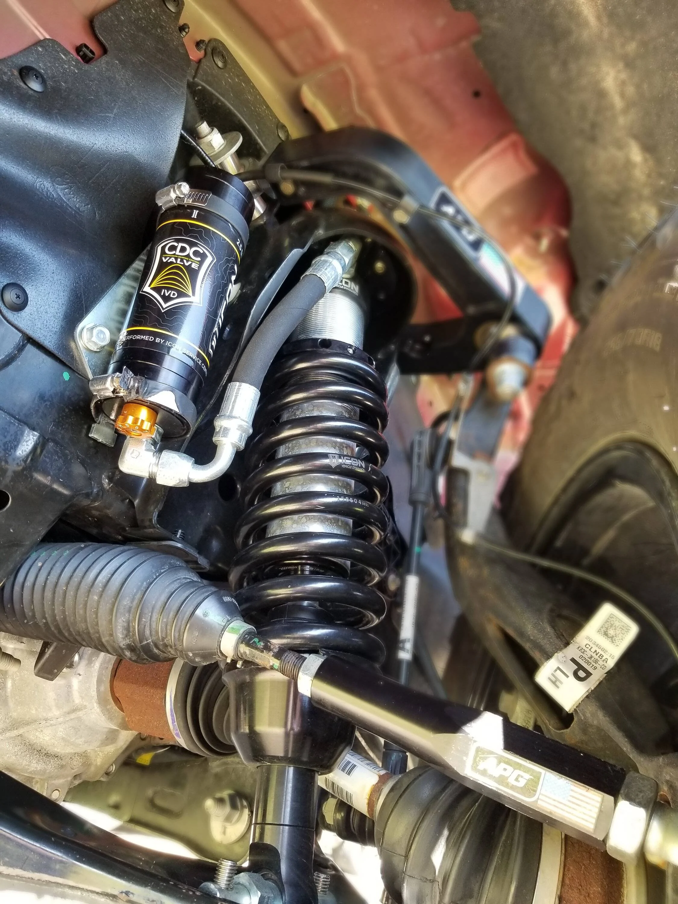

I have the ICON 2.5 ET CDCV RR coil overs with APG billet UCA's and APG billet tie rod ends to make full use of the extra travel without binding. And ICON 2.5 CDCV rear piggybacks with the ICON WTX progressive leaf spring
and bump stops .
After about 9 months of on and 300+ miles of offroad experience , I have played around with the damping enough to find what works and feels the best for me.
For street and low speed trails I like the front valve setting at 2 / rears set to 4 . Good damping and flat corner handling...for open desert whoops , washboard , and sandy moguls I have wicked the settings up to 8 front and rear for speeds up to 65 mph.
I originally wanted the King 2.5 , but "settled" for the ICON's due to availability...pleased to say the ICON's have exceeded my expectations and feel I did not sacrifice any performance going with ICON's in my
Mid-Runner set up....?
and bump stops .
Those APG uppers in blue anodize ???
Sounds like a great setup. Do the APG tie rod ends allow more travel before binding compared to the stock ball joint on the stock rod end?

YES...The APG billet tie rod ends with the Heim steering joint, FK bearing have a greater range of motion than the stock ball joint end... another plus is they hold their toe in alignment better after being properly adjusted.
EDIT: Yes the blue anodized UCA's with the blue King Coilovers would look great on your blue truck..
.I have the black anodized UCA's to better compliment my Rapid Red , black appearance package..
