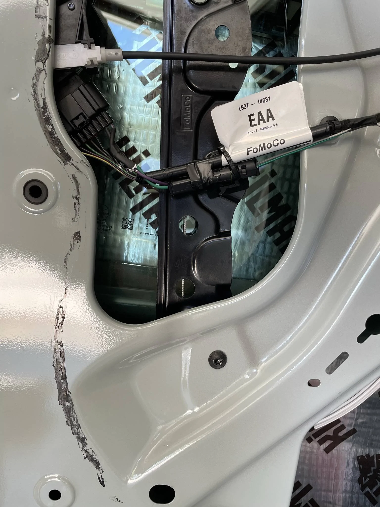

I just got mine installed a few days ago, , what a great upgrade, at least for me, you do lose the ability to lower the window a small amount, once you touch the button it's going all the way down.
So now, I push it down and pull it right back up quickly to have it cracked 1/2" or so, but the features are great otherwise, I use the rolling them all down before I go out and drive to help cool it down, and the crack all 4 after I lock it almost every time.
I did not use the T taps, I just wired them directly with a crimp connector and heat shrink with liquid tape for the seal and added a weatherpack connector in case I needed to remove the door panel later with the module still attached, because I used the industrial Velcro that's hard to separate.
It's funny, they say to mount the module with the connector pointing down in case of water intrusion. it's on the inside of the weather sheet, the two T taps they provide hook in the loom outside of the weather sheet, they could eventually corrode, I would recommend sealing them or using something else.
Install was easy, but damn, I never get used to the cracking and snapping sounds when pulling everything apart, Ford clips always sound like they are breaking, and I was careful not to snap off the end of the trim strip like the guy in the video.
A tip when removing the weather sheet, do it cold, the butyl is not as gooey, I removed the whole thing to add sound deadener in the door.

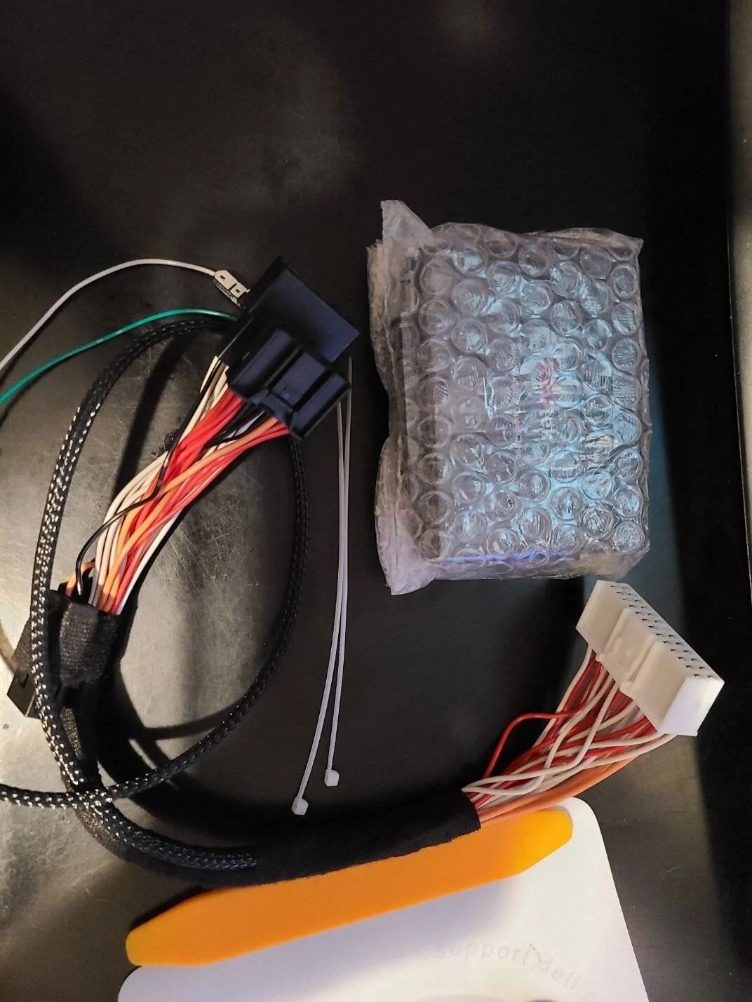

I got mine Friday, waiting until it warms up a bit this weekend and I will install it.
here are some photos:
