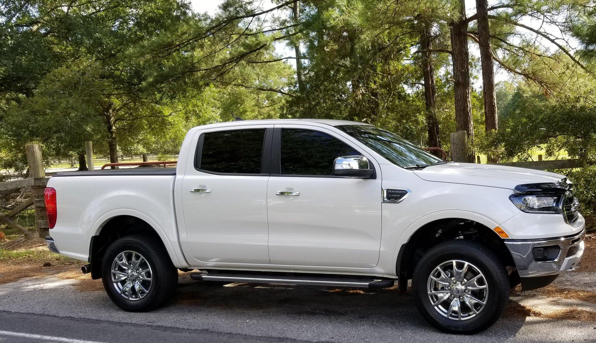

You have the front set at 2.5"? Can you go lower, say, 1.5"? I don't want to go so high that appears to be higher in the front.
You can adjust from 0 to 3" in front IF stock springs are used and 0-1" in in the back 2.5" does level the stock truck. I'll set using stock springs a 2.25" Front 0 lift in back
SPACER lift 2.5" Rough Country spacers
Using factory springs there are five options - stock height, 0.75” lift, 1.5” lift, 2.25” lift and 3” lift.

So Ford fixed the clunking (loose sway or tie bar ends) All is good but I'm still going to install the Eibachs when they get here. I found a shop with 52 5 star reviews. that does a ton of lifts. Labor is $60 an hour compared to Ford's Quick Lane at $145/hour
So my plan is to have one front side done to ensure the shocks will fit in a 2WD. Going to go 2.25" on the front, As it sits my truck is 1" higher in the back than the front. So at 2.25", I should be golden, I will ask the guys at the Shop if I should block the rear 1"
