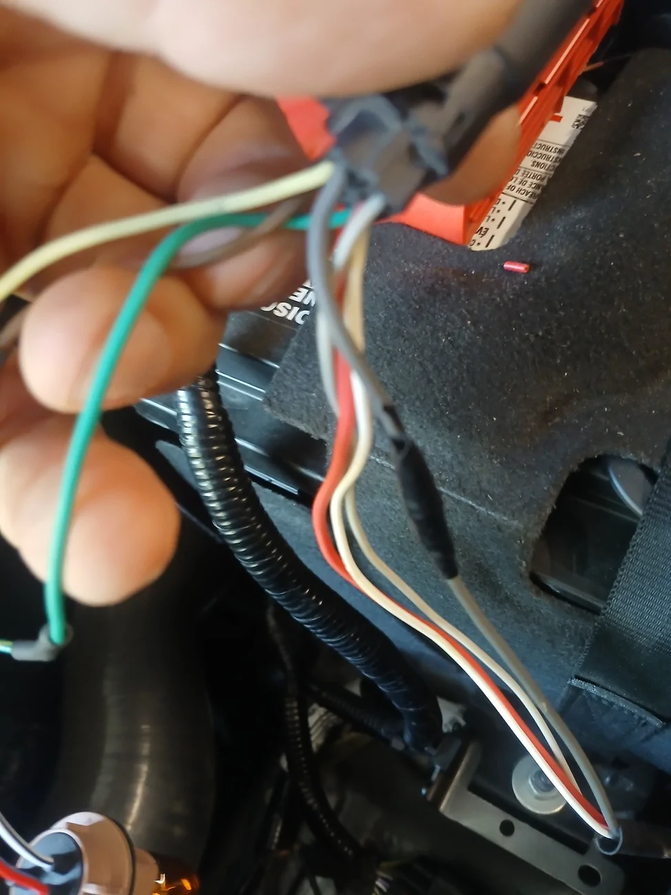

That stupid jumper came apart inside i guess 😒, when I used the meter with the "tone" option , nothing... ALL IS GOOD NOW !!!
I now feel like an idiot for wasting your time ! I apologize 😔... I used the jumpers so I wouldn't have to stick my fumble fingers down in there while testing, never dreamed one would be bad... sorry 😞and THANK YOU FOR HELPING ME!!!

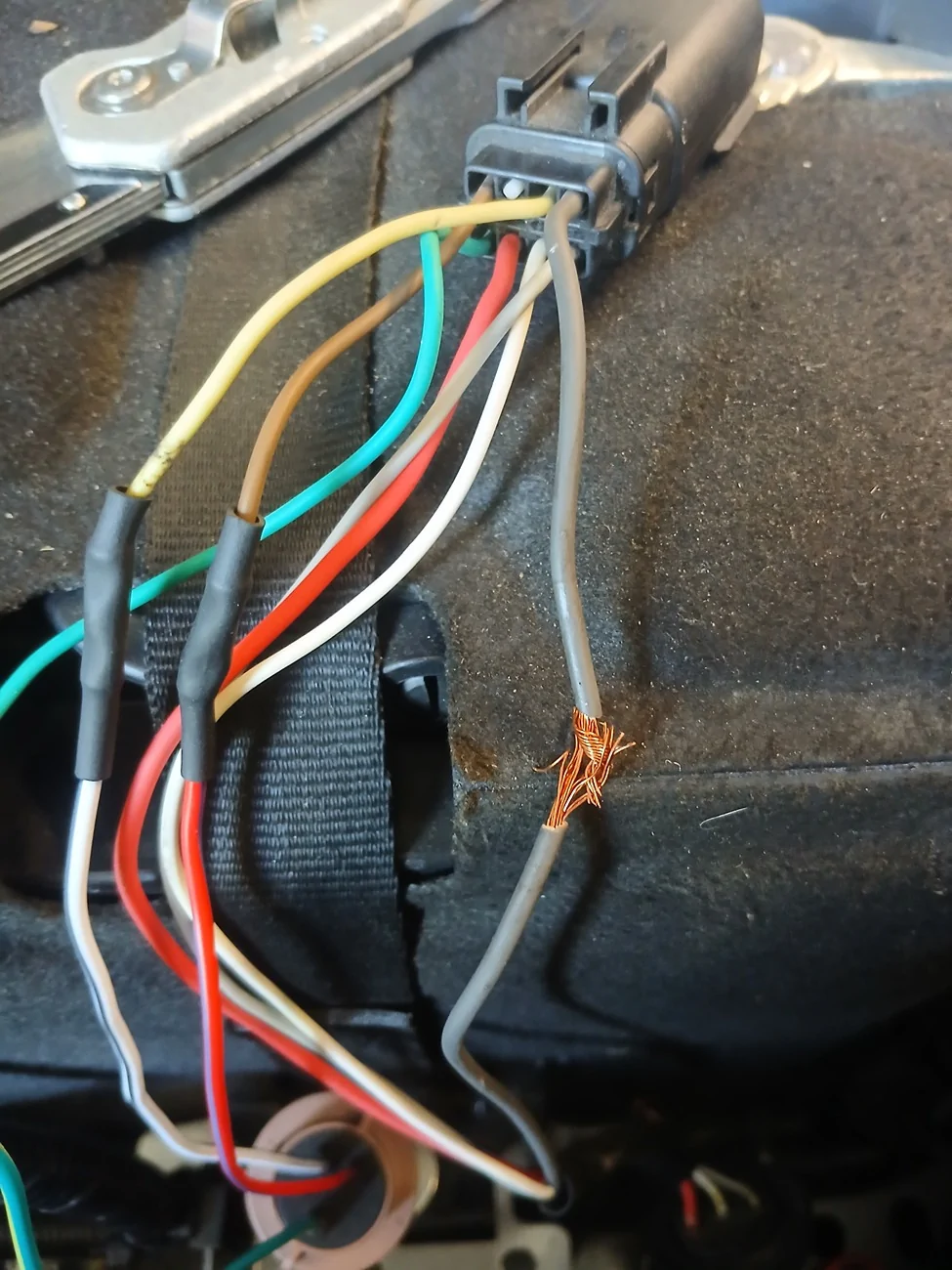

Upon further inspection, I saw where the technician cut a Grey wire that doesn't even go to the socket .. another crappy splice that i tried to do better and at least crimp and heat shrink ...
Anyway, Im back on the road !!!
Just need my grille lights back now...

I can CONFIRM you have it wired correctly but I would hit the heat shrink again to suck it up tighter on the wires (moisture intrusion)
To Clarify for others that may have this issue.
Red to Brown = Park Lights (Pin #5) Connector
White/Blue to Yellow (ish) Amber = Turn Signal (Pin #7) Connector
Green/White to Green = Ground (Pin #1) Connector
Pin #1 = Park/Turn Ground
The Grey wire that they (Cut) is Pin #8, note pin #8 is only on the Halogen Assemblies and not on the LED's - it will have a blanking plug, just like Pin #6 has in this pic.
Pin #6 is for Led Assemblies (only) DRL Power for the Led Strip
Pin #8 = Low & High = Headlight Ground (Halogen)
Pin #4 Directly below it = Headlight Ground (LED)
These 2 wires splice together in the main truck harness
So YES they cut a wire that they did not need to.

GOOD JOB: :rockon:
Yeah that one didn't want to shrink up all the way for some reason 🤔 so I smeared some sealant around all the ends and may tape it also... if things go south again , I'll just switch out the headlights to led , kinda want those anyway ...

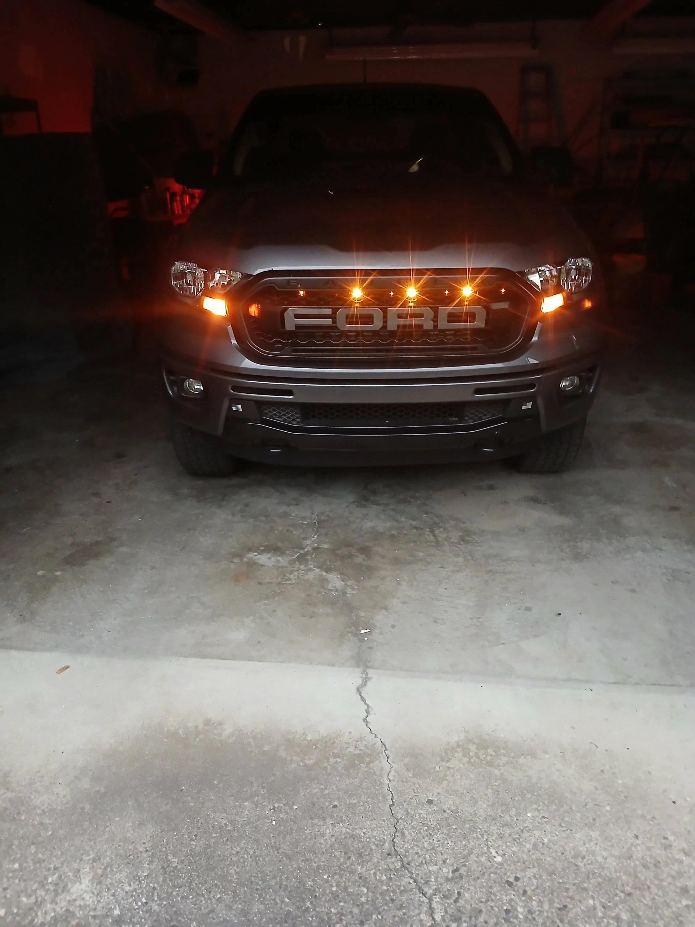

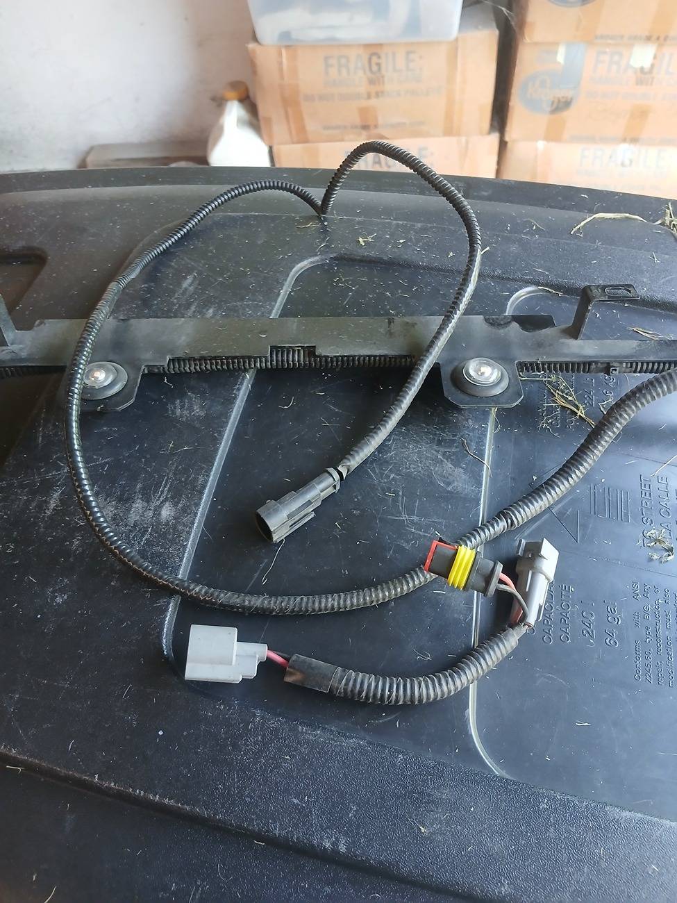

Now , on to the grille lights !
Wiring looks good all the way to it but it must be loose inside... if I could find one just like it, I could replace, but those numbers bring up all kinds of different ones and now my head hurts !

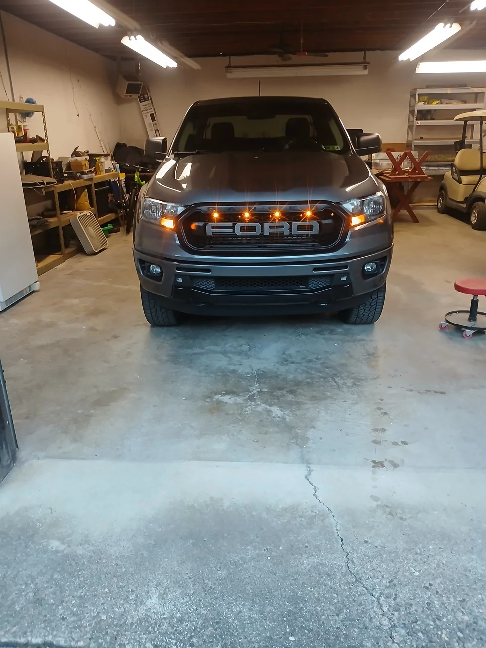

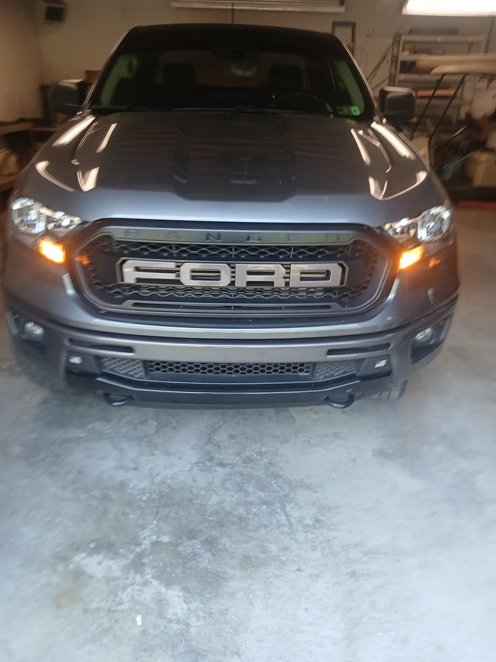

Im back baby !!!
Shout out to all that helped and special shout out to Custom Auto Works ! He found me in the system and sent out a new harness with ALL the lights ✨️ 😍 😎
Damn , 4 little leds make a big difference, love those little guys...
