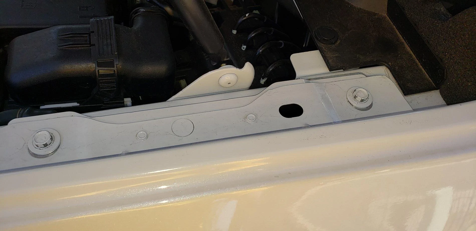

I pulled mine out as far as they can go and retightened, it's much better now.

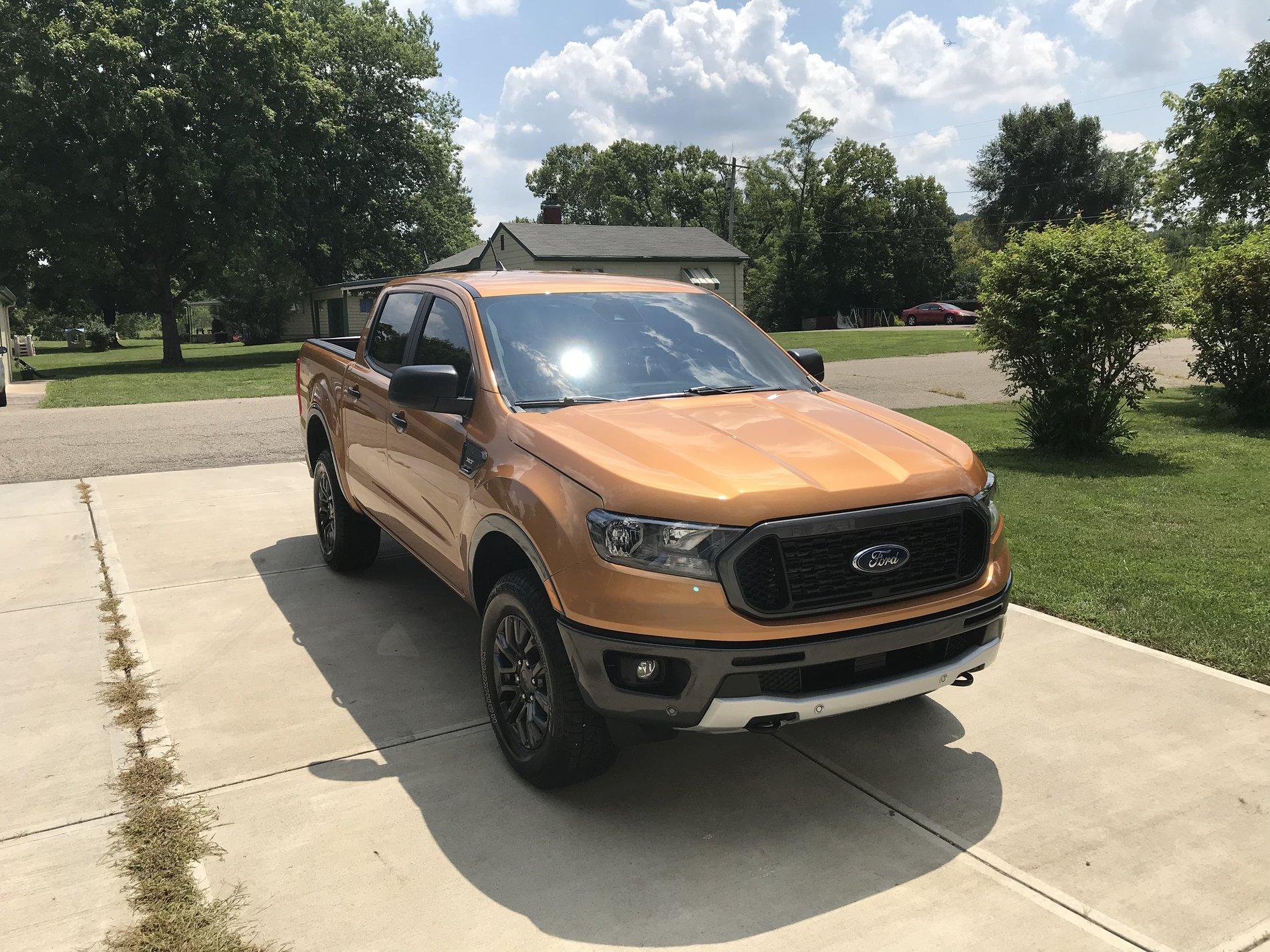

This is the best pic I have showing previous panel alignment. I’m terrible about taking pics so I don’t have any after I straightened out, I’ll try to snap one this weekend after Ranger gets a bath.
Pulled out both fenders fully to inner edge of bolt slots, luckily for me no need to enlarge as some others have
