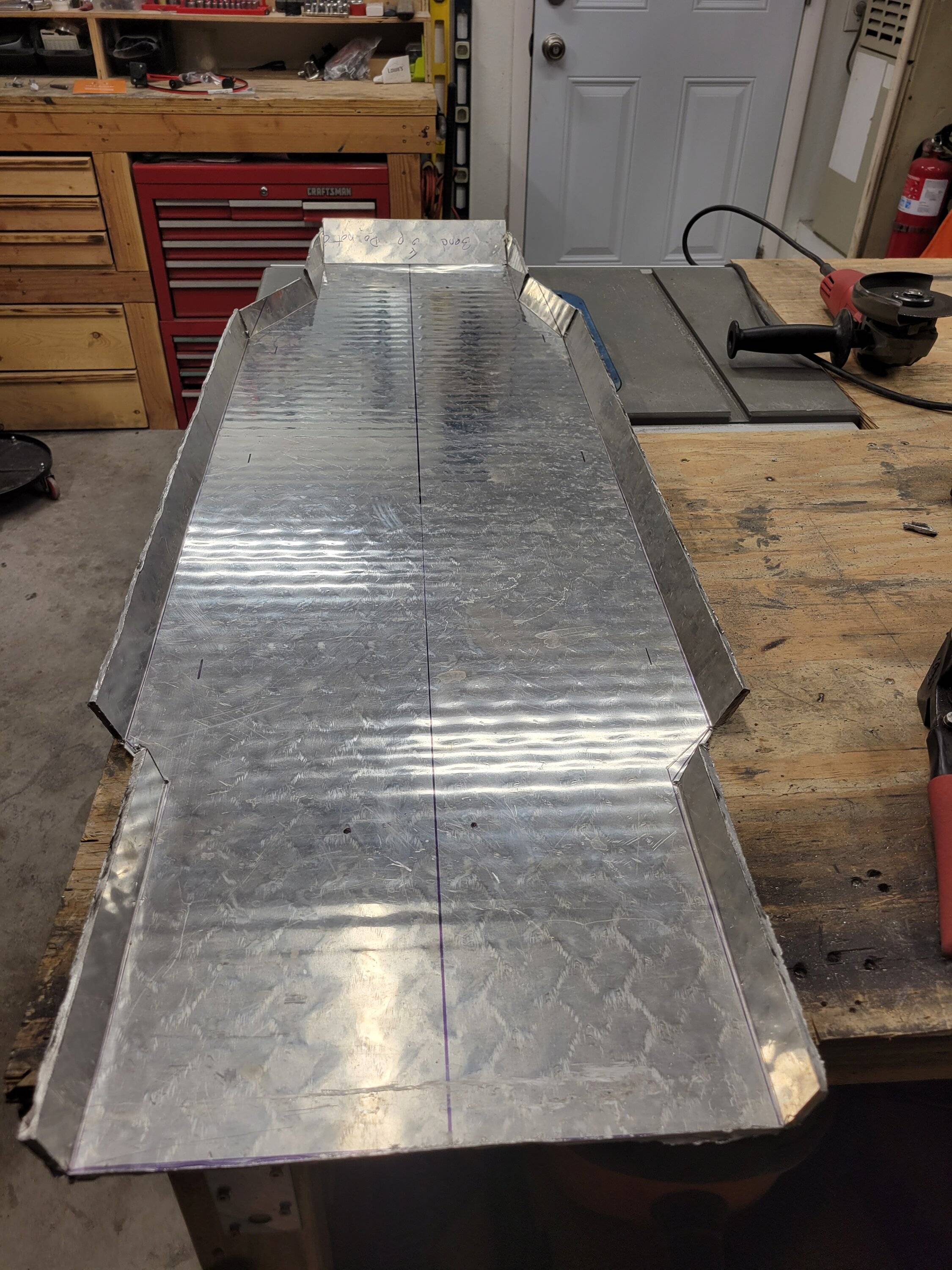

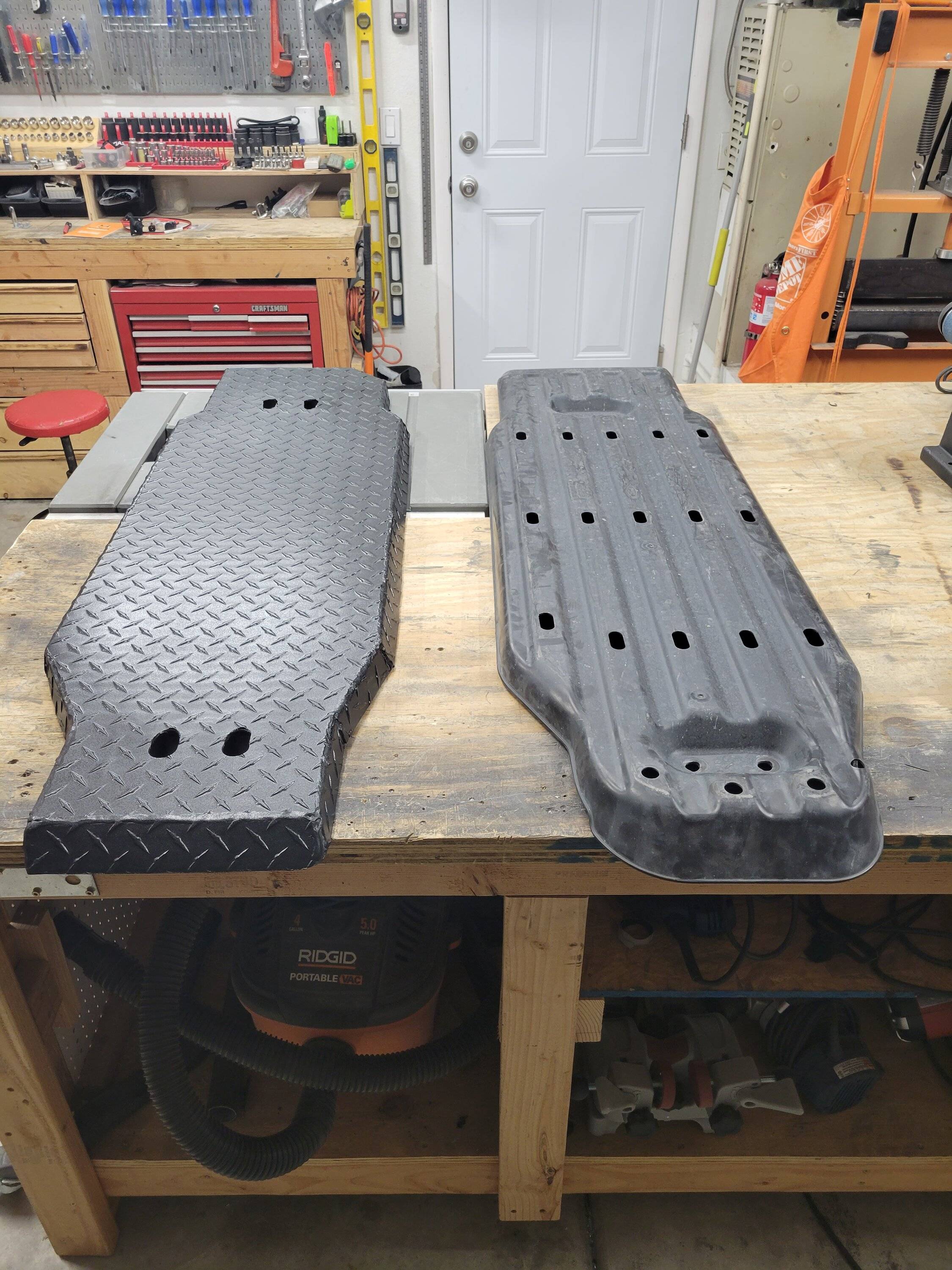

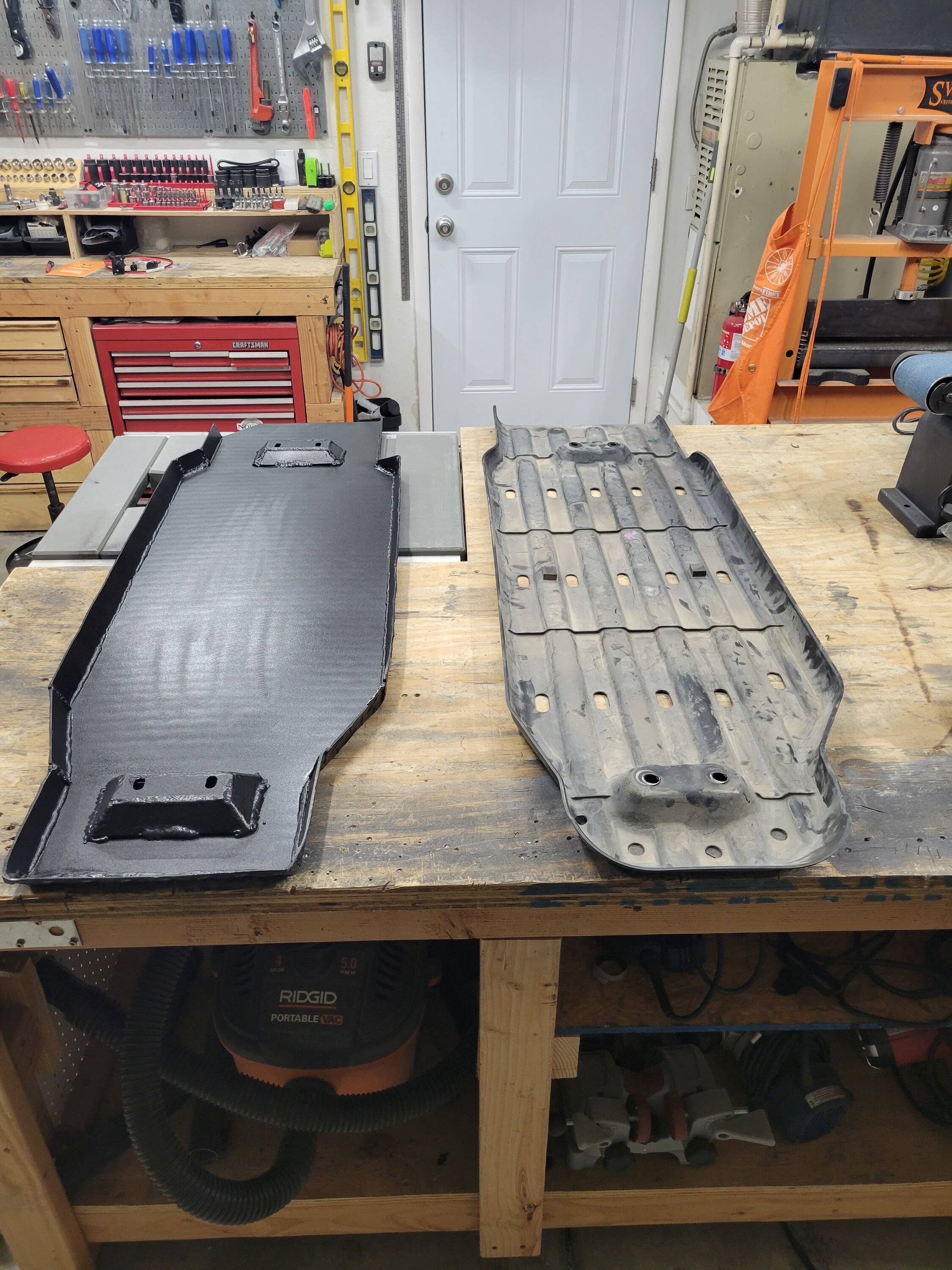

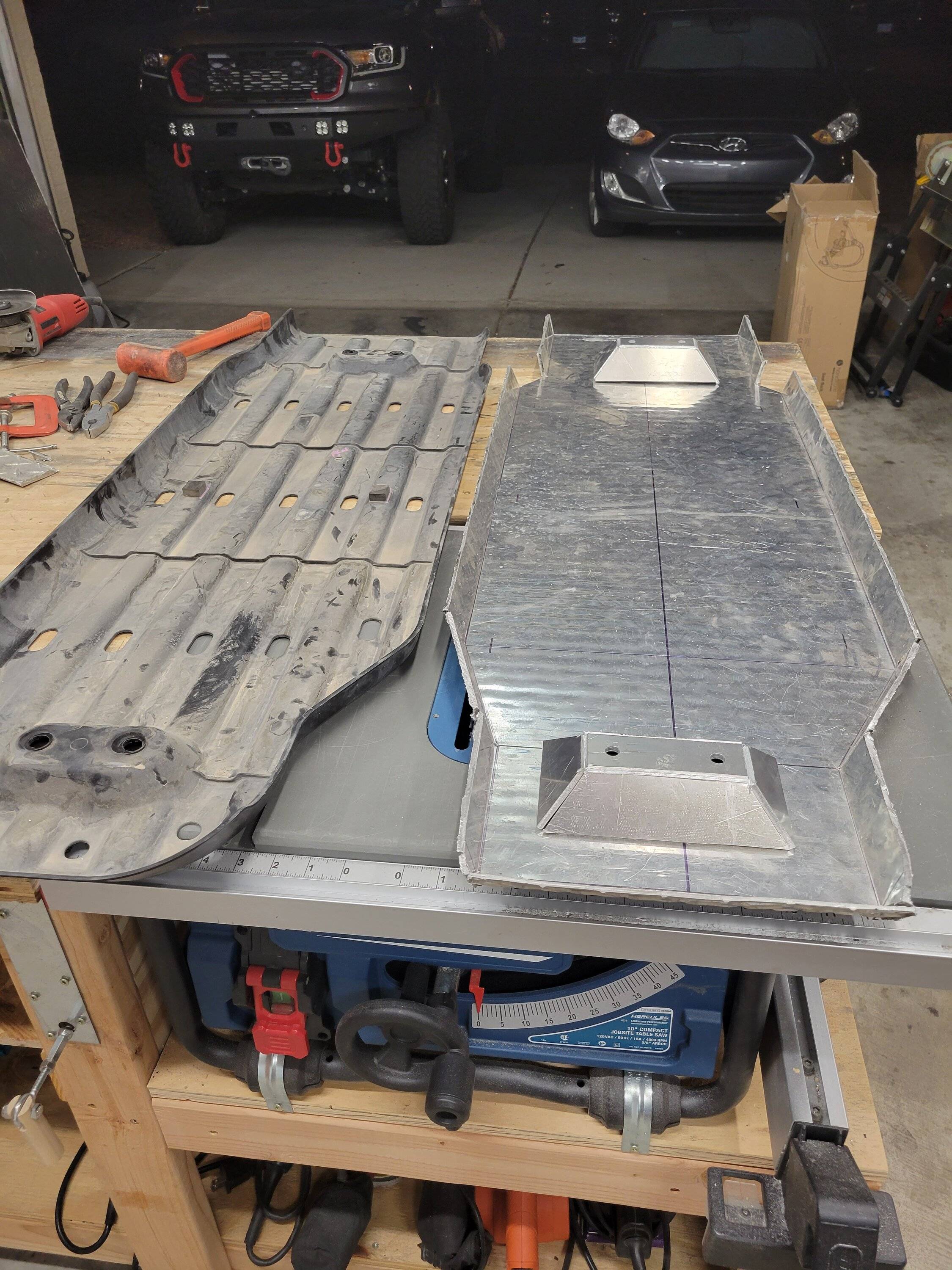

Since there are none out there on the market I just made my own.
I had a large sheet of .120 diamond plate laying around, a miller spool gun for aluminum not doing anything lately and a week off from work (staycation).
Took a couple days and used my plastic skid plate as the template.

Where the gas tank is located on these trucks the likelihood of hitting the tank is low. The tank is above the frame rails, you'll most likely smack the frame first. Do you need to go spending your hard earned money on one, probably not.
I did it because, I had the materials laying around, I have the skills to build it, I was bored, and it was fun.
Side note I came from building rock crawlers so it's just in my nature to armor everything. I'll be chopping up the rear end soon to build a high clearance rear bumper.
You do you and just have fun

That looks awesome! Do you think it needs a couple more drain vents? Do you foresee a lot of water (or even mud) being trapped in it from off-roading?
I live in the desert, all I got is rocks and dirt around me. If I was in a wetter area I would have thrown some extra drainage in. If I do get any water in there it's just going to roll out the back when you hit the throttle, it's not boxed in.
