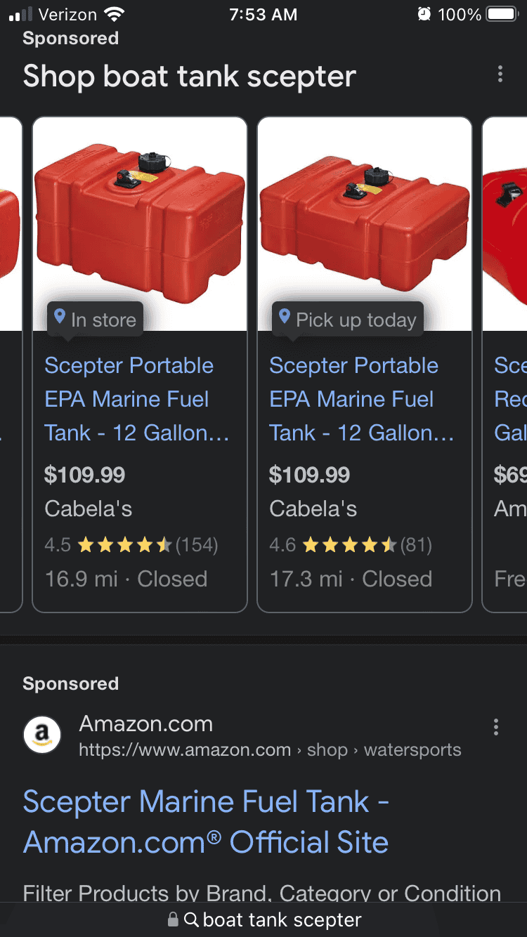

Wouldn't a proper fuel cell have ventilation?
yes they should. but the diesel fuel cells are not vented enough for gas use. most of the diesel tanks ive seen on farm trucks and ag stuff have something like this.
the problem is hot gasoline actually changes in volume and the amount of space used in the tank. so in really hot weather your tank will be more full vs. really cold weather it be less full no matter if you added or removed gas. so the tank structure needs to be much stronger and have more venting in a gas setup. diesel can also expand but not like what gasoline does. basically saying the gasoline makes higher stress on tank due to expansion so tougher tank needed and extra ventilation.

If these are safe for boats I don’t know why they wouldn’t work in a truck. Might be kinda slow to fill your tank though even with an electric pump.

So all the big "diesel only" in bed fuel tanks for sale... can they really not handle the chemicals of gasoline, or is it more of a federal government nanny state thing because "diesel is not as combustible"?
Also from my understanding, and my numbers may be slightly off, I can transport up to 139 gallons of gas without permits or placards?
What is stopping me from buying a 50 gallon (300lb) in bed fuel cell and using gasoline in it?
I added a 40 gallon in my diesel truck, there are DOT approved that are "required" to be legally plumbed into the vehicle. Non DOT are only supposed to be used for refueling tractors etc. I am currently adding a fuel cell (13 gallon ) that will pump into my tank, and will be vented to the tank as well to keep the evap system functioning. Will be mounted in a tool box behind the cab, details to follow when I complete.
