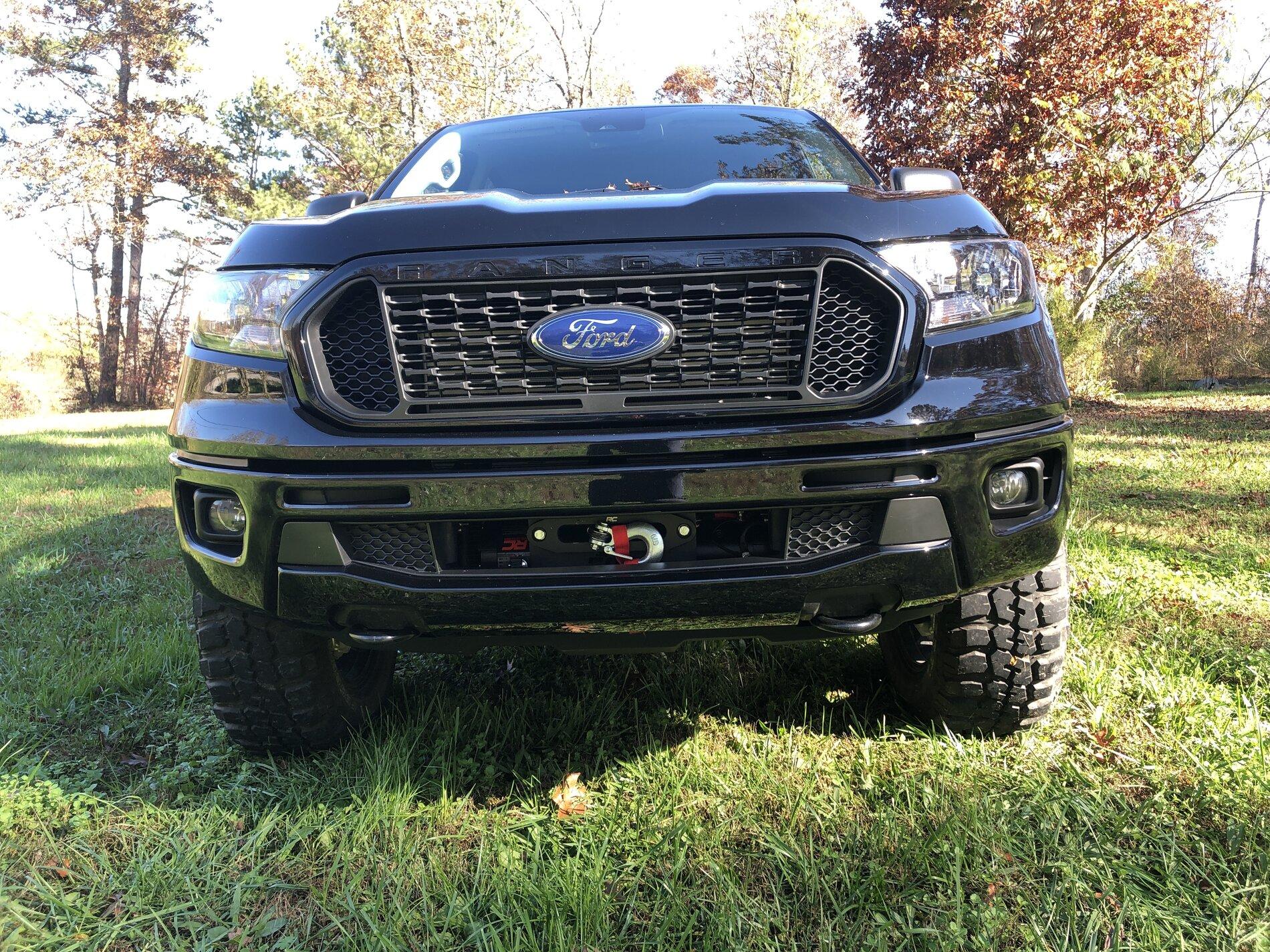

I think the 589 Fab winch mount is an awesome idea, but, it looks as if I'd end up mounting a Warn winch upside down (with the control pack facing downwards). How would you get in there to attach the remote control with the skid plate and all in the way. Is it accessible?

The control pack is relocateable on most winches, and you get a keyfob add-on which can be gotten for just about any make/model of winch.

It's mounted sideways. It comes with a bracket to mount the control box in front of the battery. You can see on my build thread how I did mine. I mounted it behind the driver side fog light. The battery area was already too crowded.

How much weight is added to the front end of the truck with the mounting bracket/winch combo??

I have all my stuff sitting here while I wait to install so I weighed it. Rough Country 9500 synthetic line + 589 Fab brackets = 92lbs.

My problem is I have the ACC in the space I need lol and my family who works at the Dearborn testing site say don't move the ACC or itll throw codes. Thanks for the weight check.

Multiple people here have relocated the ACC without any issue. There are several different brackets out there, or you could make your own. You shouldnt have any codes.

No noticeable difference, 88 lbs, modified the stock acc bracket and moved in the middle of the grille. Seems fine
