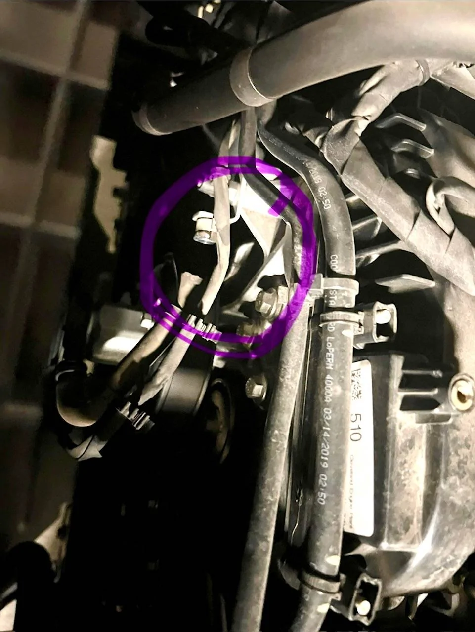

Just drove from Los Angeles to Salt Lake City had to get an oil change done and popped the hood to check the dealerships work and noticed this broken hose. Runs from the fan to a sensor directly in front of the engine. Truck is a 2019 Ranger XL has a check engine light but thats because of a bad dpfe sensor ive been putting off fixing. No driving issues from Los Angeles to Salt Lake and no new codes.

Yes - ref the other threads - the hose is not sold separately, it’s part of the clutch assy.
Replace with 3/8 Fuel Injection Hose - and worm clamps.
Get as close to the OE, resting position as possible when finished.
