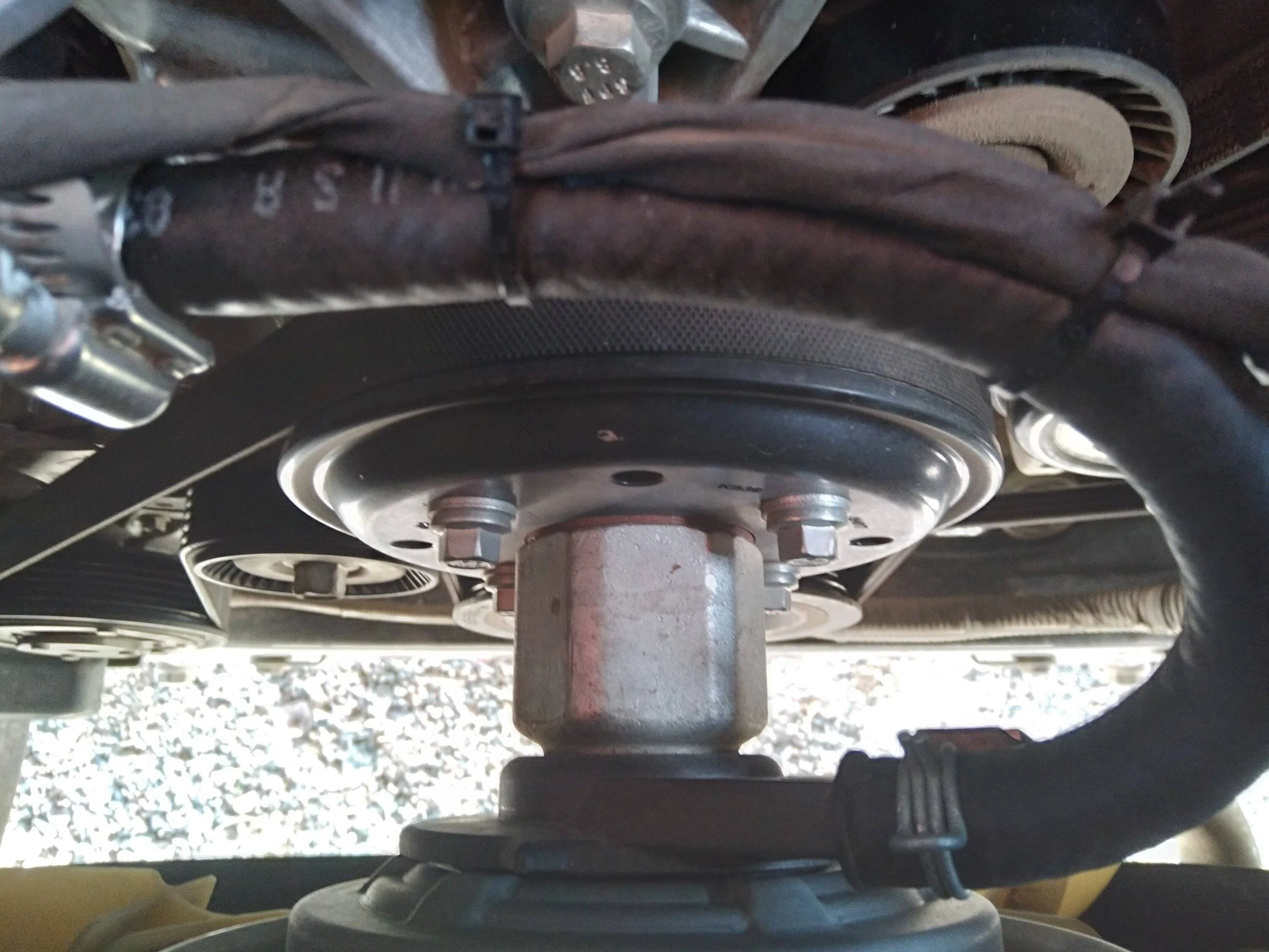

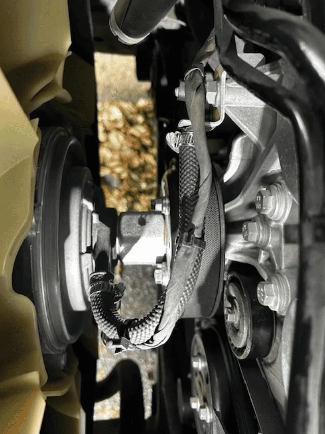

Not my Ranger but Daughter's future husbands that I fixed.
I do not know how long the hose was broken, I just hit my spare hose box and fixed it.
I did confirm its 3/8 HP Fuel Injection Hose, its stiff to keep the contour.
With my miles, I better do this mod...where can I get this type of hose and other types of hose you might suggest? Thanks!

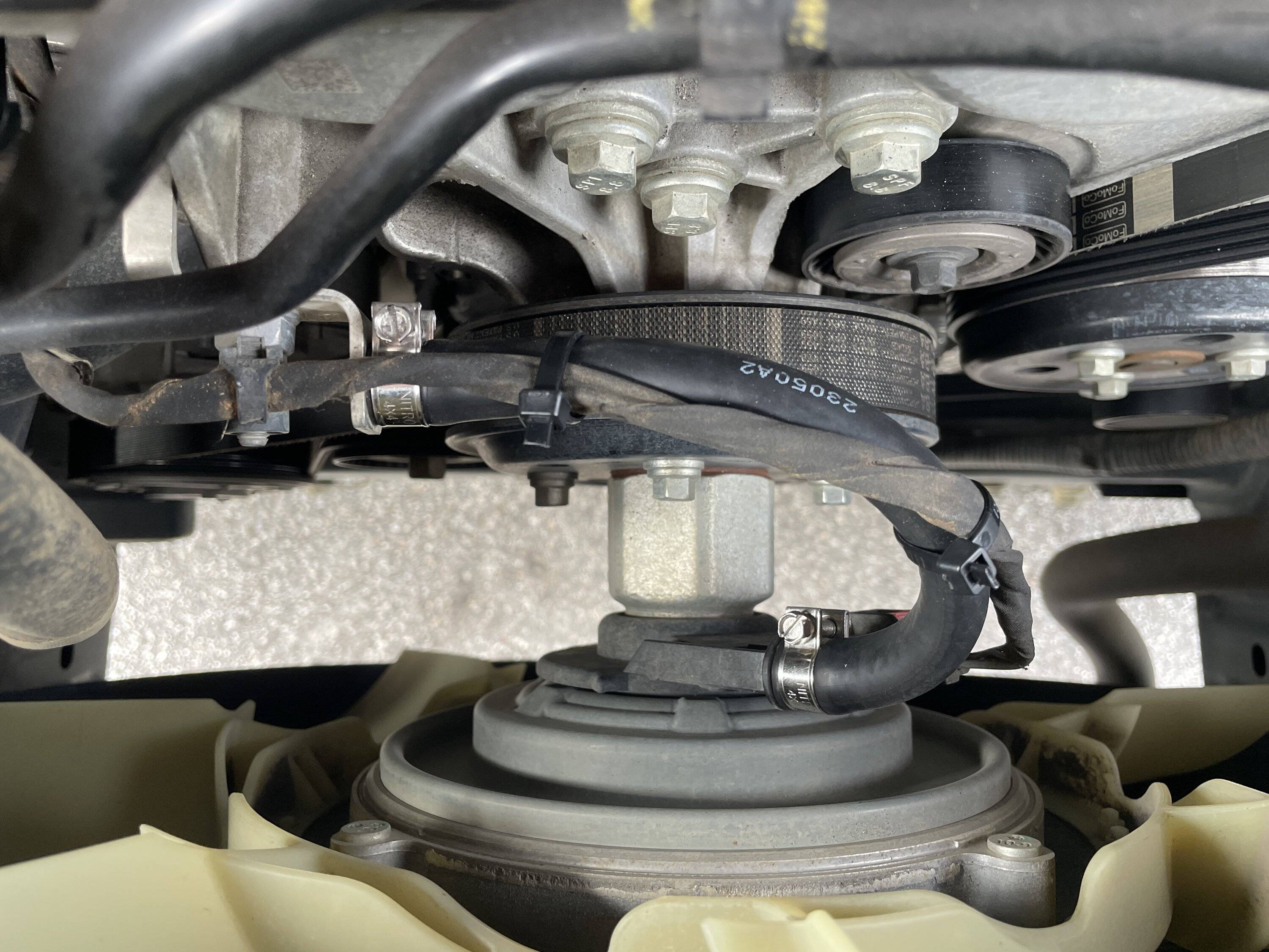

Got some 3/8in fuel line from Autozone. Took about 20min. I disconnected the battery, didn't want skynet deciding if I got to keep my fingers or not.

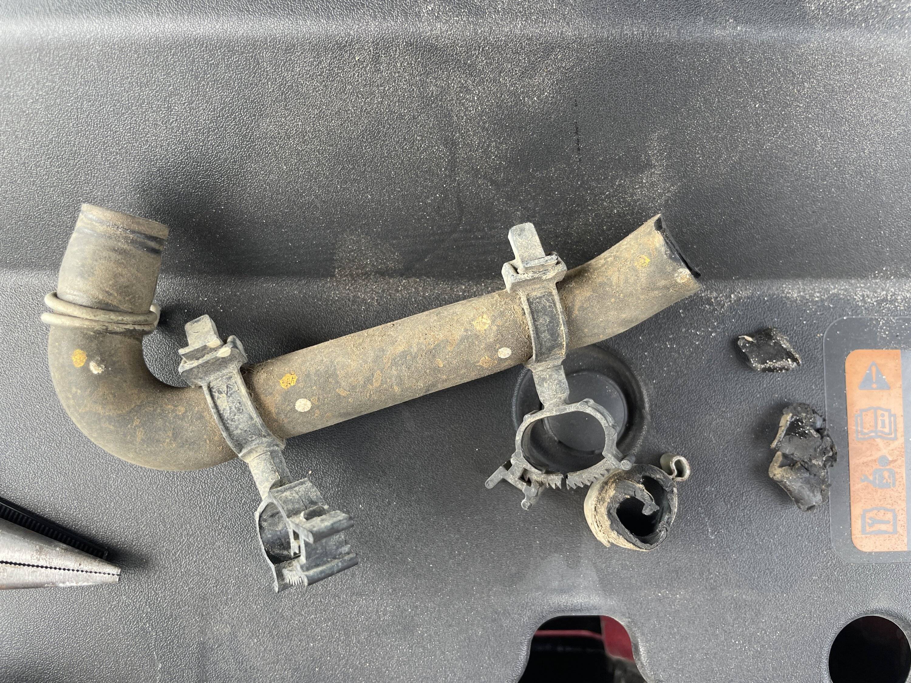

The old leftover carnage, it fell apart in my fingers as I tried to pull it off.
