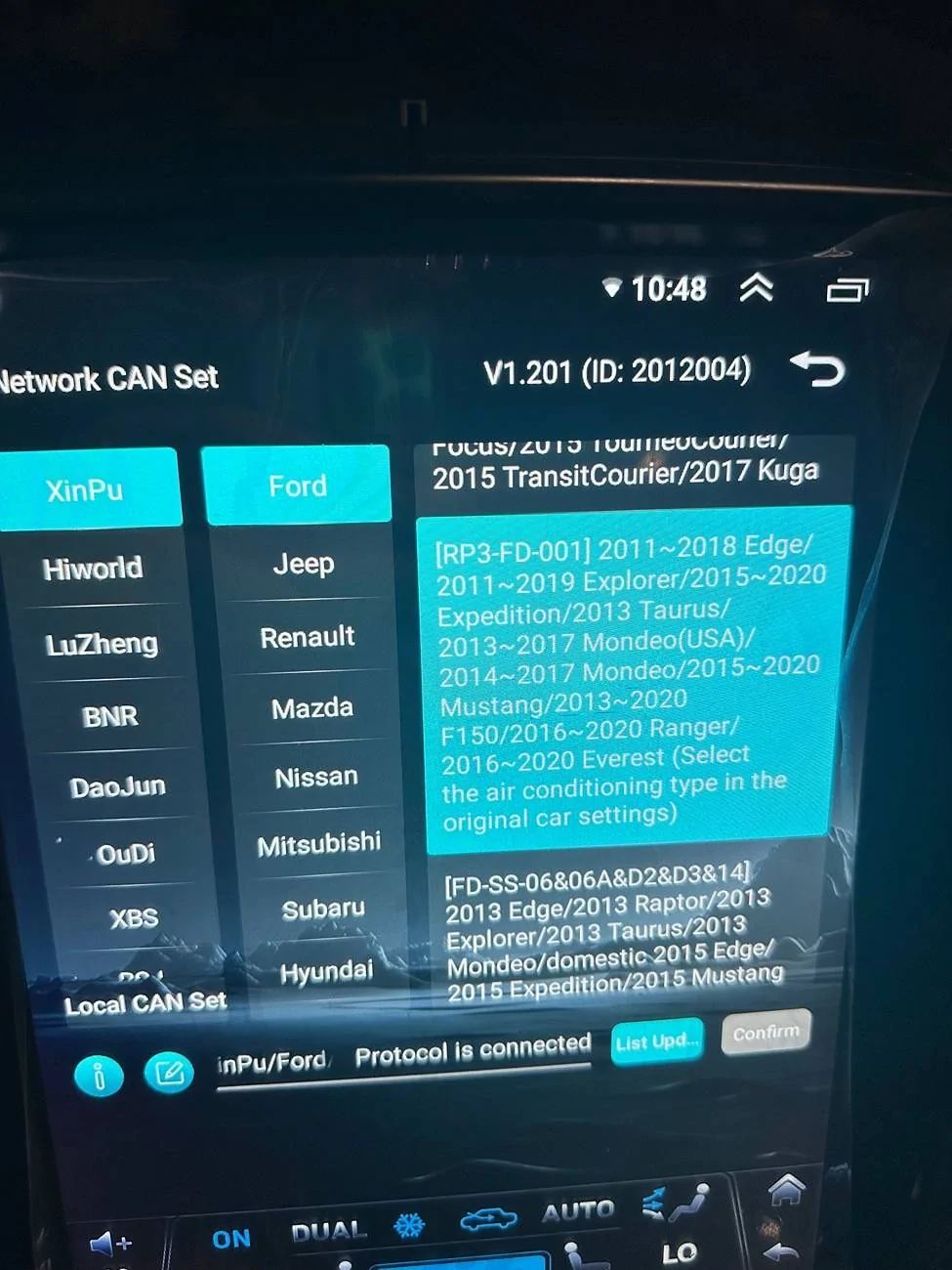

I personally think another part of the issue aside from the ficm programming is the fact that your truck came equipped with a single zone a/c and your new head unit is dual which is not going to be a happy match.
Big Blue
Lee
May 5, 2020
3,940
9,399
Retired mechanical designer
I would hope that the new head unit had programming for both. Once he gets it communicating with the truck over Canbus it should pick the correct display.
@airline tech is correct, any module/device communicating over Canbus needs to be programmed with the vehicles VIN#. There are also settings in Forscan for signal or dual A/C type which will be picked up once communication is established.

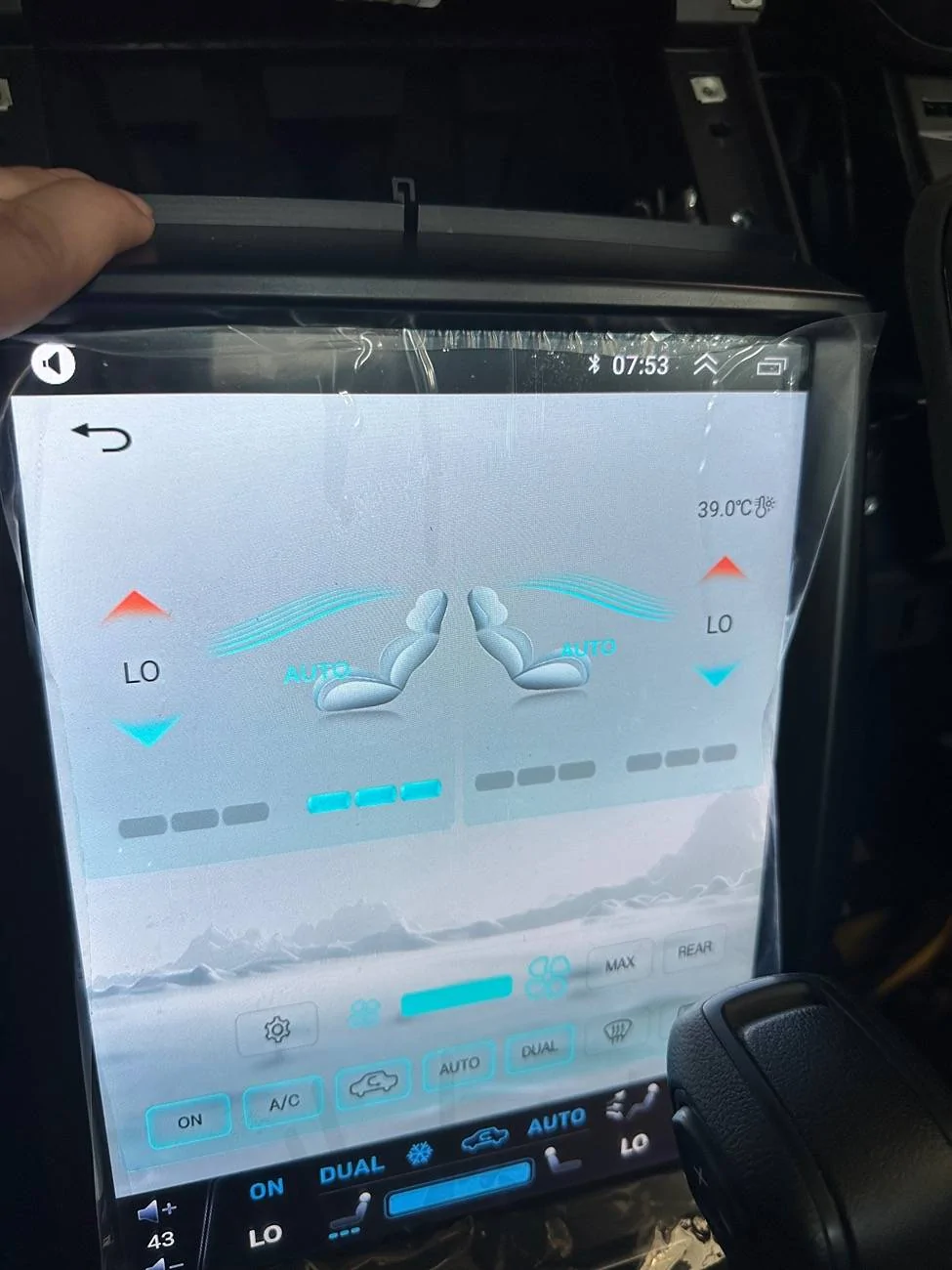

i got Forscan and the usb adapter that the forscan.org recommends and now I get an “FCIM: Unable to read DTC” error when I connect and I have the aftermarket radio installed. Do you know if there’s any way around this or is this module just doomed?

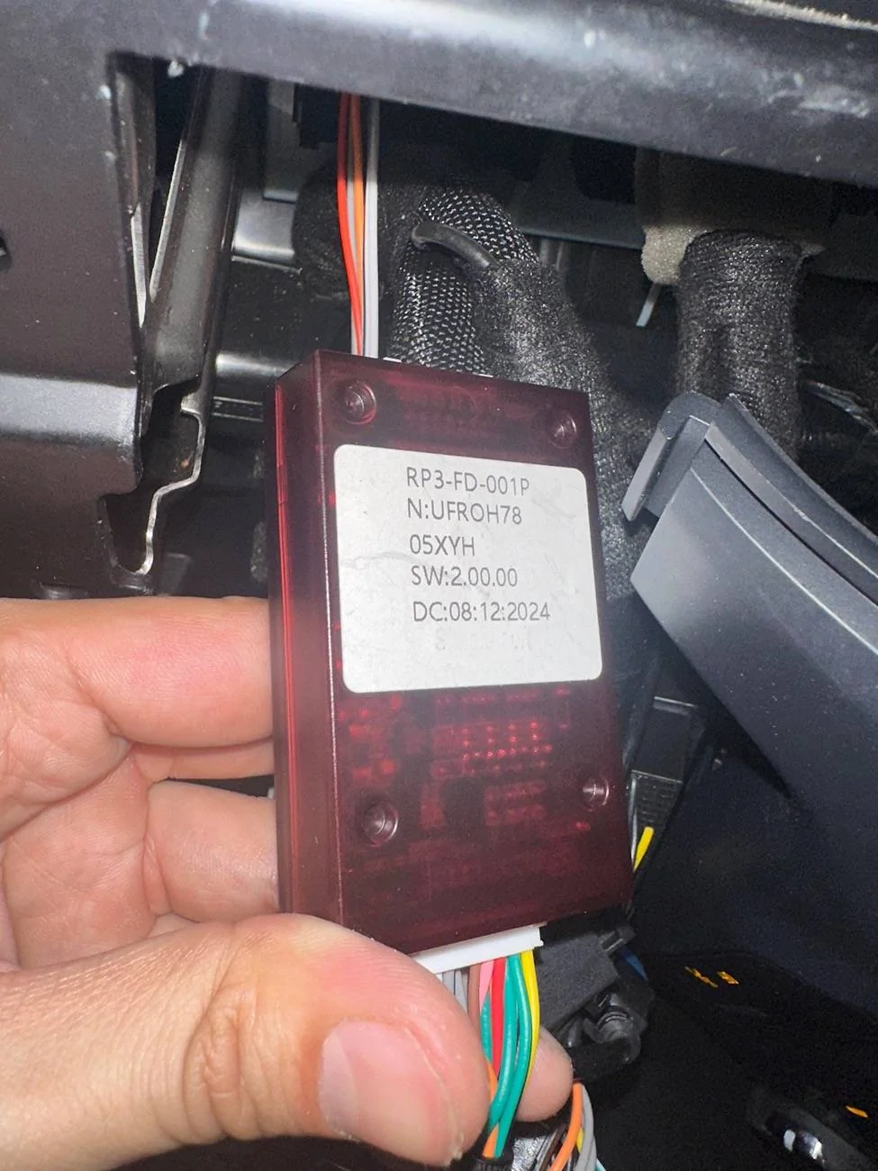

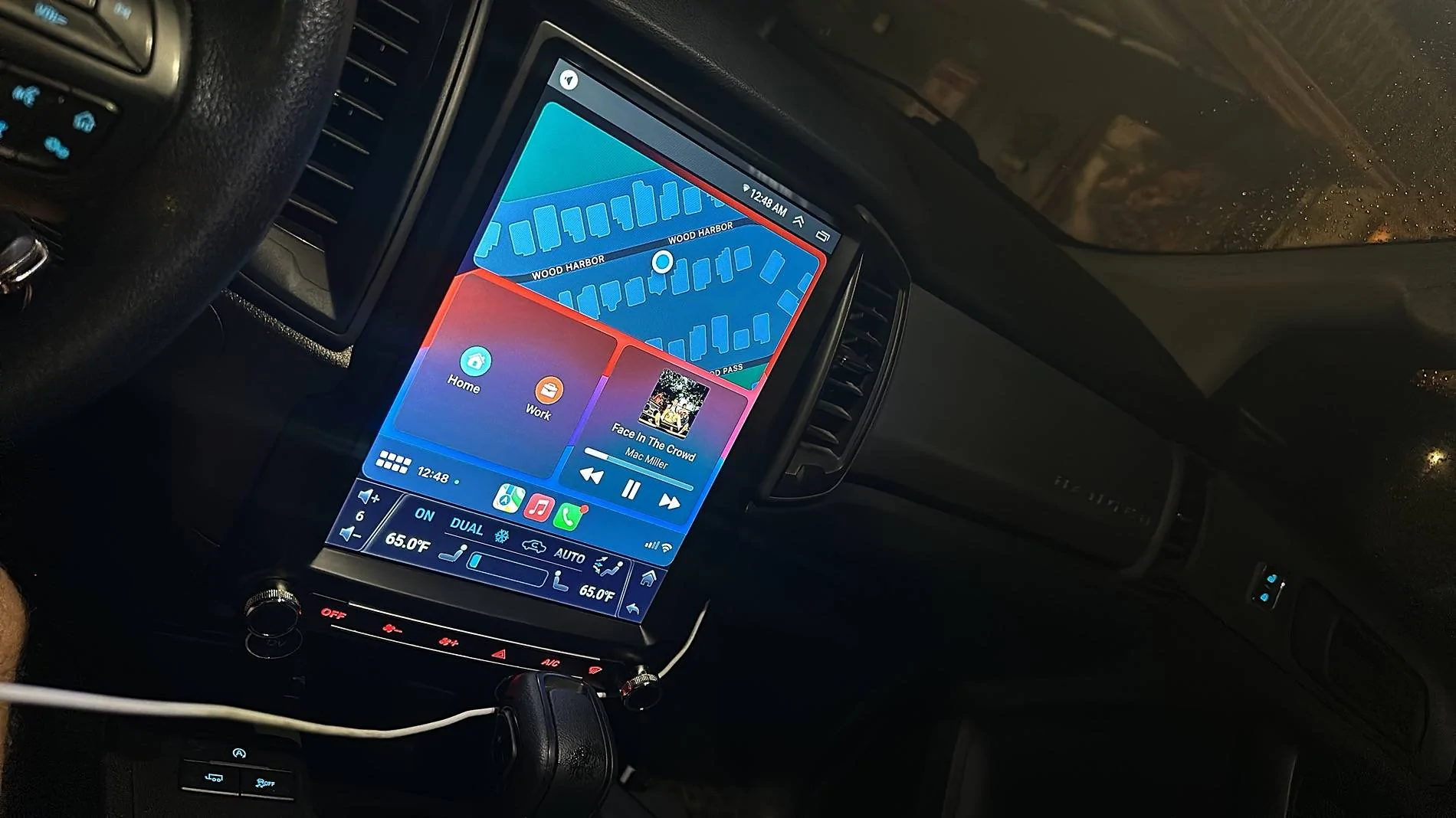

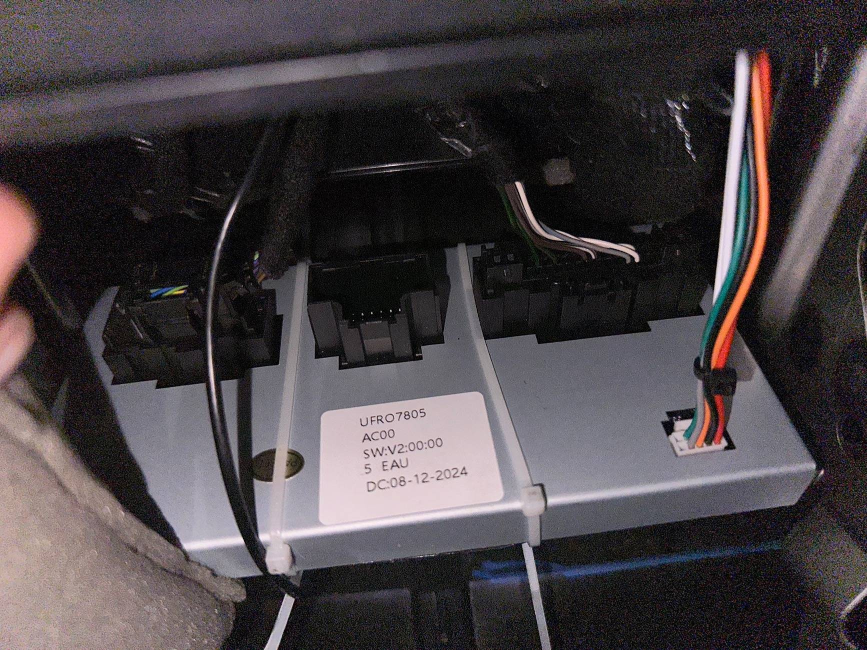

thank you all it turns out they sent me a the European climate control module :/. The AliExpress seller put me in touch with a technical team and and that was the conclusion. Luckily the only change to make it the North American module was to move a resistor on the board to a different location. Took me like 5 min and got everything working now. I attached a picture to show how cool it looks haha

Glad you got it worked out! please keep us posted on how you like it and any issues you discover. Also what vendor did you get it from? it sounds like the support was very good consiering you are dealing with China.
