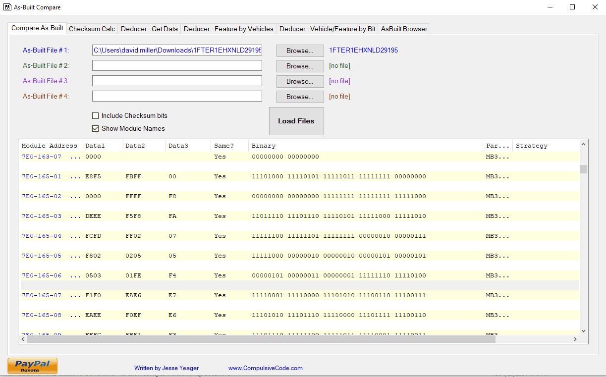

Update: ooh, found this thing: https://www.compulsivecode.com/Project_AsBuiltCompare.aspx
That gives me this (but I dunno what to do with it ...):

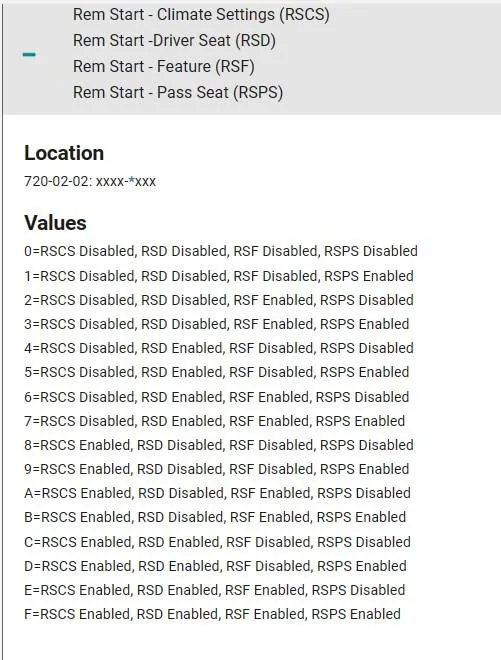

if you download it saves as a Ab File, however if you print the viewed page as PDF and save it , makes it readable.
The image I included is from the Cyanlabs page for the breakdown of the file.
I think that the possible difference (reason) for menus not being the same may be due to the Rear Window Heat.

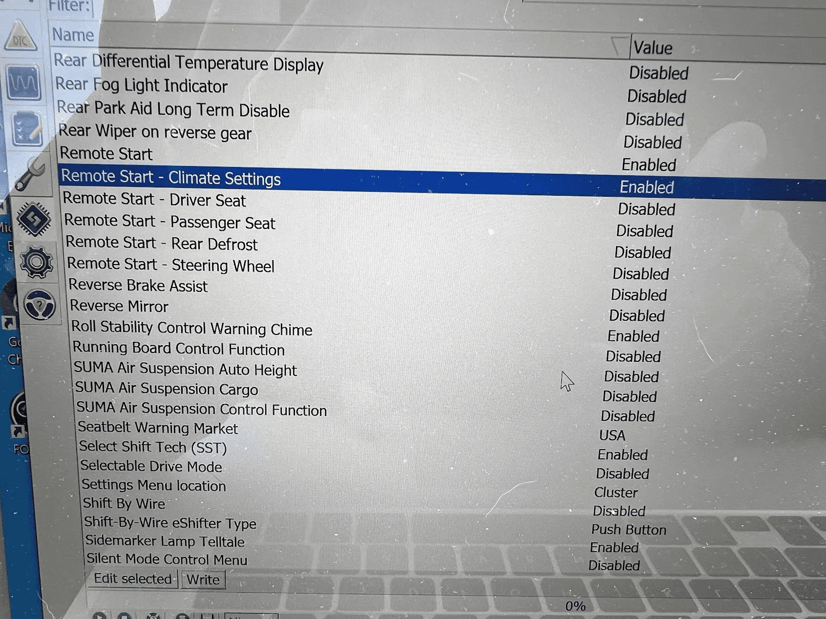

Following up here since my 2019 didn't have the "Climate Ctrl" option so I fired up Forscan and went into IPC. Here is what I found:
So I opened it up and set it to Enabled:

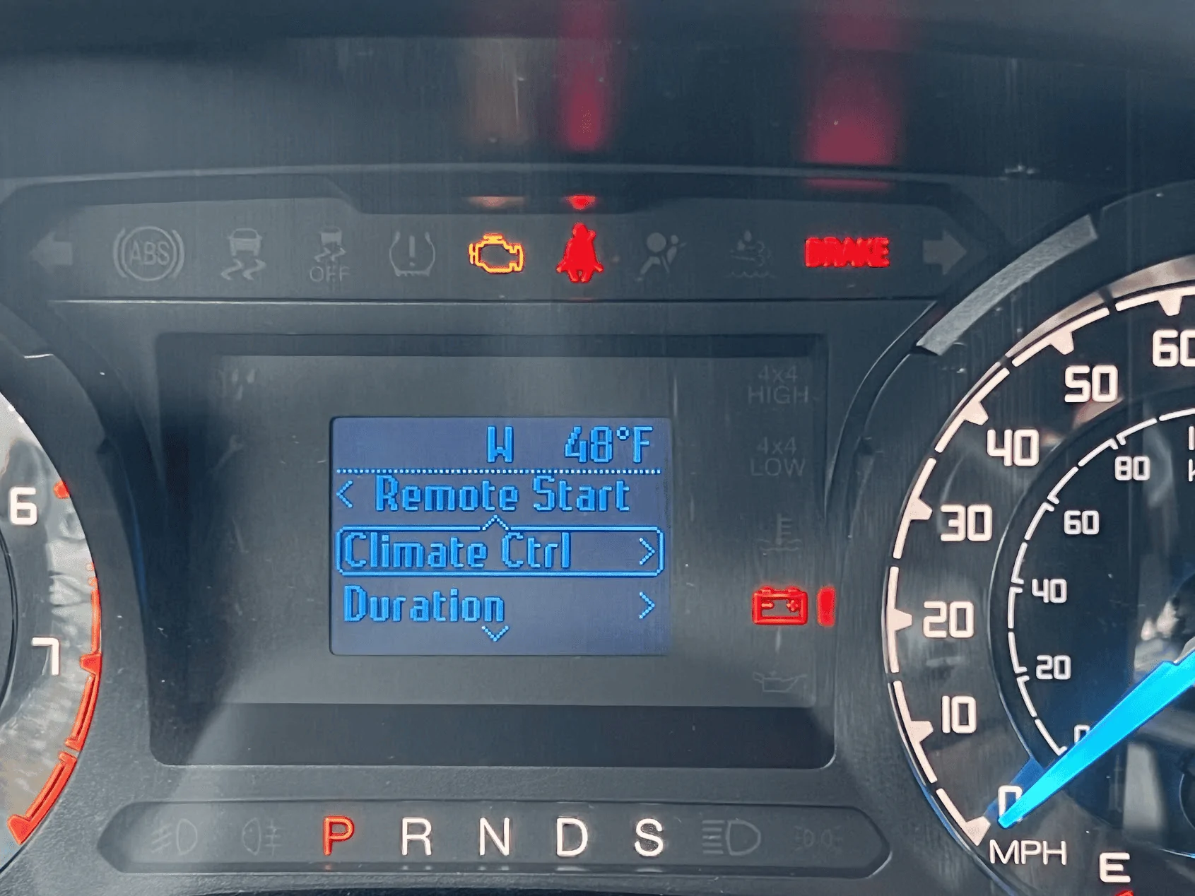

After that, I went back into the Truck Info -> Remote Start Menu and was greeted with:
So , no need to go into the Asbuilts you can do it from the regular menus. I didn't enable the Rear Defrost but I might go back and do that later. Question for those of you that have had this and used it. On Auto, what does it do? I would assume that if it's cold out it would turn on the heat and defrost likely full and it would include the Rear Defrost? And, if hot out, I assume it would turn the A/C on full too. Is that what you've all seen? If so, then I do like Auto.
