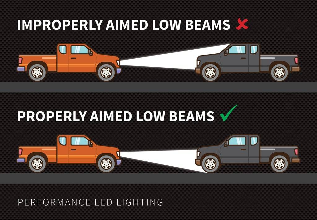

I believe it's been stated, but ultimately headlight low beam aiming is about angles. Because it's very difficult to put protractor or angle finder on a beam of light, we use length and height measurements and very basic trigonometry to set the correct angles.
At the absolute highest low beams should be parallel to a level horizon. Low beams should NEVER be angled upward. Nearly every source I've read states they should be on a slight downward angle.
The issue with using arbitrary measurements is that it does not take the height of the source of light into account. My Mustang low beams are centered about 24" off the ground. If I aim my headlights at 42" at any distance they will be at an upward angle. Using simple right triangle logic, this means as distance(b) away from my source of light increases so does the height(a). This makes it very likely that the cutoff of your low beams will be well above oncoming traffics line of sight.
TL/DR
A stupid simple way to aim your headlights, is grab whatever tool you need to adjust them. Go for a ride at night and lower them until people stop flashing. Then lower them a tad more for good measure and boom you're done. Not scientific, but it works.
