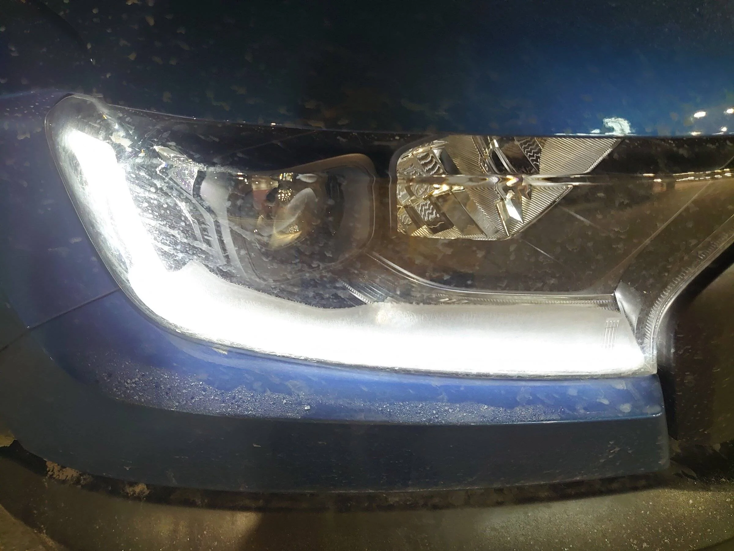

Thank god in EU the light adjustment is just a knob in the cabin.
Too bad they designed those in Australia and this is the result..
Yes, they're frozen inside. The LEDs barely keep out the ice from the top & middle and the ice cuts light to the bottom.. Was going to went about it on some thread, but luckily this one was about lights.
