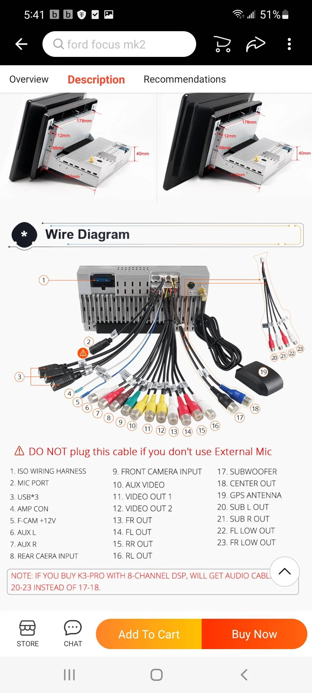

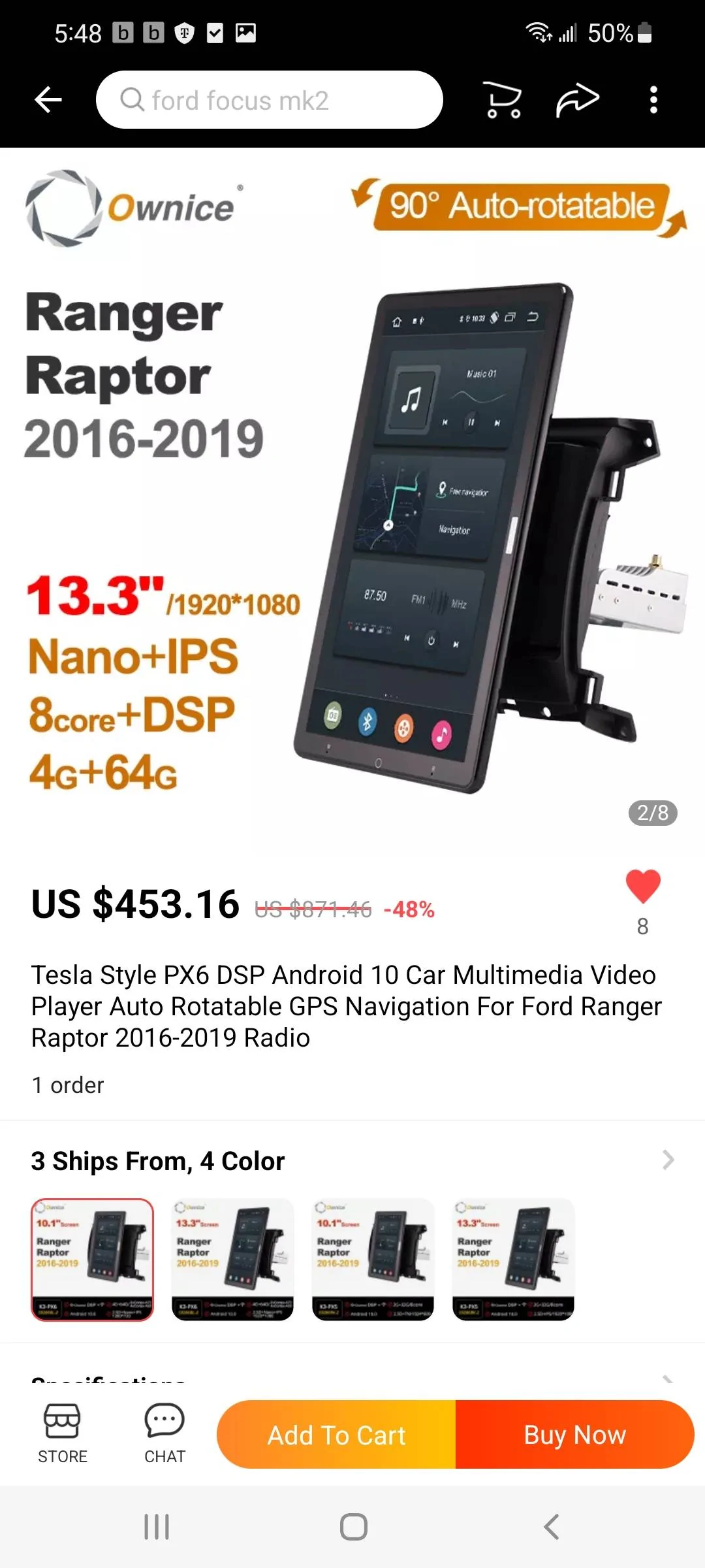

Came across this on aliexpress. If I gave it a gamble I would do the 10" version. The main reason it caught my eye is it comes ready for a front facing camera. Been wanting to setup a trail cam. All the interfaces I've researched would cost about the price of this. This would also add a little upgraded look.
My concerns are will it work properly with ford sync and B and O upgraded system.
Check out the pics and wiring it comes with and tell me your opinions.
Anyone familiar with this head unit?

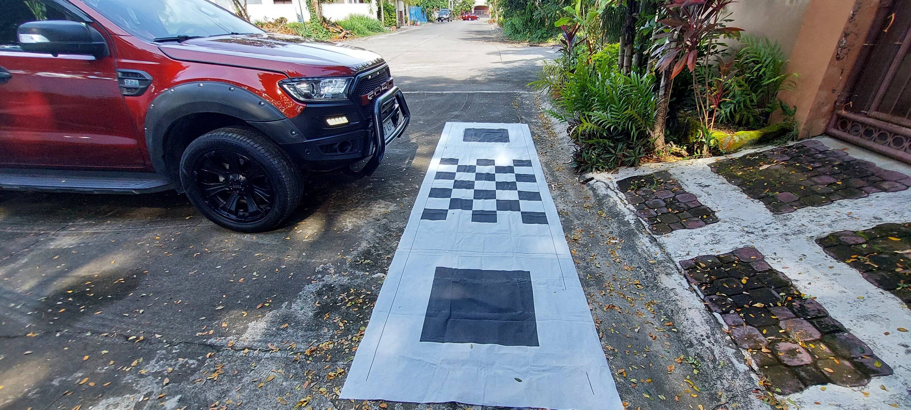

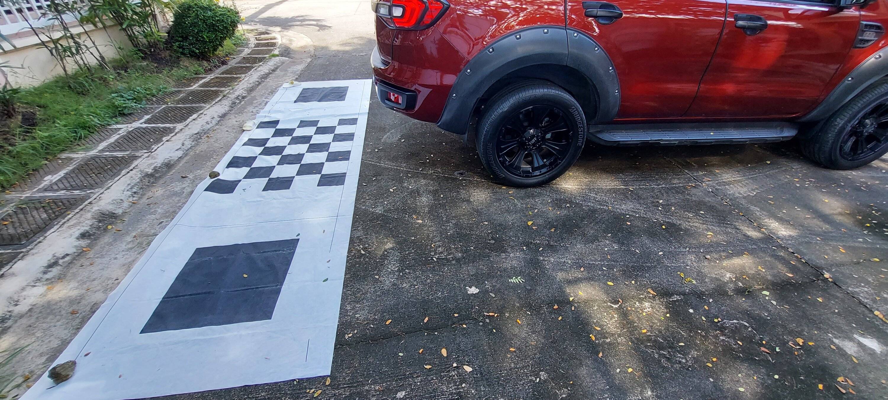

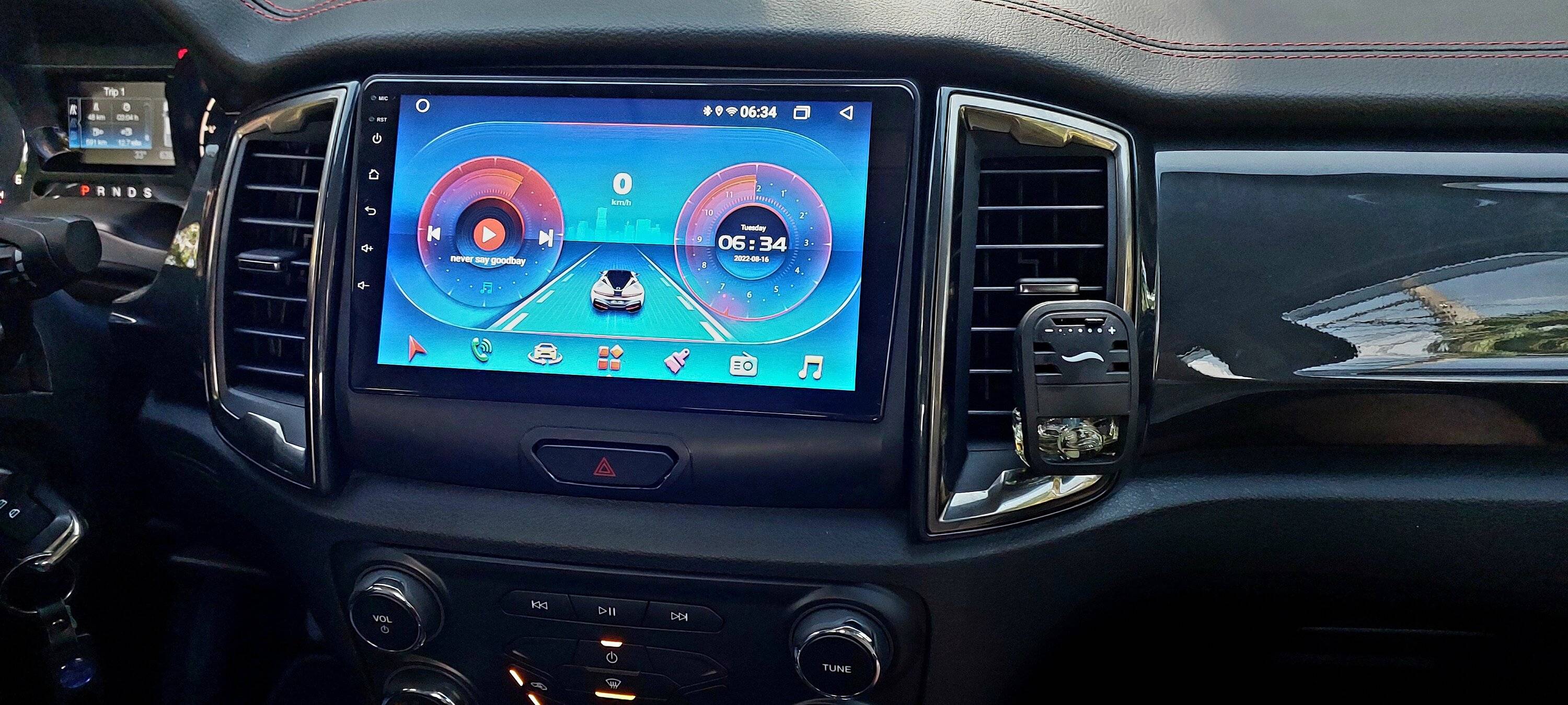

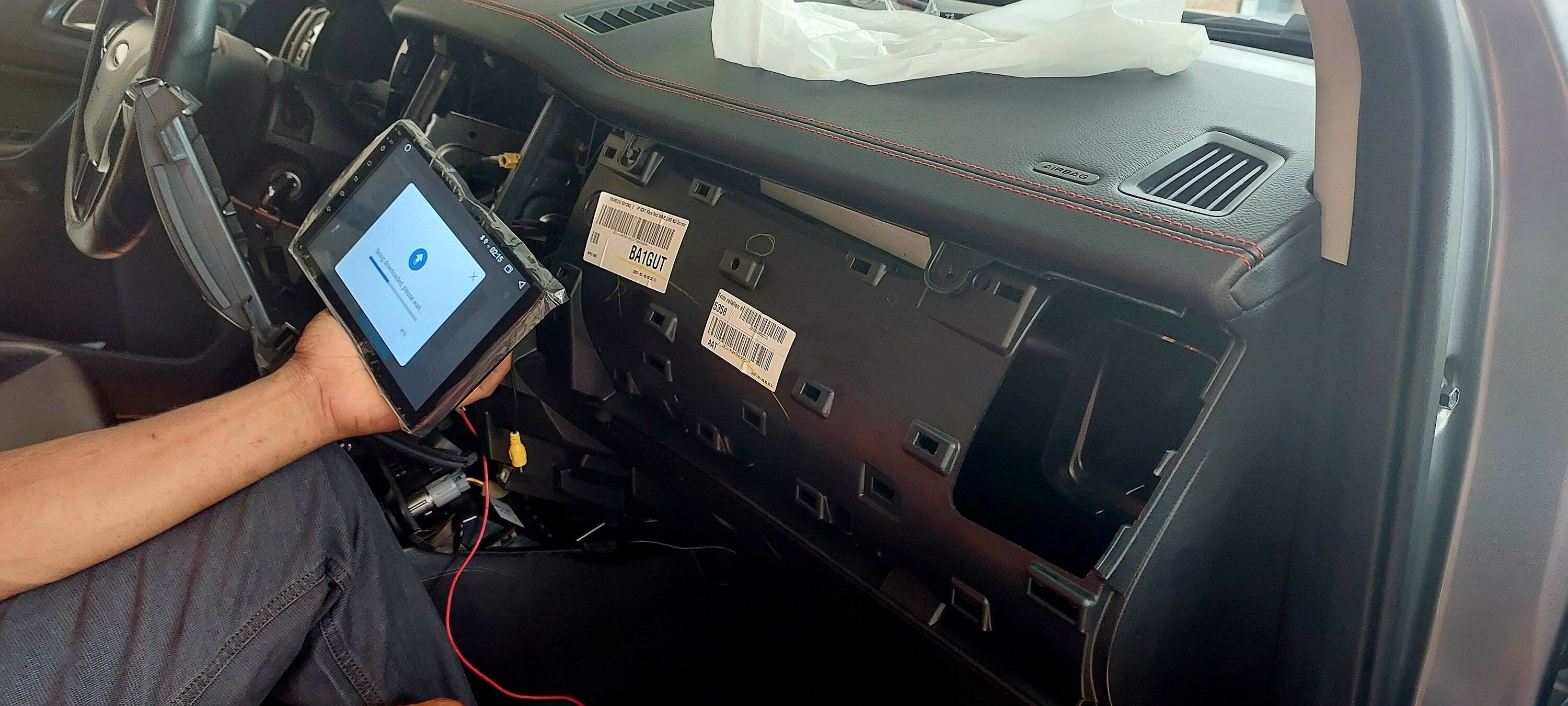

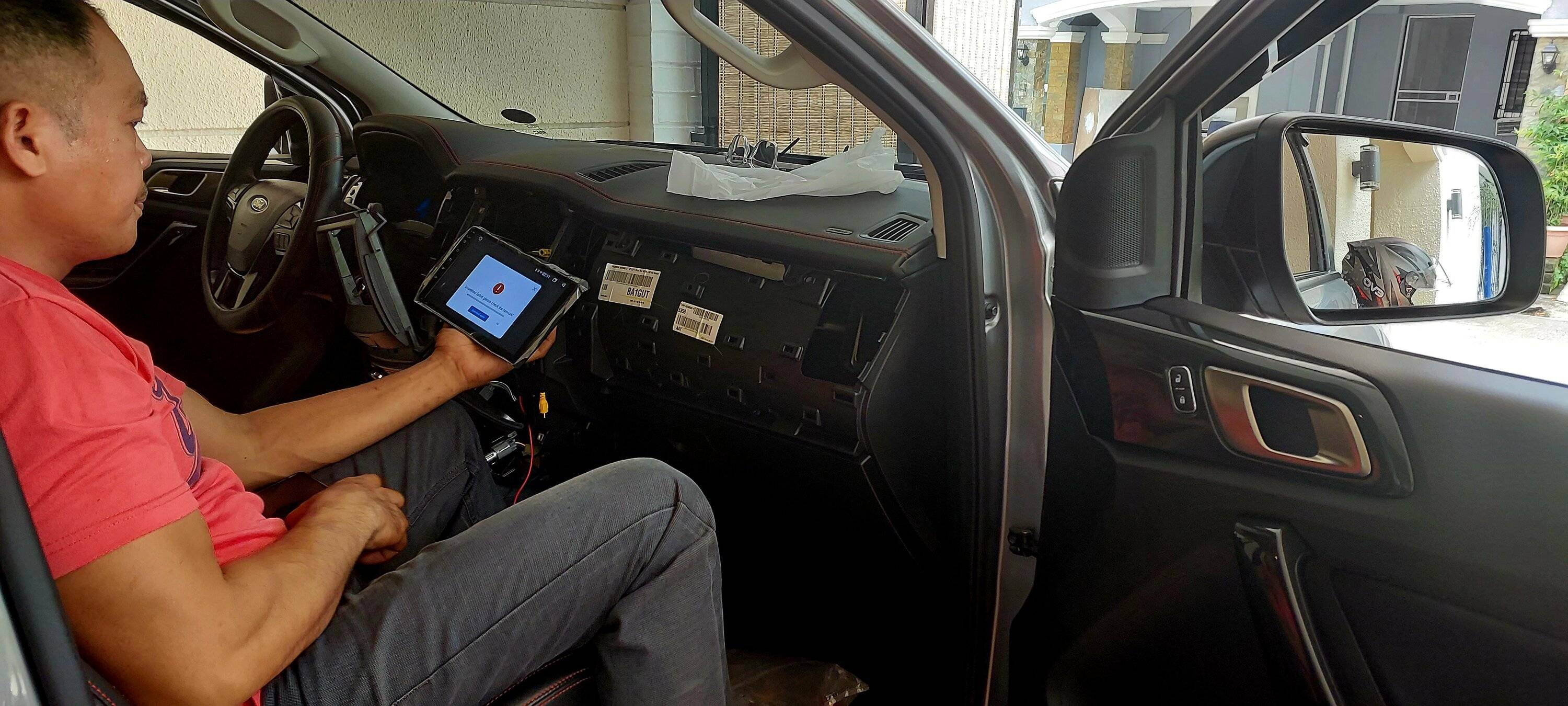

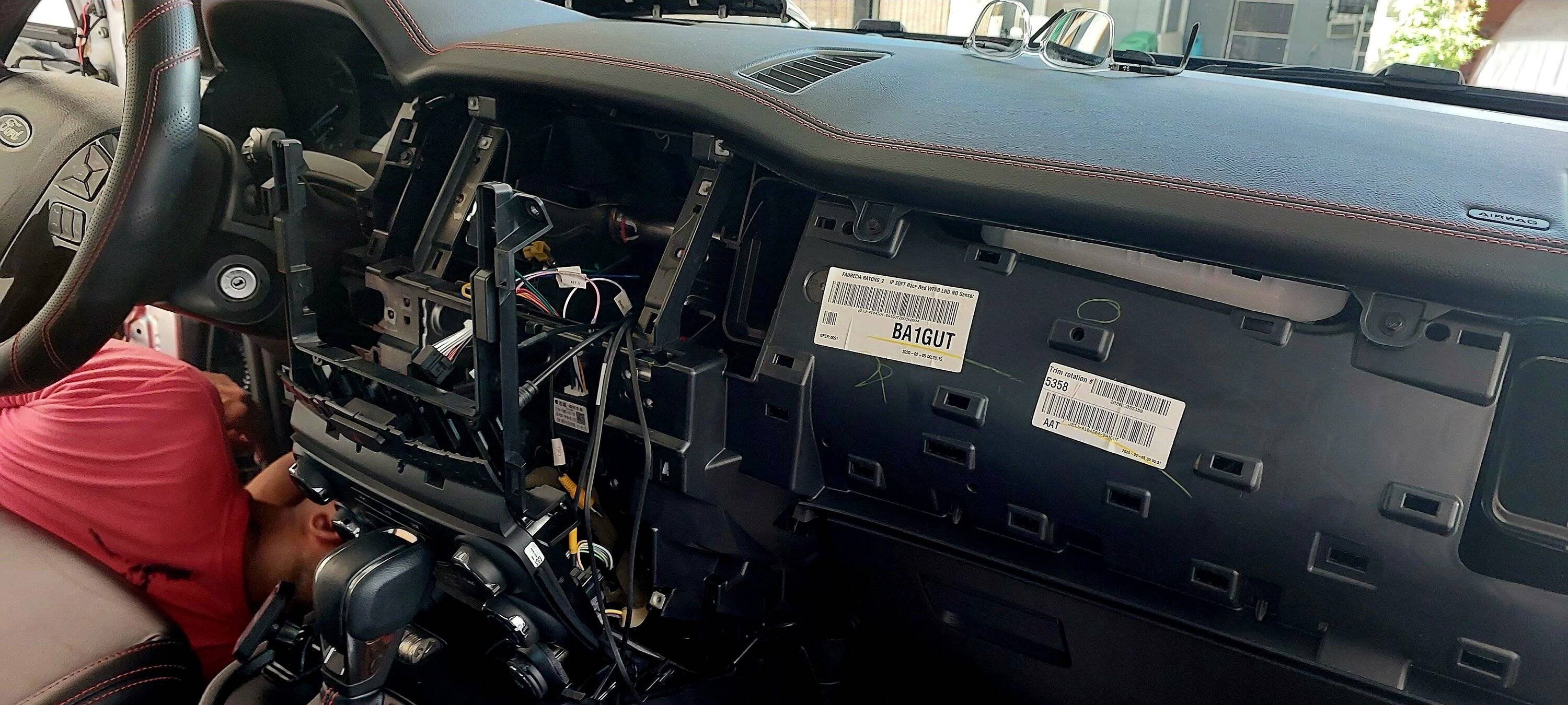

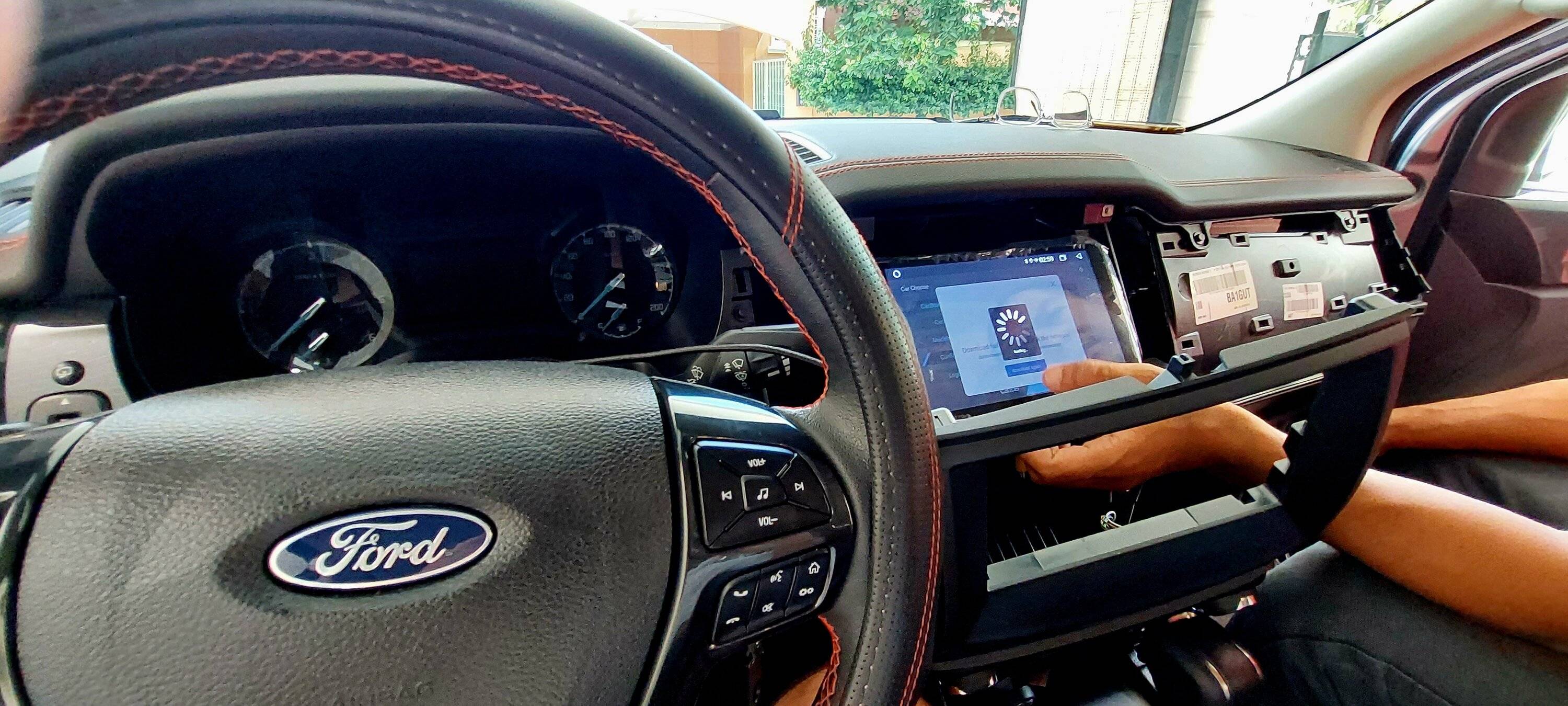

So the install complete. The checker board patterns are too calibrate the 360 camera. He re-calibrated my wife’s Everest. Well I keep trying to upload a short small video showing the 360 3D but it won't upload. It's only 17.8 mb.
