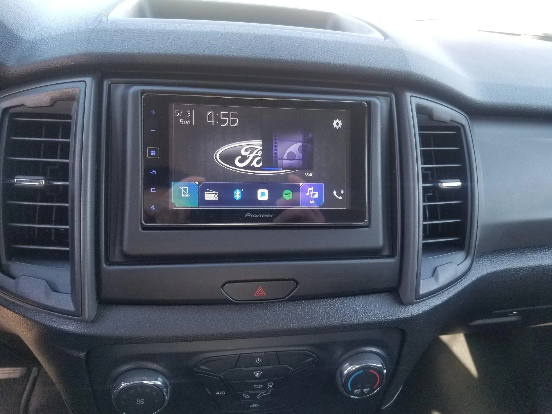

It was pretty easy to install
Steven D Tipton
Jun 17, 2019
147
220
Ohio
2019 Ranger STX Supercew & Ranger XLT SuperCrew
Thanks. Looks better than what I thought. Kinda of like the beveled look on girlfriends XLT but that should work. I'm planning on going with aftermarket but do you know if the sync 3 8 inch will fit that bezel. I really do appreciate you post in the picture thanks.

You could just by the factory bezel if your going to use a sync 3 screen
Steven D Tipton
Jun 17, 2019
147
220
Ohio
I'm undecided at this point that's why the metra would be a good option if I could go either way. I actually did the sync upgrade from 4 to 8. I liked it but wasn't happy with the gray bezel or having the extra heated seats and rear defroster on control panel. The metra would allow me to retain my current control panel. I noticed the other fella said you could get the upper bezel and has a video with a part number but I'm not having any luck.I did send him a message hopefully he responds and if I can get the upper and black I'll probably just use that and still order the metra..hope that's all understandable I'm in the garage I own a repair shop. knee deep in Grease right now. Thanks again

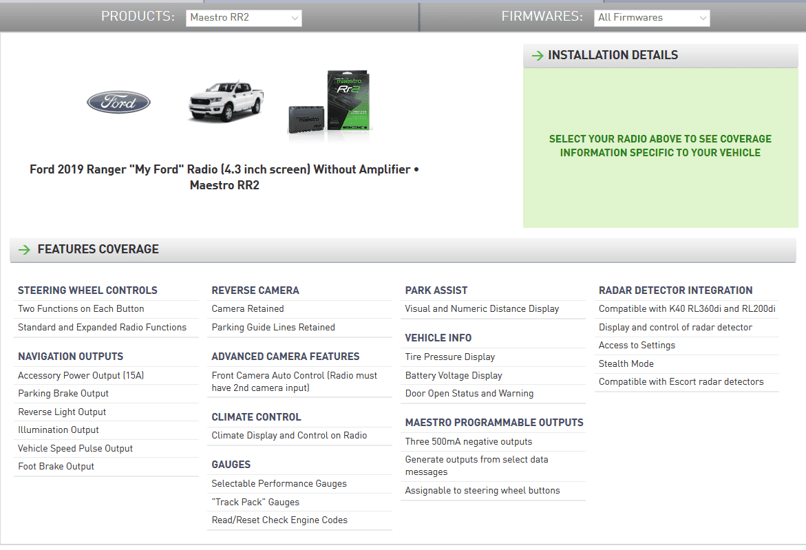

idatalink showing Ranger as compatible now... time to take the plunge.
So does this mean that you're able to retain all of your factory options on the aftermarket stereo? Sorry new to the chat but this is my next upgrade to my Ranger.
