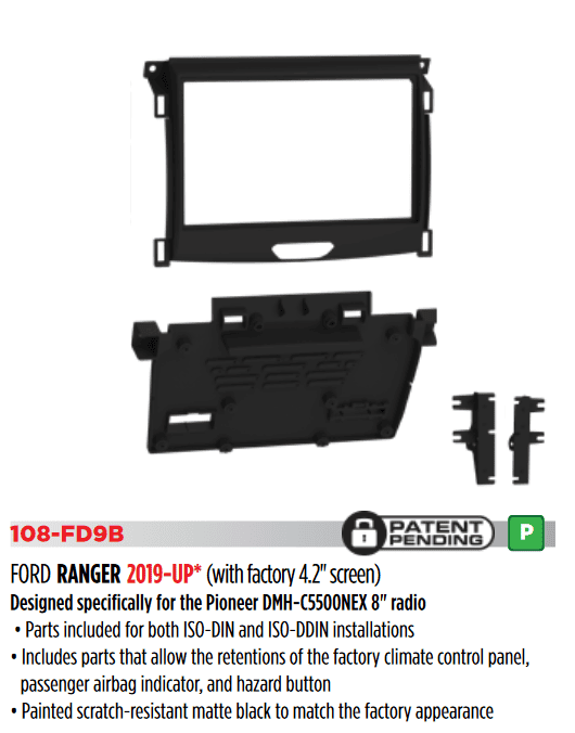

I just finished installing mine. Actually the back up camera is the last thing I have to figure out. I canā€™t find Ranger instructions so Iā€™m going off of F150 stuff.. canā€™t figure out where to hook up the actual back up camera from the truck.
This is a 19 XL going from the 4.3ā€ screen to a 8ā€ Pioneer DMH-C5500NEX with the metra 108-FD9B which is made specifically for this radio to give it a nice flush factory look in my opinion. I did the Maestro FO2 harness with the idatalink RR2. Everything is working great i just have to connect the OBD2 wires tomorrow and figure out the back up camera.

This looks so clean. I just wish there were an 8" option with NAV and wireless Android Auto
