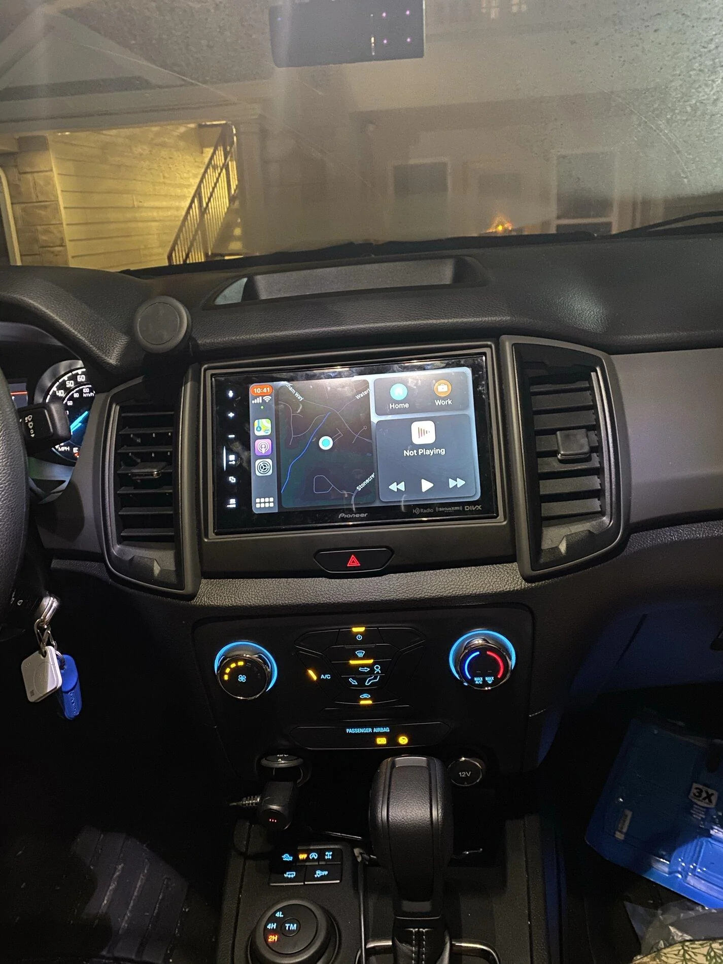

This is a 19 XL going from the 4.3” screen to a 8” Pioneer DMH-C5500NEX with the metra 108-FD9B which is made specifically for this radio to give it a nice flush factory look in my opinion. I did the Maestro FO2 harness with the idatalink RR2. Everything is working great i just have to connect the OBD2 wires tomorrow and figure out the back up camera.

once i hook up the OBD2 wires i will upload another picture. Not sure what all is integrated in it with this radio yet.

This looks so clean. I just wish there were an 8" option with NAV and wireless Android Auto

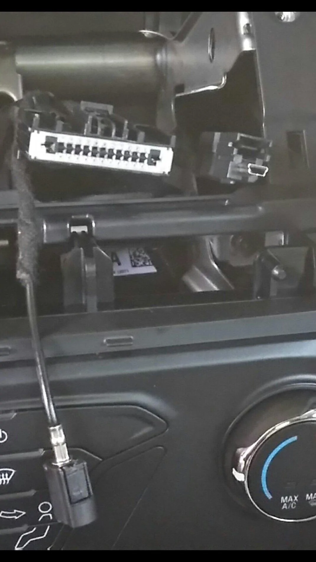

Old guy lost here lol....so I bought the F02 , Pioneer head unit and RR2 maestro....totally confused though never having done a modern stereo install....when you buy the F02 does that make it where you dont have to cut and splice any wires at all - its all a plugin affair ? Also how is the 4 pin data connection made from the truck to the radio ? Look at my connector on the right ...I assume thats truck data ? I have no cable in the kit that can possibly plug into that. Note I only have these 3 cables coming out of my dash that used to plugin to the old stock radio.
The USB on the right is only for the USB plugs inside the dash. Maestro should be fully plug and play.
