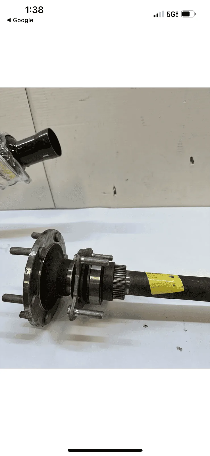

I have a question about the half shaft assy. The dealer replaced it and noted on the inspection that the wheel bearing is damaged after they removed rear right axle. They replaced the axle assy but doesn't mention anything about the wheel bearing. I was wondering if that is apart of the assy. The part number they used is kb3z-4234-d. I tried searching the part but it doesn't give details.

Picture on EBay shows bearing as part of the axle

I had a leaking axel seal. They replaced the whole assembly (axel, bear and seal).
