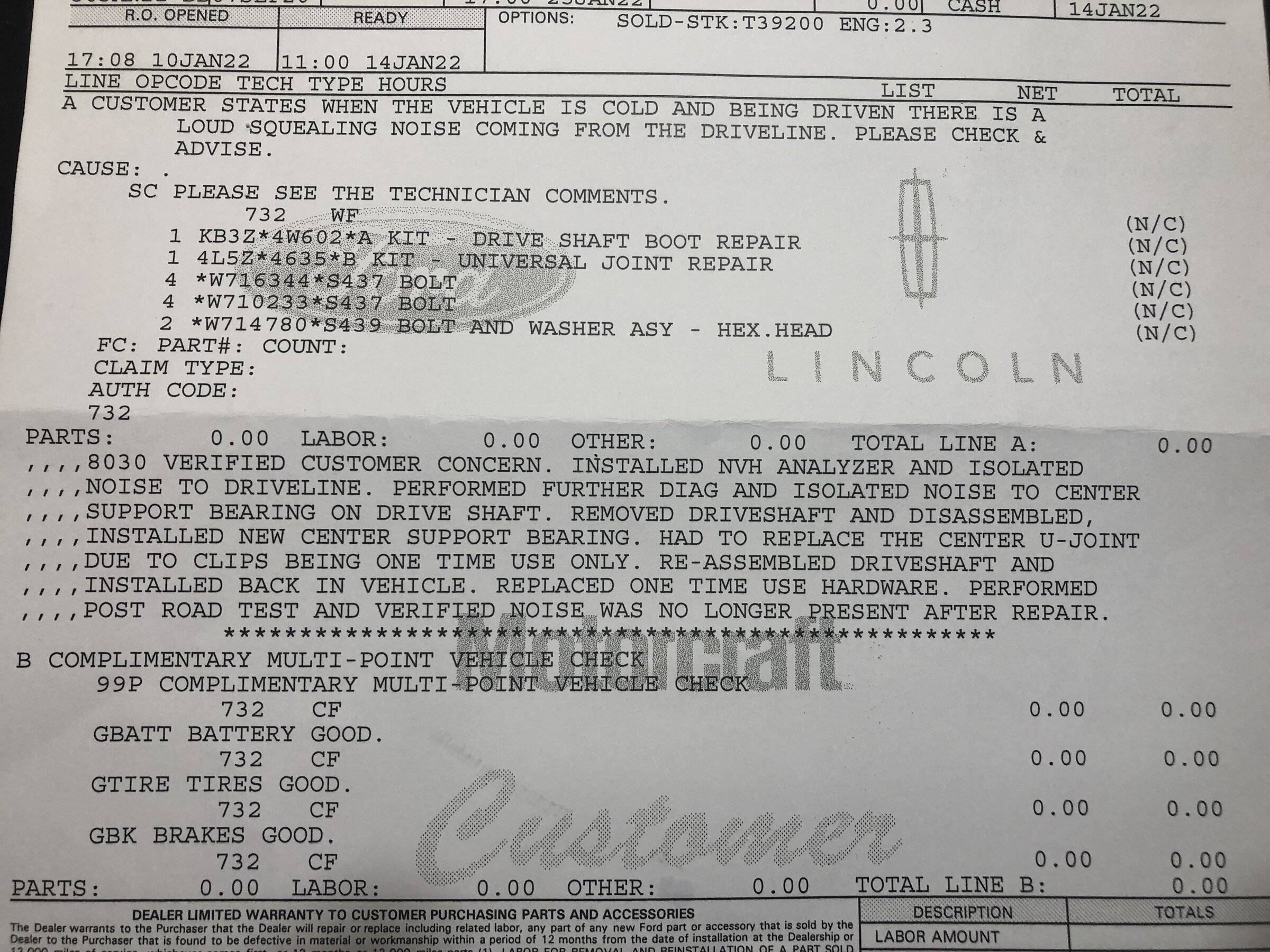

I wanted to post an update for my truck. It’s fixed now (probably). It was 29 degrees Fahrenheit this morning and there was no squealing. I dropped it off last Sunday at the dealership and just got it back yesterday. It was there for so long not because of the repair, which only took a few hours probably, but because they had several technicians out with covid. That was fine, I just drove my Focus.
They replaced the driveshaft center bearing and the center u joint since it had one time use clips or something. Here is the description paper they gave me.

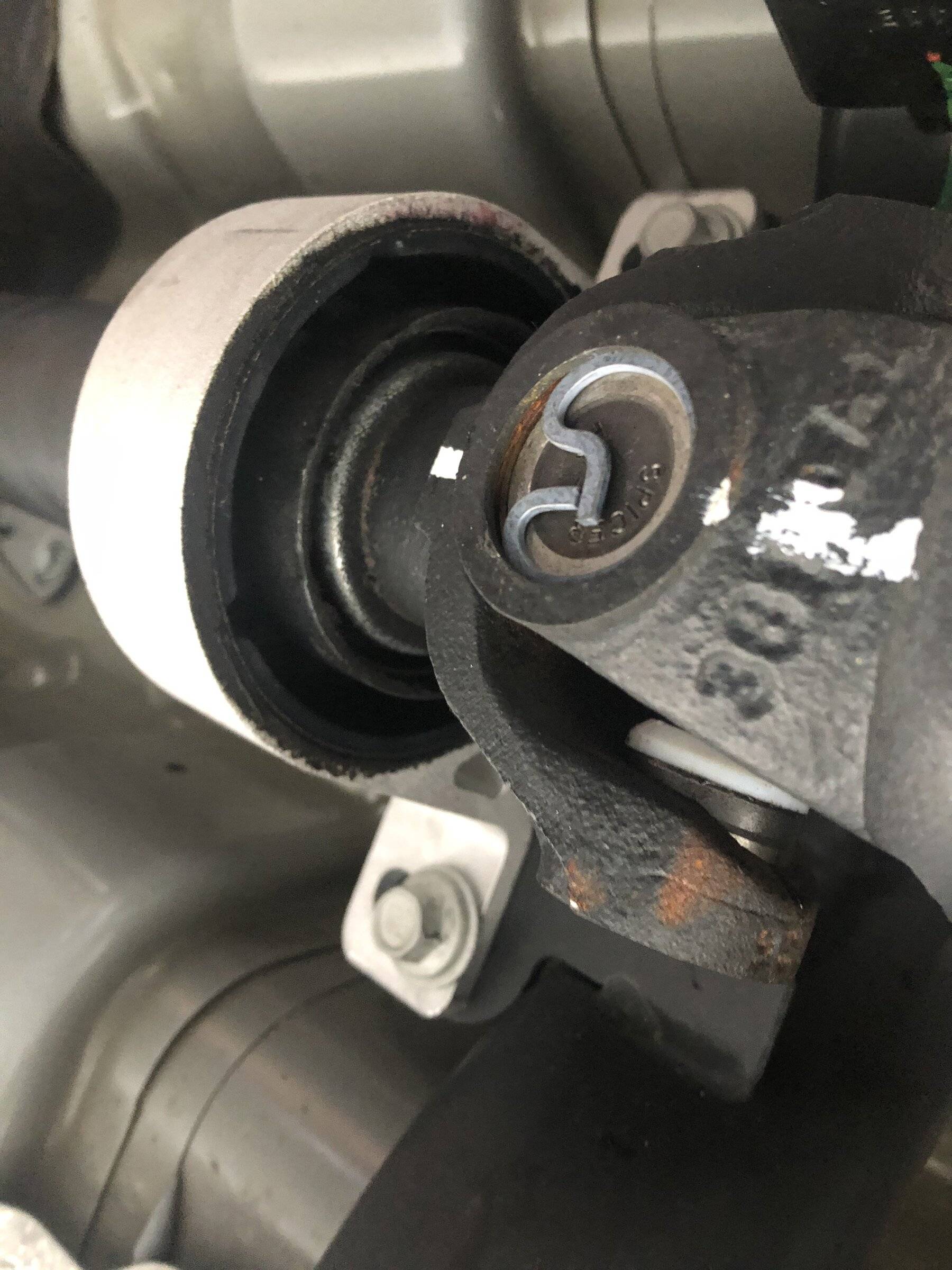

Here is a picture of the thing they replaced. It’s by the fuel tank where the driveshaft assembly bends to go down to the diff.
What the service advisor said to me was that the squeal was caused by the rubber cover for the bushing rubbing against something. So it was probably fine to drive on it a while if necessary.
