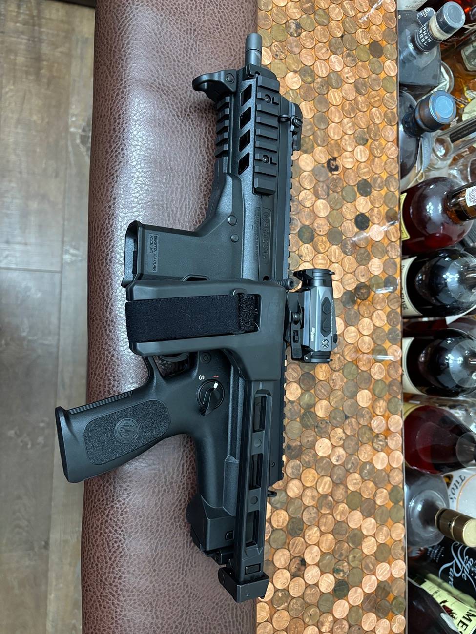

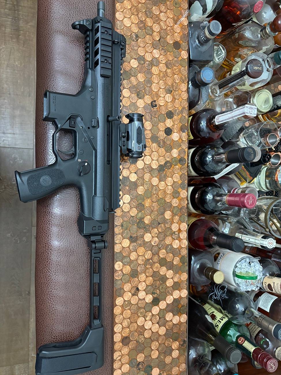

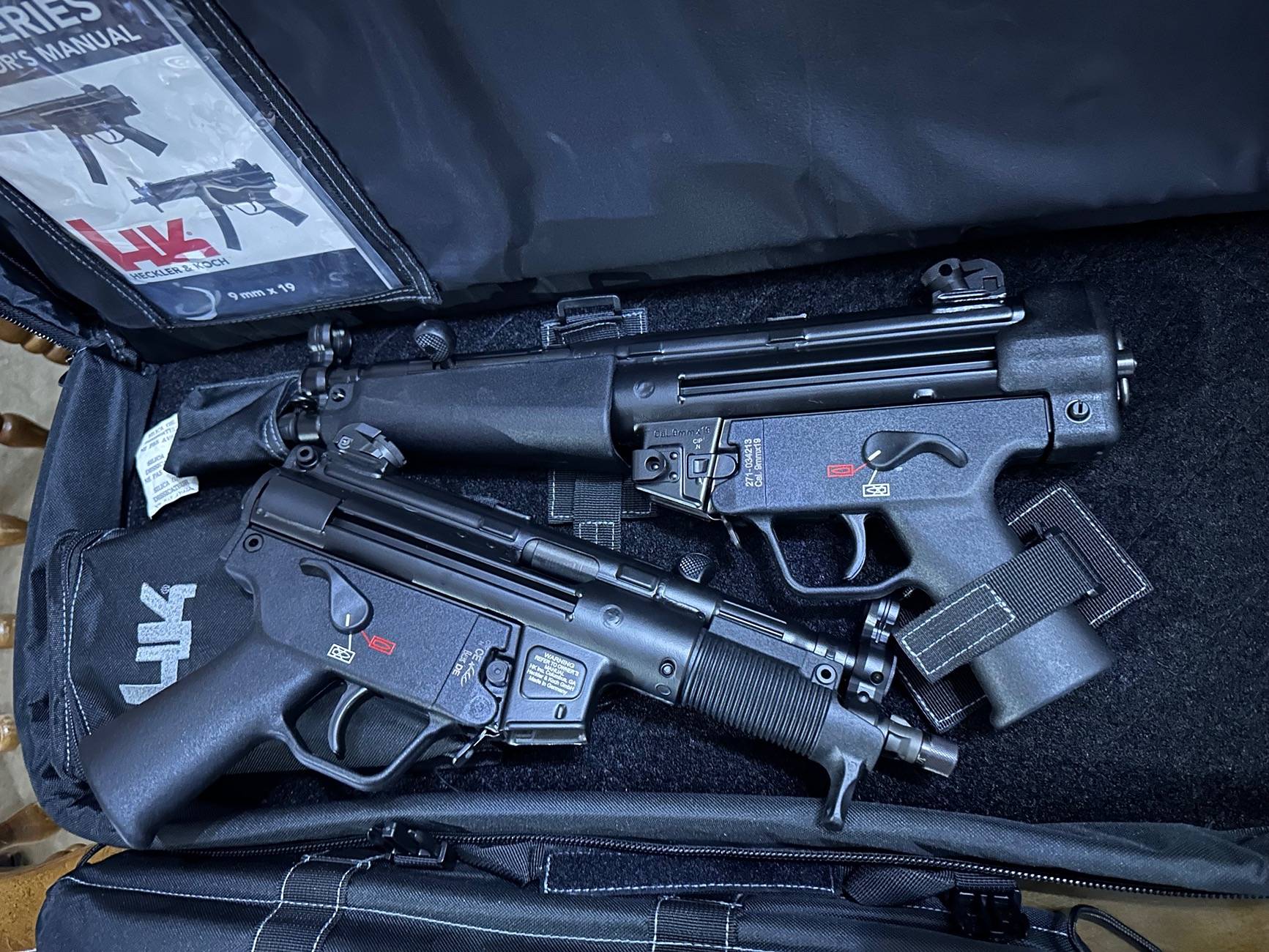

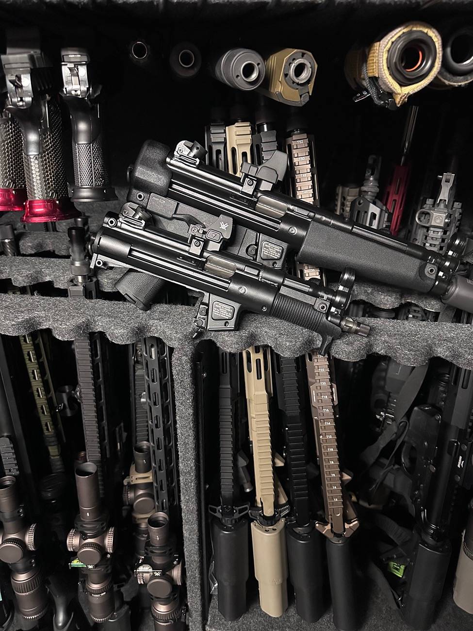

Picked up a couple of H&K toys, an SP5 and an SP5K-PDW. Got optic mounts on with a couple of new Vortex Defender XL dots and sent the lower off to use as a template for a new Magpul lower to be modified to fit the K version so I can swap in a Timney trigger like I did with the SP5. Now I’m just waiting on the stamps to come back to SBR them and the stamp for another SiCo Omega9k suppressor. Should be a couple of fun little suppressed SBRs!

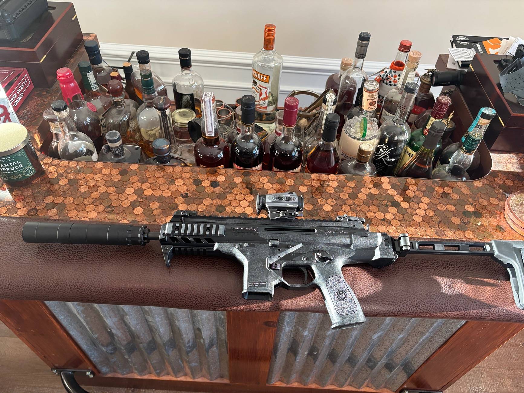

It’s a PMX. Not sure how to edit.

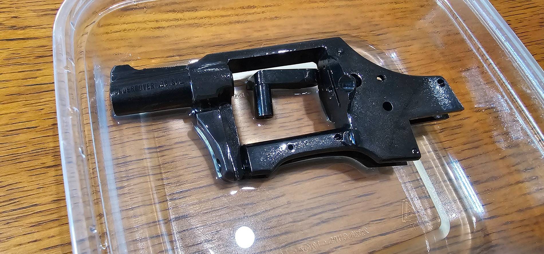

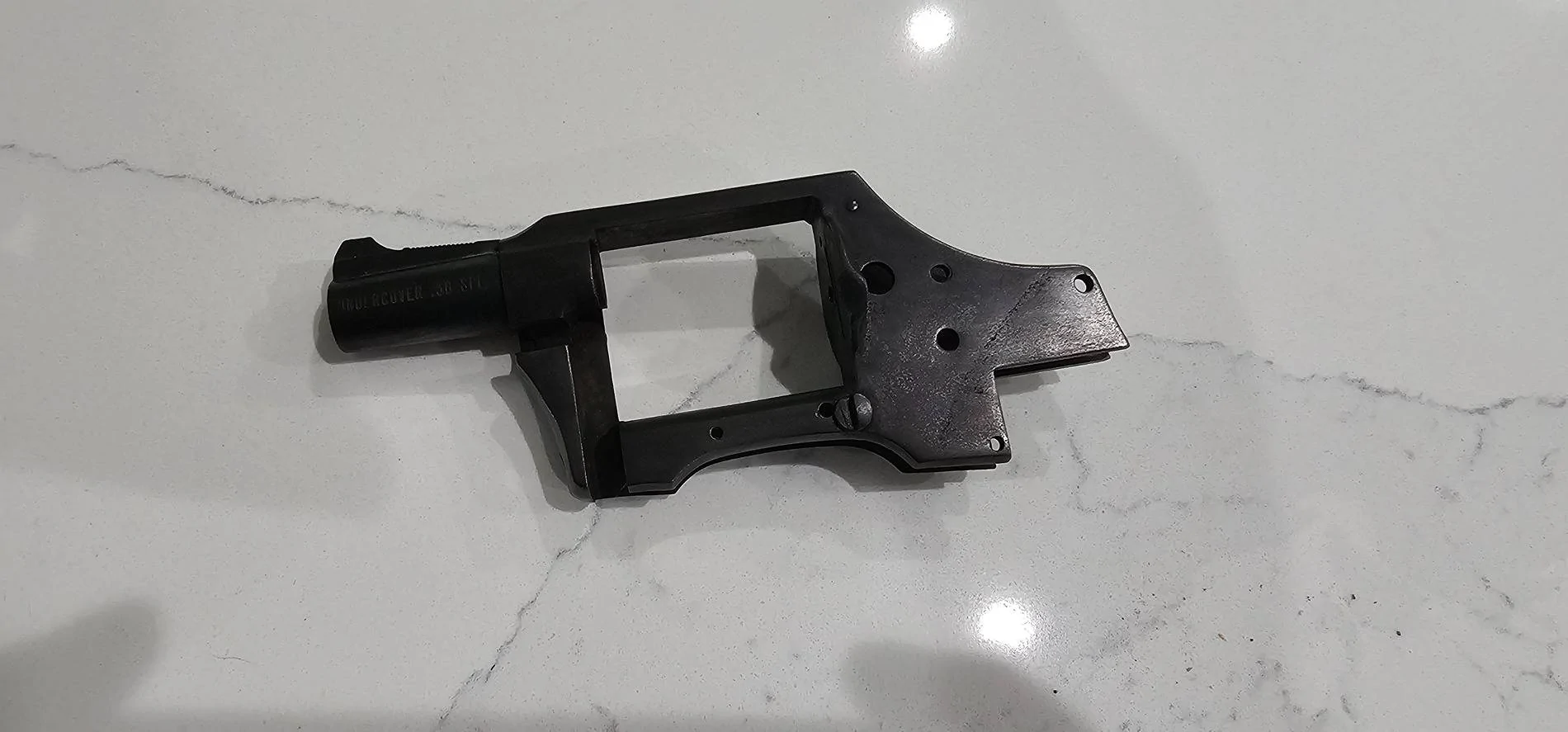

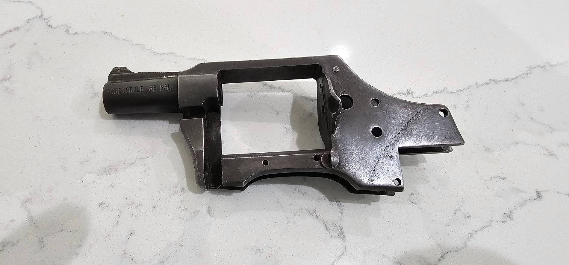

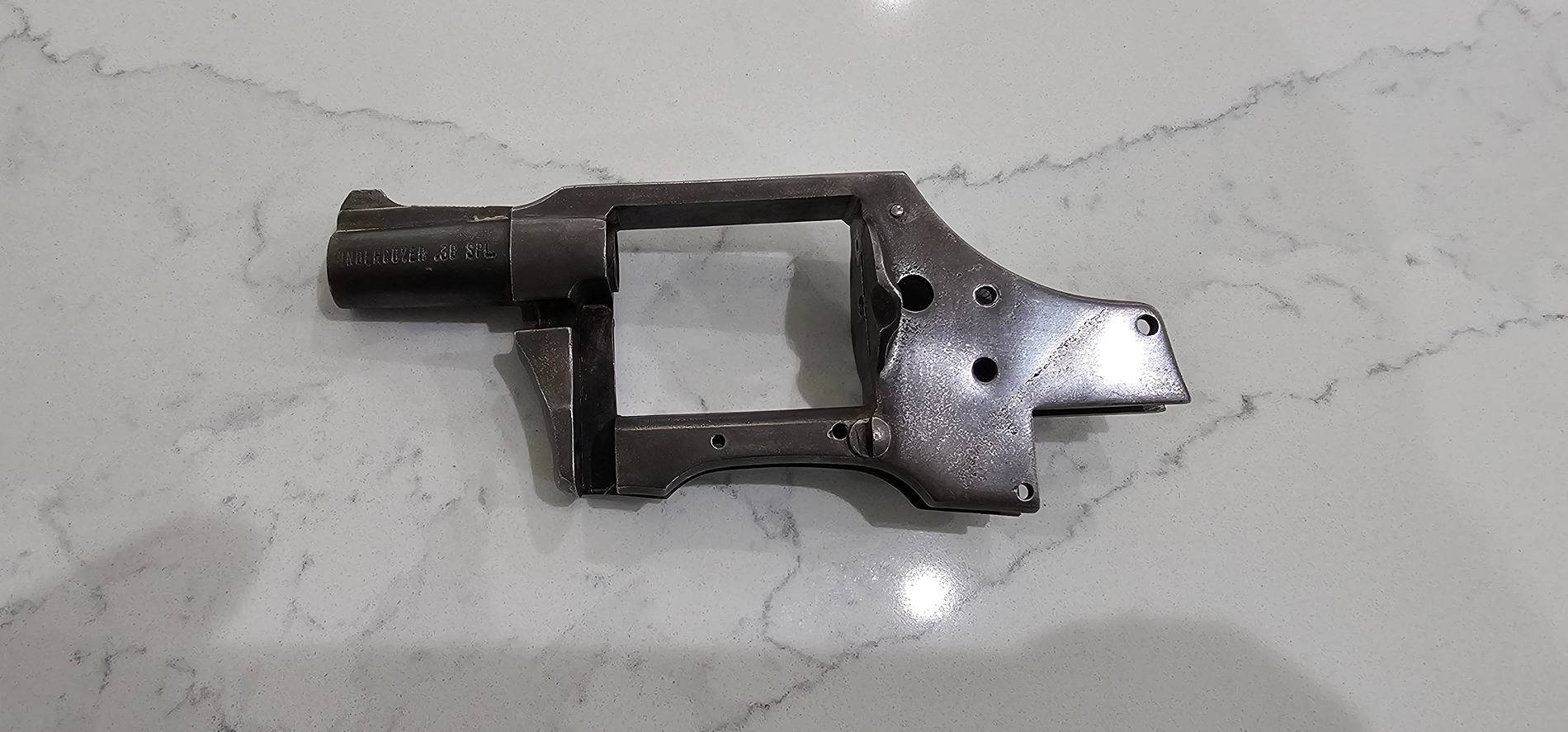

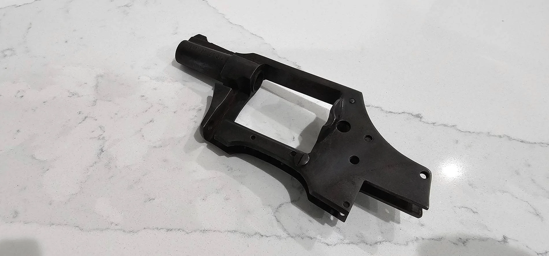

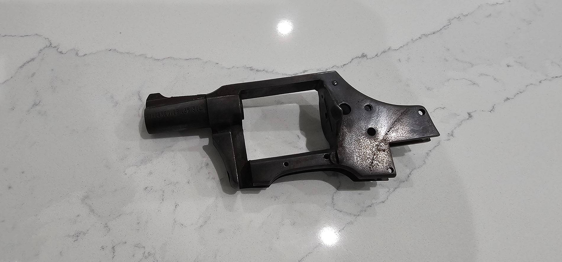

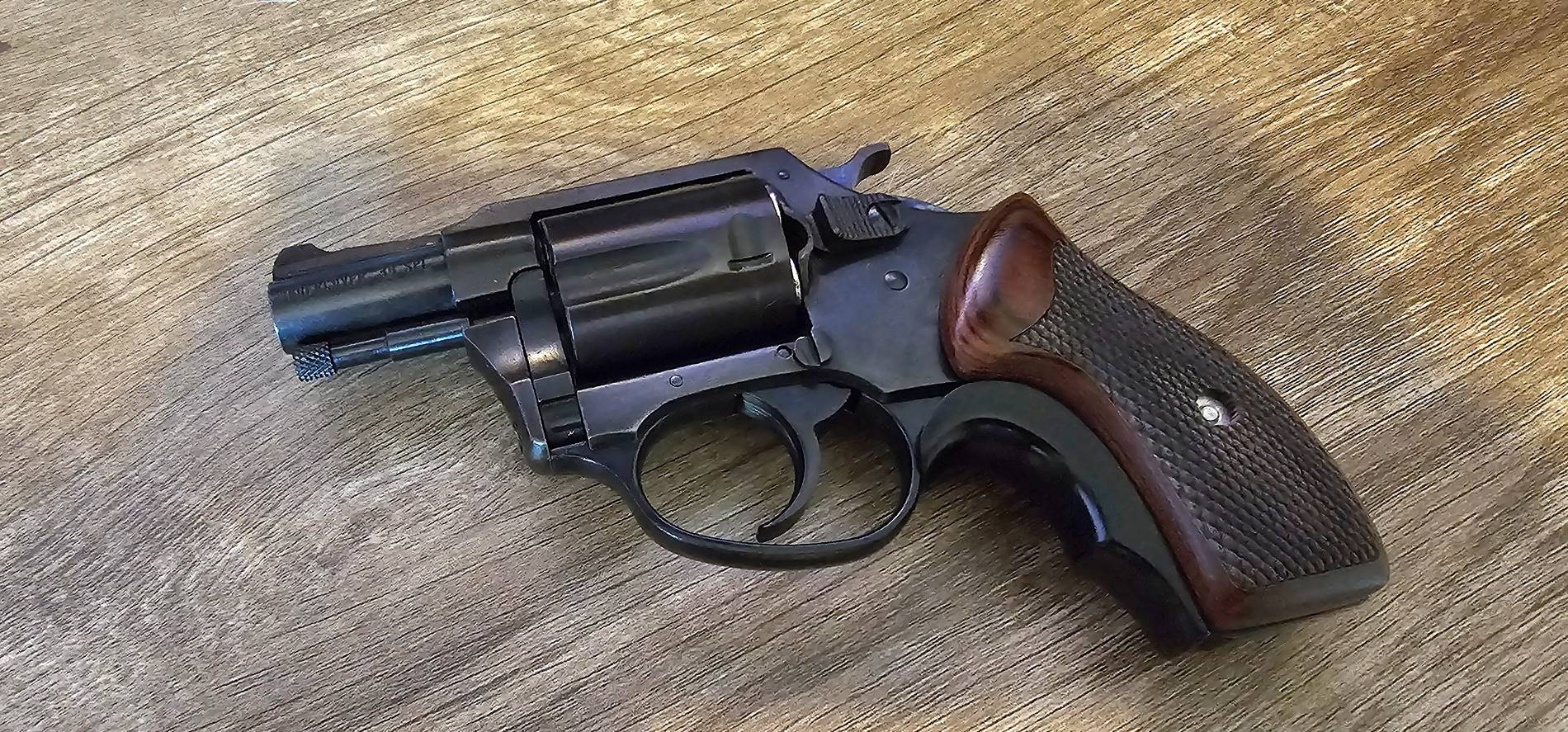

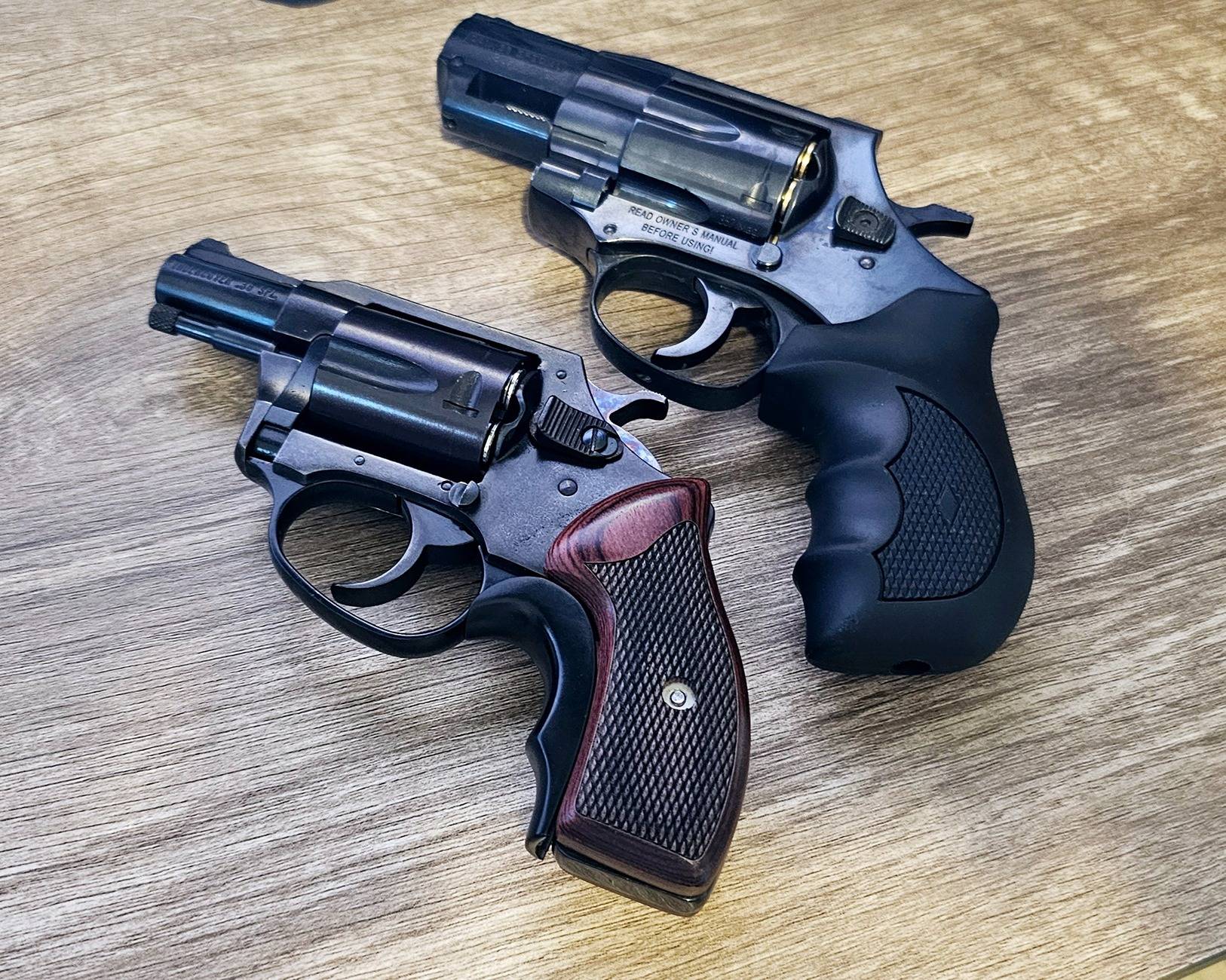

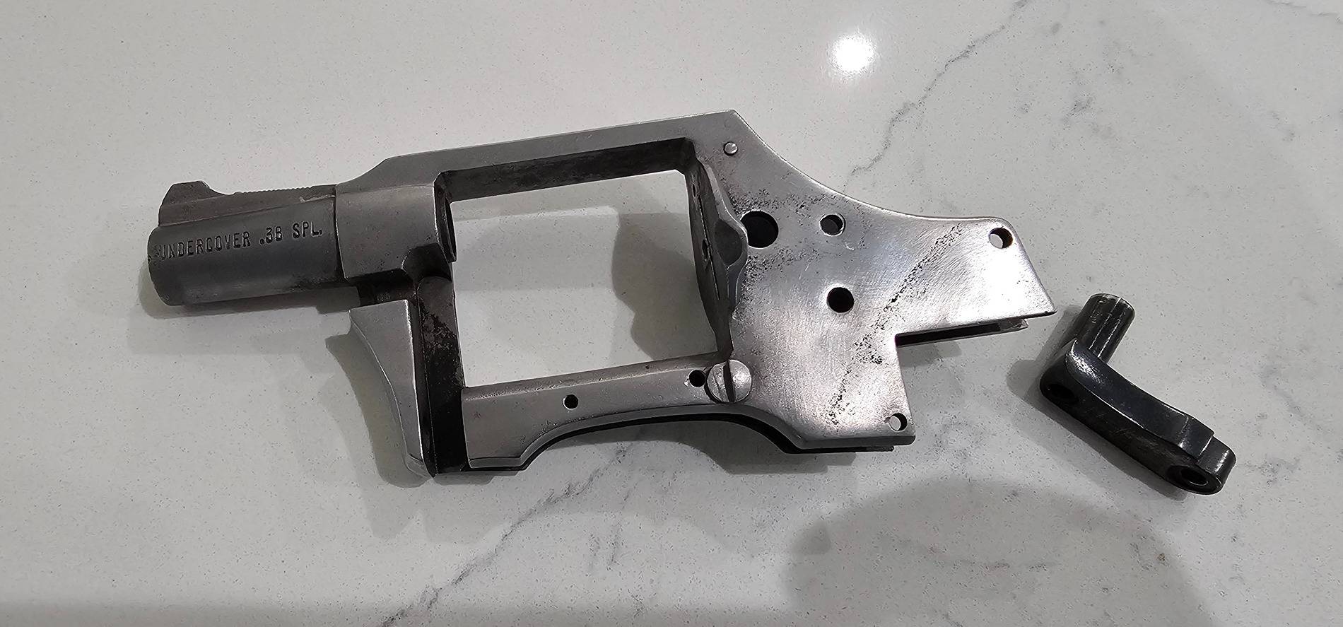

I worked on a home bluing project, the slow way.
Rusting agent:
3/4 tsp non-iodized salt
1tbs white vinegar
4 tbs hydrogen peroxide
Completely degrease your parts (brake cleaner) and then wipe a coating of the rusting agent evenly on the metal. It'll quickly form red oxide.
Drop the red rusty part into boiling distilled water, and the red oxide converts to black oxide.
Card off the powdery black oxide (I used steel wool and paper towls) and you are left with a blued finish.
I did this process seven times and got a deep black that I'm happy with!
After the last carding, I pickled the metal with WD40.
Tomorrow I'll assemble it!

I might try this process on my old Ruger Security Six .357 Magnum
