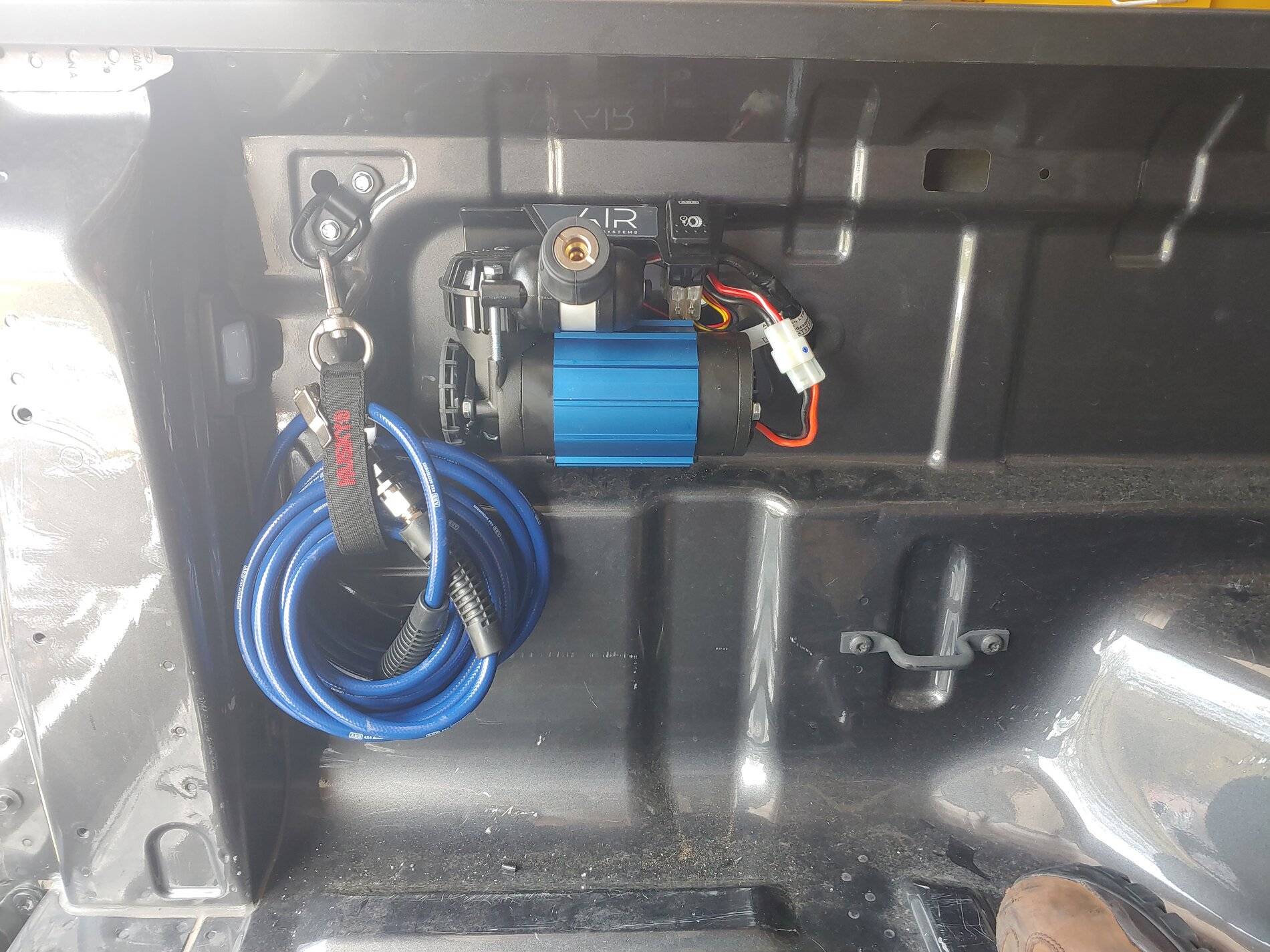

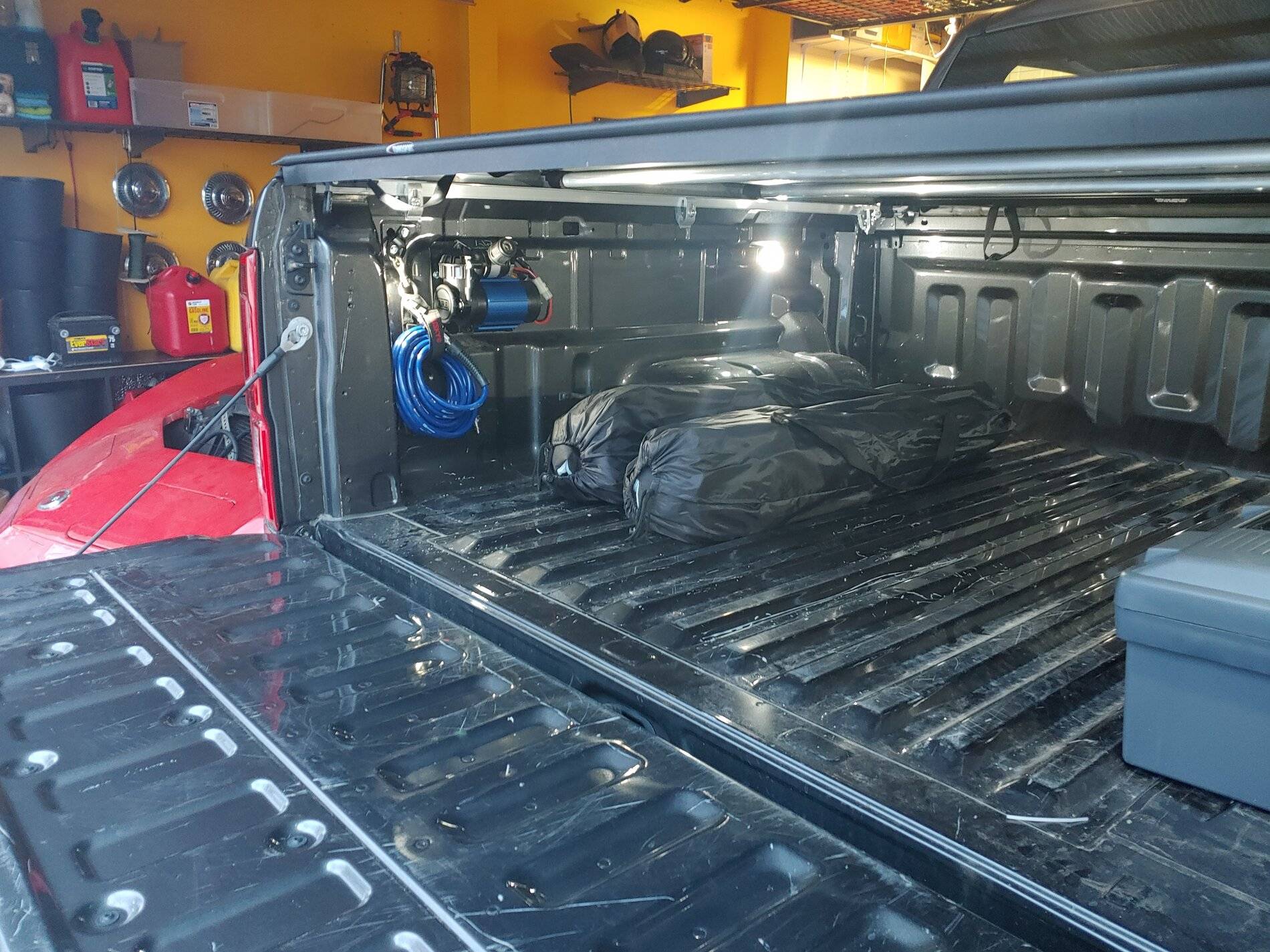

Lol so here is what I did!! I got the Ford Performance portable kit!! I also decided to make it a full on-board kit because thats the kind of person I am!! Wich compressor does Ford use? They use the ARB single compressor that is reated to fully inflate a 37 inch tire in 2 minutes. How well does it work? Verry well!! I think I can inflate all my tires between 5-10 minutes from 18 to 30 psi. Here are some pictures of my little setup
This is pretty awesome.
