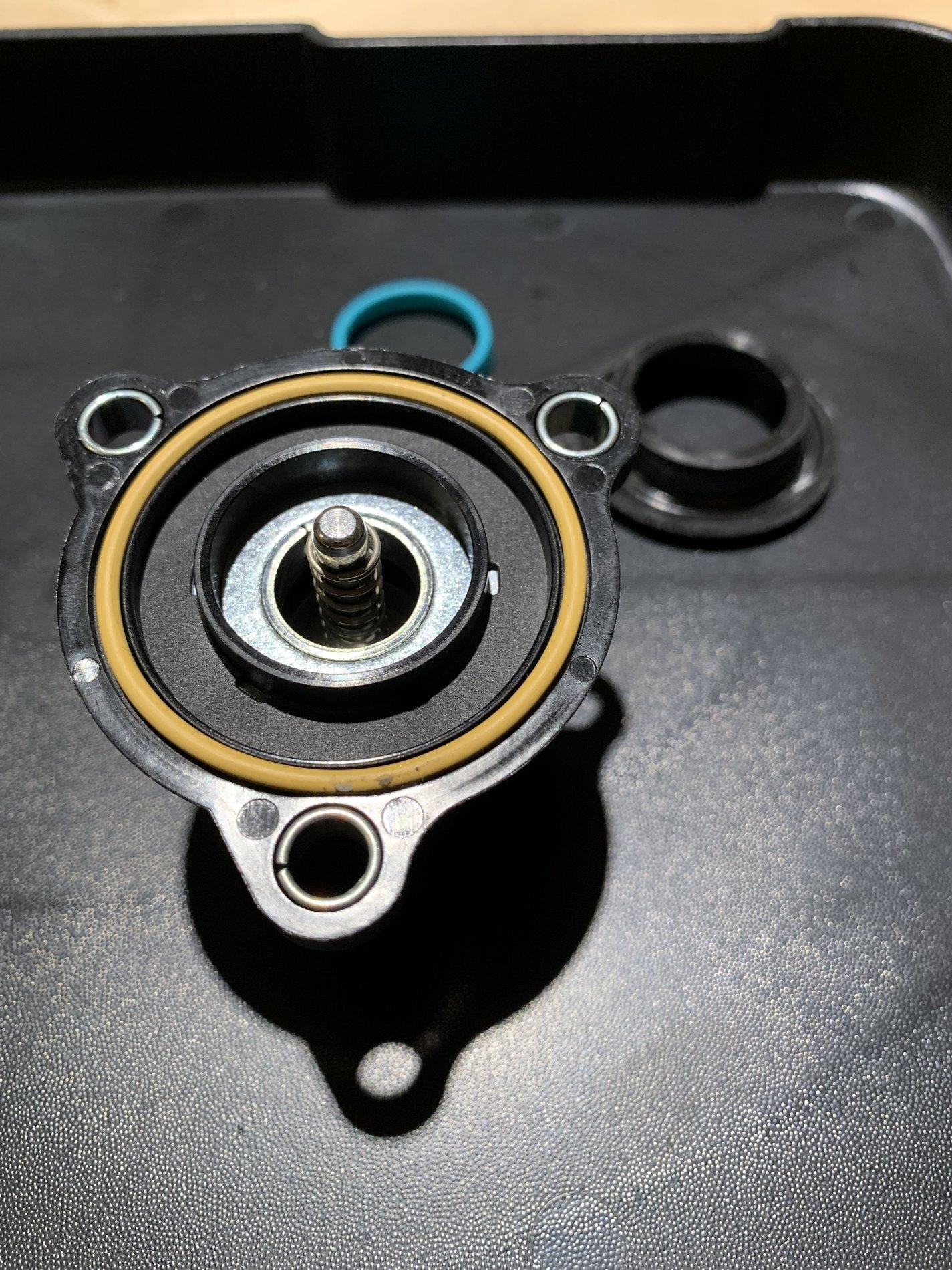

Use pliers and twist off that tall ring. It'll make crunchy noises but it comes off. Then you assemble as instructed.
Oh really?! Hah okay glad that’s the case. I’ll try it. Thank you!

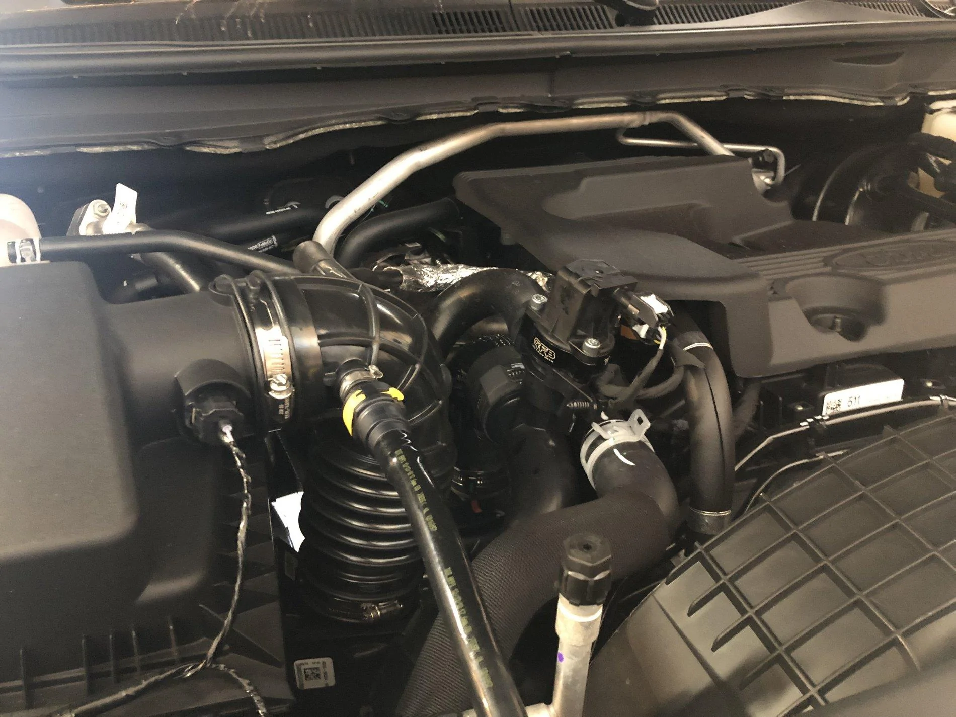

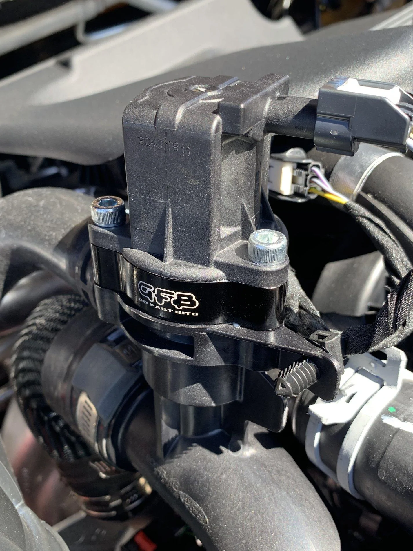

I was going to ask you guys if you noticed any difference in the throttle response, then decided it would be just as easy to go install it and see for myself. I should have provided additional pics but I ran into the same “now what” moment before pulling that big circular plastic collar away from the inner housing; it popped out with one swift jerk using a pair of need nose pliers (and a red rag to protect the piece I was pulling). It installed easily although I think I used too much thread locker on the allen screws, which I’l pay the price for if I take it back off later. I used the LA Co Turbine Oil (aka Zoom Spout Oil), a very light oil that doesn’t gum up in cold weather and doesn’t leave a residue.
My observations so far driving around town are that you notice it, sometimes. If you were in boost a few moments prior and roll on the throttle it noticeably eliminates the boost delay. From a dead-stop, no difference because there was any residual boost left over. I’ll have to see what difference it makes at highway speeds.
I expect it to make a more noticeable difference when I get my 5-star tune loaded up. Installing the N-gauge tomorrow, pulling the stock map and sending it to 5-star.
