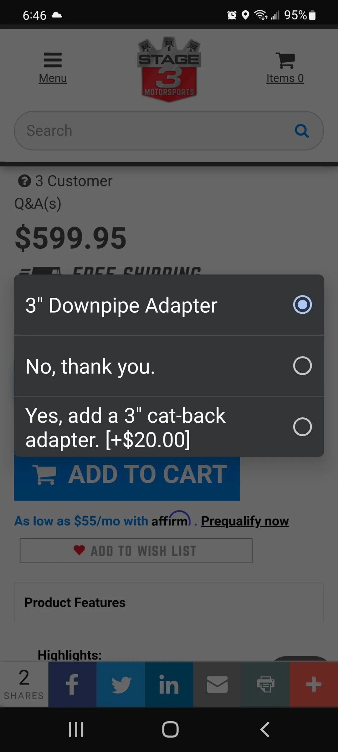

Did you buy from Stage 3?
https://www.stage3motorsports.com/d...-3l-ecoboost-spd-3in-ss-catted-downpipes.html
That one?
Their website says...
. This downpipe comes with a step-down connector that connects to the factory 2.5" cat-back system. A 3" adapter is available at additional cost from our drop-down menu above.
And the drop down indicates you are paying $20 extra for the "additional adaptor."
"Add" says to me you paid $20 to get BOTH adaptors.
I'd contact Stage3 if indeed you purchased from them.

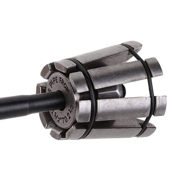

You can also go to a local exhaust shop and for a few bucks have them use a die and adjust your parts (off the truck) or make a quick adapter if you end up needing one.

That being said, old info or not, the website states clearly that you get both if you paid the $20. IMHO, Stage3 owes you the adaptor you need.
Yup when I ordered my Flowmaster 40 muffler I accidently ordered with the inlet/outlet half inch smaller. My local exhaust guy through the muffler on his machine and in 2 seconds the die stretched the tips open that extra half inch.
