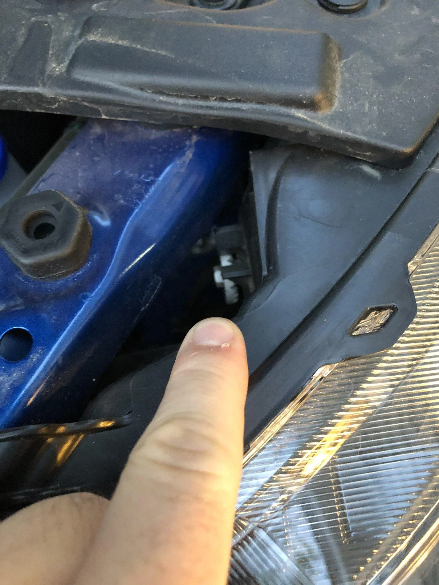

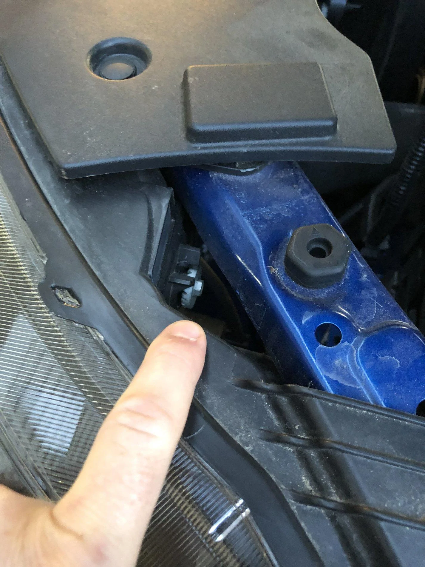

I did mine back over summer. I do not remember which way I turned (using screwdriver method )to lower them. The confusion in this post is that if you turn the screwdriver clockwise, it is turning the screw counter clockwise. So Unless someone specifies which method they use, it's unclear. I adjusted mine too far down, came back up a bit (used tape on garage for reference), but I must be right on the fringe of being adjusted too high, as I will get a very infrequently, flash from oncoming traffic. I will try to adjust mine in the coming day's and I will let you know which way turning the screwdriver works.

UPDATE:
Using the philips screw driver method, turning right/clockwise (this actually turns the 8mm bolt and gear washer left/counter clock wise for those using that method) lowers the beam. I put a reference mark on the gear washer with a sharpie and took it one full turn as I feel I am pretty close. One full turn on the washer was barely noticeable @ 4ft from my garage door. This is the only way I can get my truck level (this was a few complete turns on the screw driver).

With the screwdriver, you turn the screwdriver clockwise to lower (either light). (Turning the screwdriver clockwise actually turns the gear (washer) counterclockwise). Don't over think it ?. Just use a screwdriver (easier anyhow) and turn right to lower or left to raise your beams.
