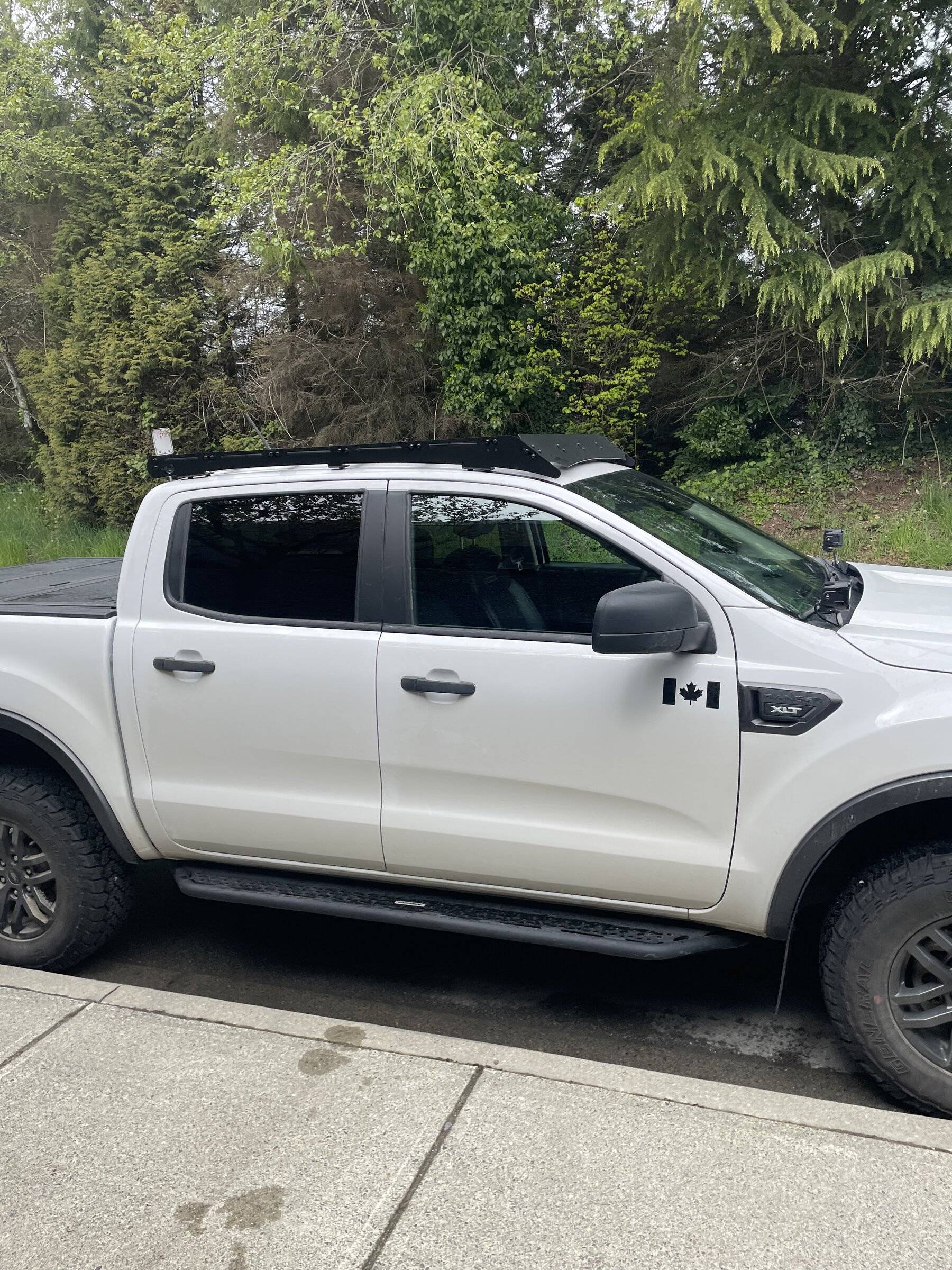

Hey guys! Just got the prinsu rack installed, and I’m stoked on how it looks!
but I was shocked by how loud the wind is @ highway speeds.
All the reviews I read online mentioned they barely noticed it….
So.. I’m curious to hear other peoples reviews of it.
Was I being unrealistic of how quiet it would be?
Or Possibly installed incorrectly?
With the way it’s installed on a ranger the front to back adjustment is non existent, but it Seems like I could lower the wind fairing a little to make a better seam between cab and the rack as well.

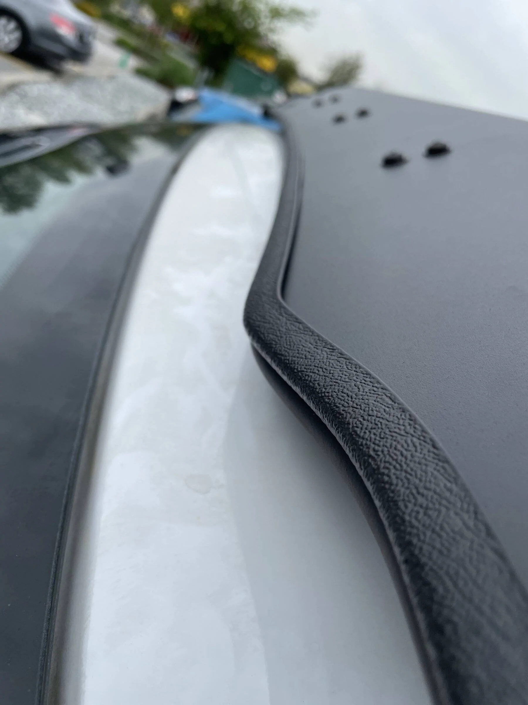

Another thing that I didn’t realize til
I got home is the shop didn’t replace the gutter moulding, did you guys just chop it up and 3m it down? It looks horrible without it!
any tips are greatly appreciated!

Yes, cut the original molding and tape or glue back in place. One section they could have used a factory bolt to help hold back down.
For wind noise, you are missing the leading edge trim. It goes on the lower edge of the wind deflector and makes a big difference.

That’s great news. I spoke to the shop and they are going to fix both of those things for me ASAP

As for the gutter trim, it isn’t necessary but looks way better when it is in place. I measured and carefully cut mine so I could reuse the entire length. I would strongly recommend that if at all possible.

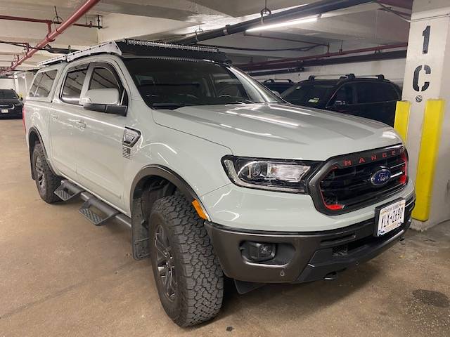

Hey Guys,
Not happy with mine as well, crazy wind noise at highway speed, maybe making a better wind deflector?

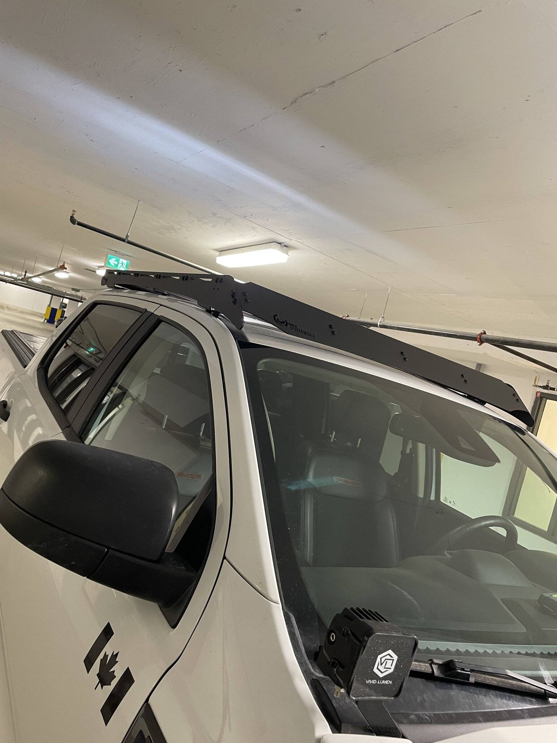

I’ve read that moving the light bar back and the first cross bar back helps as well.
also lowering the deflector if you can

Looks like you have the trim on already? The more likely culprit is the light bar. I’m not much help there.
Before a road trip at Christmas, I ran painters tape from the 1/2 way point on the Prinsu deflector down to about 2” from the top of the windshield. Worked so well that I wrapped that with black Gorilla tape and left it on there through the end of February. I considered making my own deflector out of black lexan, similar to the Yakima/Thule offering for their racks/baskets. Maybe something you want to consider.

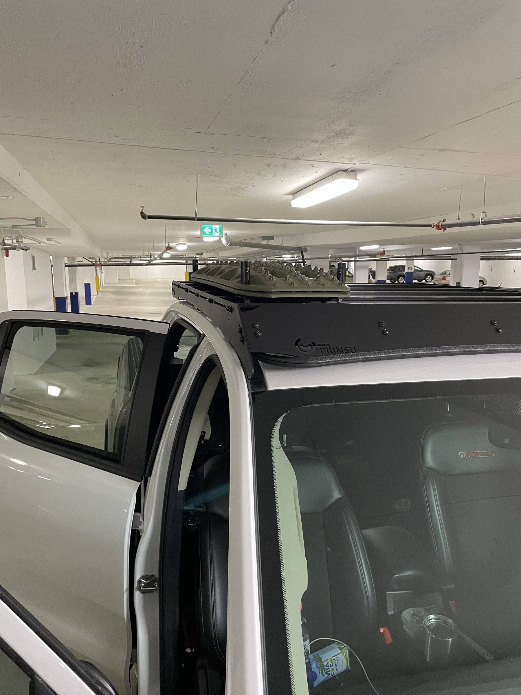

Following up. Got the noise reducing trim, makes a world of difference with the shuttle/howl. I think it still may be possible to lower it closer to the cab, but we will see. I’m sure once things are mounted it’ll be the least of my worries. Lol

Couple of questions, did the noise reducing trim come with your prinsu rack or did you have to Jerry rig something to help with noise? And how high up does the rack sit above your antenna? From the pictures in this thread it looks like the rack sits a little below the antenna.
The noise reducing trim made an incredible difference, no whistling or howling anymore.
I will say there is still some noise in certain conditions... and at high speeds you will def hear it.
and yes it sits below the antenna.. by quite a bit. I now have a pelican case mounted on there and even thats still lower than the antenna.
