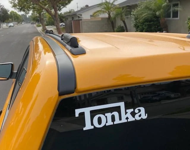

I think that's more a Ford problem with holes only for roof trim. Hard to design a secure roof rack system using only one or two 1/4 inch holes as anchors.

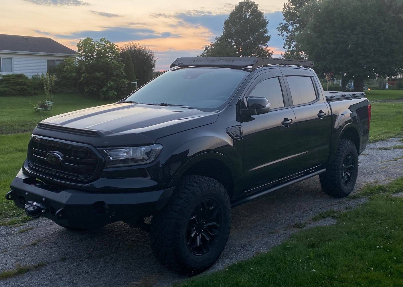

So I finally got it all done a few days ago, but busy and I loaned it out before I got a photo.
Once complete it is AWESOME. I could not be happier with the final product. It uses five 1/4 inch bolts along each rain gutter. The rain gutter itself is a spot welded 2 ply of sheet metal, with 1 inch 90 degree channel on both sides. As far as sheet metal anchor points go, rain channel is near the best spots on a vehicle.
The hardware is good with exception to the plus nuts, which are not bad, but not great. I do like the brass plus nut product. It is a solid anchor for single side access sheet metal, with decent water seal. Somewhat ugly to install in the welded rain gutter. This really is not the best project for first time users of these fasteners. The learning curve was evident between the first and last install.
I do have other projects in mind, I am looking forward to more testing on them. I but a heavy duty rivet gun, and some variety packs of fasteners. The rivet gun does help with the Prinsu install, but the bit that came with mine isn't long enough for the full pull on the long brass, so I had to start them by hand, and set them with the riveter.
Prinsu provided spare of every bolt, screw, washer, and nut, except the plus nuts and bolt to install them. The matching aluminum Pnuts are unobtanium through all my searches, and the brass are unobtanium from any brick and motor supplier I know of. I was able to order matching brass Pnuts from Amazon, but 10 days delivery.
I got the 3 brass in on the first side then onto the 2 aluminum. The first aluminum in, without problem, but I destroyed the second. When I tried the nest aluminum it was a struggle too, and I realized the bolt had damaged threads, which caused the problems. The replacement was pretty messed up, so I finished the first side with brass.
In the end I used 4 brass on each side and 1 aluminum, they suggest 2 aluminum each side because brass doesn't fit all holes. Which brings us to the next problem, which is the worst instructions I have ever seen, that actually appear to have put some work into. The detail on interior removal is great. Every screw and step, even those not needed. The actual install of the unit and hardware skipped many steps, and key pieces of info. They make no mention of drilling 8 holes. and leave other items out mentioned in the video.
One thing not in the video, is they don't specify which hole the factory rear trim hole should be used for. The rear bracket has 2 holes, and one is for the trim hole. I used the rear most bracket hole, and one both side, the front Pnut, wouldn't clear interior framing. The interior metal was also at an angle, so drilling it, without damaging the surface hole was tricky. Also my front wind seal, sit about 1/2 inch above the roof, not in contact at all. Moving the hole unit back 3 inches would resolve both issues.
I used the yellow hole for the rear most factory hole, and the black circled plus nut wouldn't fit properly. Trial and error, moving it around before marking would have helped, but it has to sit on the spacers, which even with 3 or 4 people sounds like a recipe for damage, and could easily be resolved with a simple X to mark the bracket hole for the factory location in the instructions. Also the trial fitting only work for the seal placement, wont help with the interior structural blockage.
I can adjust the front to get the wind seal in place properly, and I worked around the blockage, but this install was much worse than it should have been. It was not cheap by any means, and for that price, I expect proper instructions, and spares for the hard to replace hardware, not the common stuff.
Recommending it to others is a tough call, because at the end of the day, I believe it is the strongest, best rack available, but the install and instructions are so much worse than they need to or should be.
Also cheap bastards, give you every part in black anodize, other than the front wind block support, because it can't be seen from ground view, so they toss in a cheaper silver strut. That is a pitiful move to save an inconsequential amount of money on a $1K+ unit.
