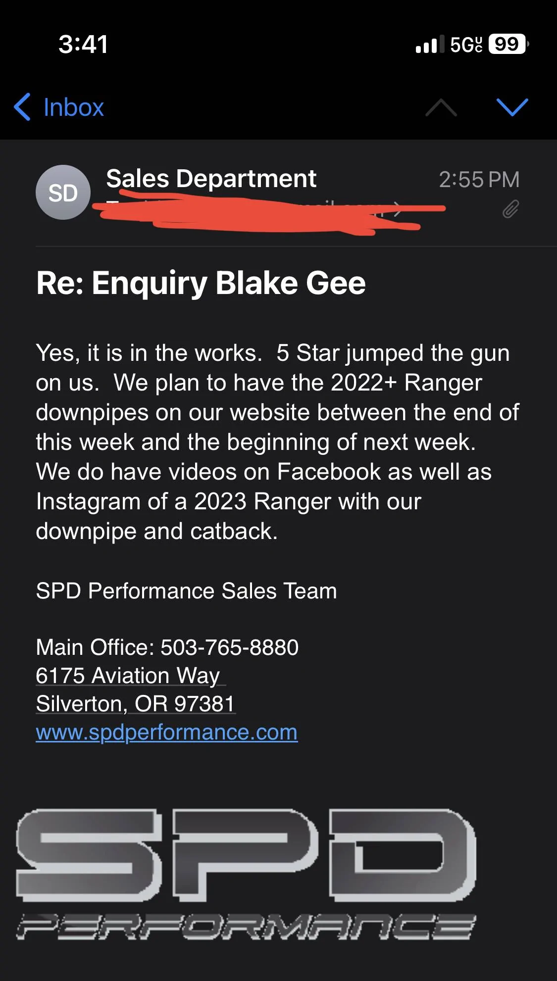

SPD is supposedly going to be releasing a DP for 22-23, it says for summer 2022 release, maybe a typo?
https://5startuning.com/product-category/2019-ranger-2-3l-ecoboost/2019-ranger-2-3l-downpipes/
I knew SPD was looking for a demo truck, in fact I had posted a thread not too long ago asking people to reach out to them if they had any interest.
It sounds like they may have received some interest, which only benefits us.

made an inquiry on there website about what I saw on 5star website, so it is coming soon!
