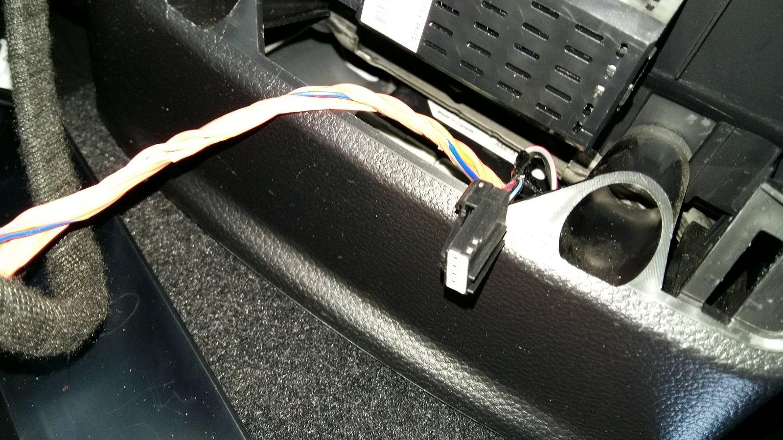

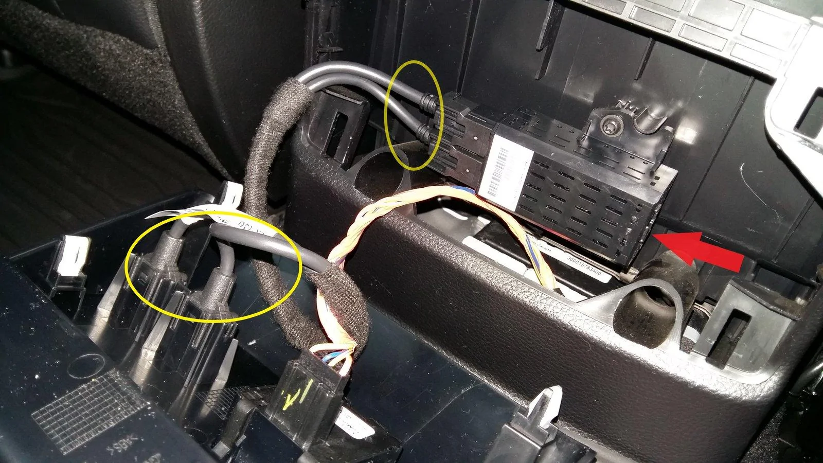

***1/16/2019 Update*** Unofficial Solution Available, USB Port Cables Were Not Plugged In From Factory
Well I found my first flaw, I have been trying to figure out why the rear seat usb charging points do not work, checked fuse etc, nothing. So being who I am I couldnt resist having a boo at whats behind it and heres what I found
The yellow circles show the cables to the 2 usb ports, the little black box(inverter?transformer, maybe just a splitter,) should be fed at the red arrow by what at first glace looks similar to a CAT 5 cable plug, but nothing is there or immediately visible. So now that my curiosity is satisfied, maybe I should check with the dealer
