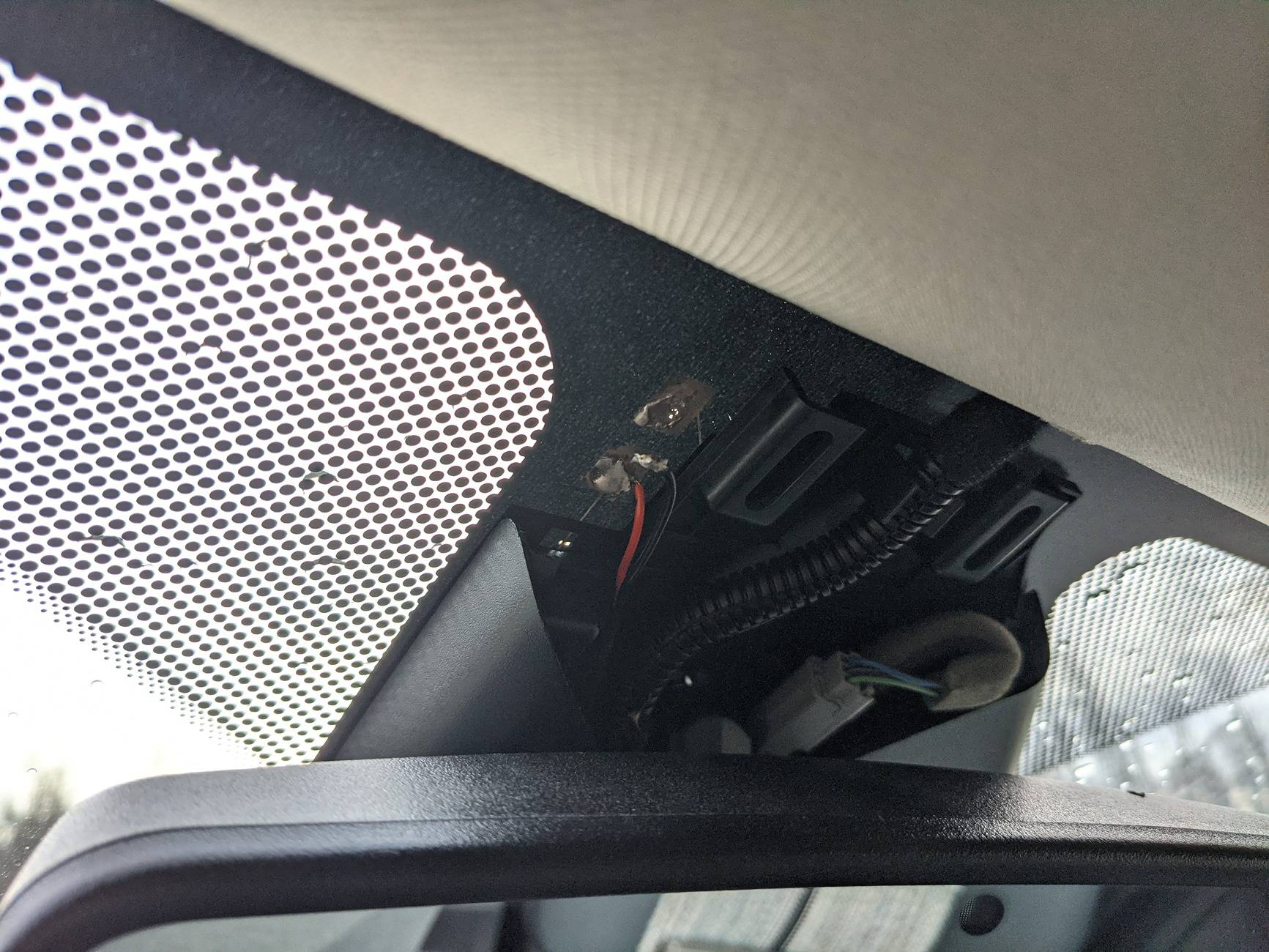

I started to install a dash camera using a mirror power tap harness for power and found one wire had come unsoldered from the windshield. Assuming it is for a defrost line for the front camera.
Is there any special instructions for resoldering this to the glass? Worried about heating and cracking the glass.

Don’t think it’s defrosted wires but for your oh shit someone is stopped in front of you and your not stopping fast enough collision camera. mine was the same way. I was lucky enough to get it resoldered. Scared the shit out of me the next time I drove and the huge red light started flashing at me approaching a car.

I would just break out the soldering iron and resolder it.

I have used this method a few times in my career and it worked, sometimes if there is enough solder on the back of the tab, you may not even need have to add any
