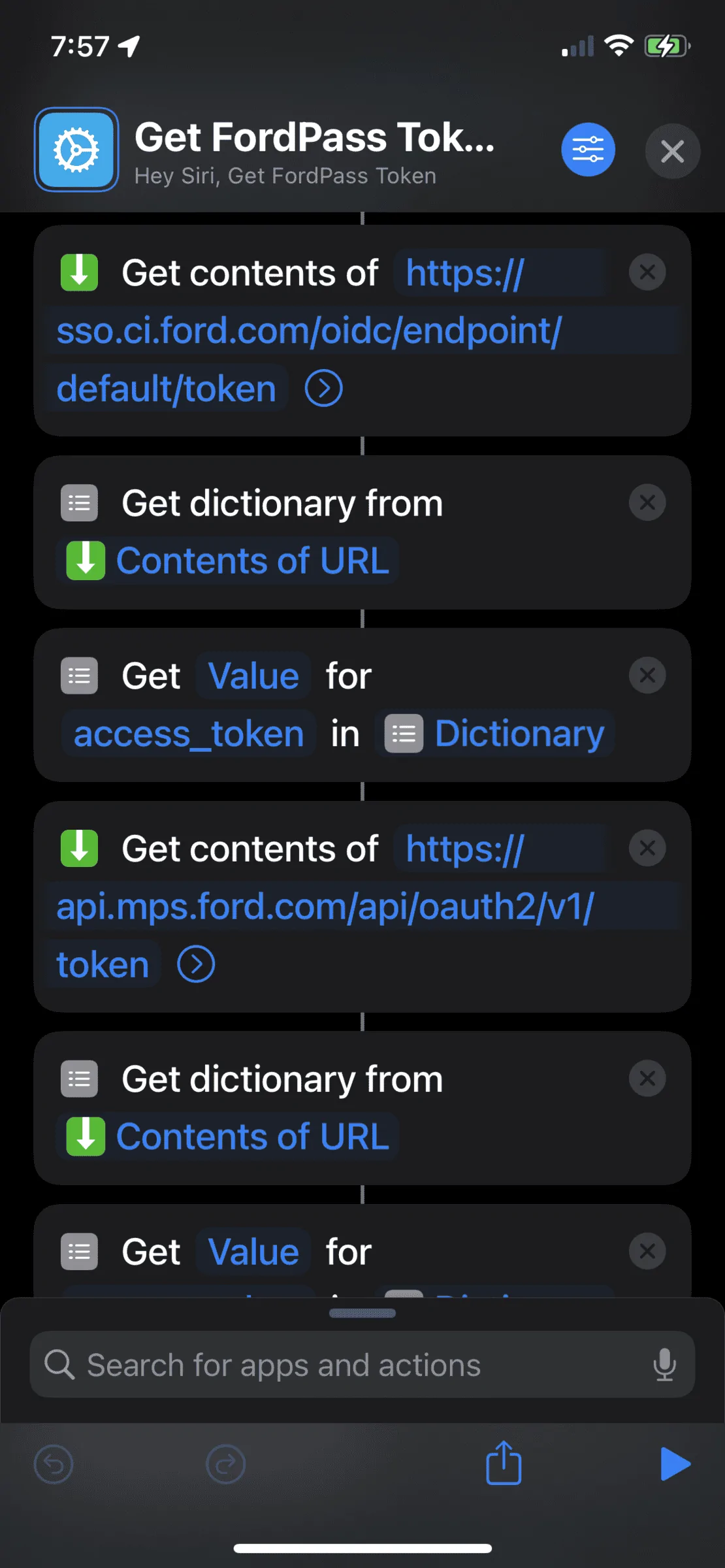

Cool, we're getting there. It is failing in the "Get FordPass Token" shortcut.
Does it say "14 actions" on the "Get FordPass Token" shortcut?
Open the "Get FordPass Token" shortcut. Are there two (2) "Get contents of" with an https URL following them? Those little lines between each step MUST look like this:
amick1995
Alex
Jun 14, 2021
128
264
CO
2021 Ranger Lariat Trenor

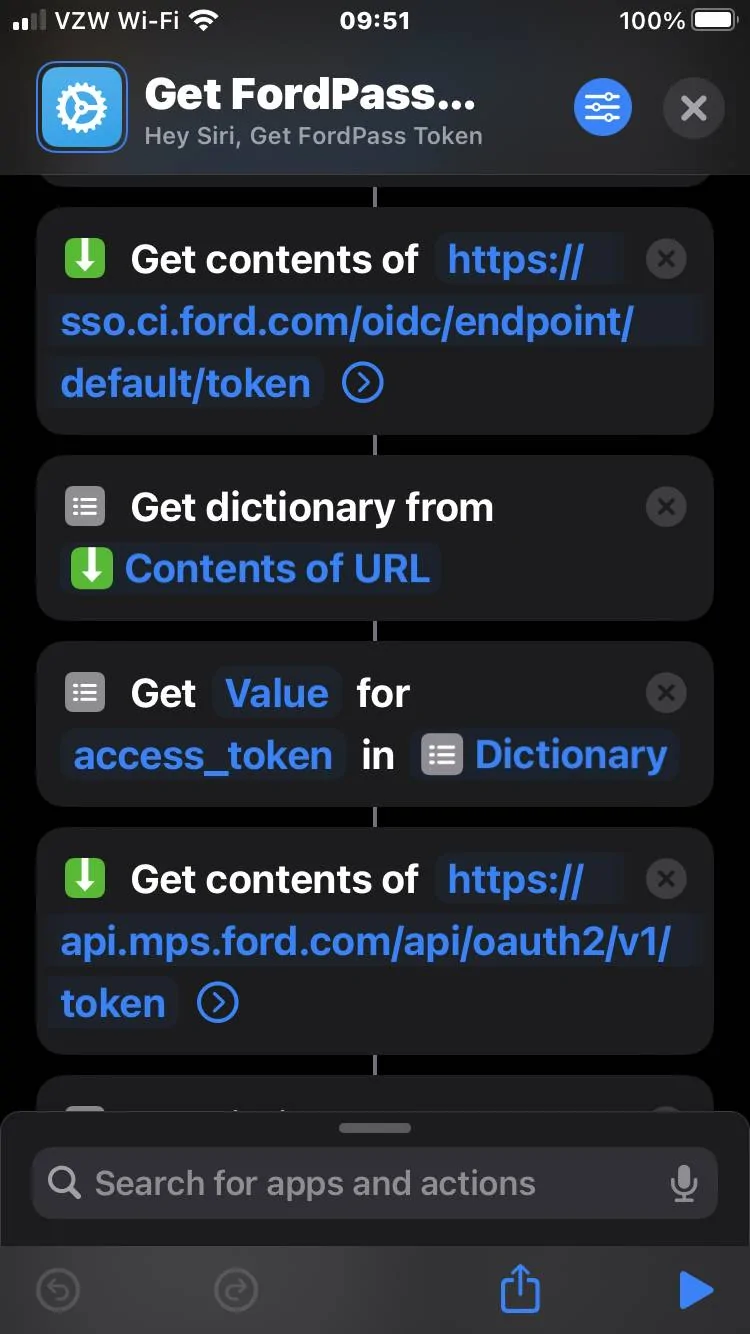

Mine has 14 actions and looks the same, when I run it the shortcut doesn’t say it fails.
Edit: the is my vehicle running command is the only one that runs successfully
port43
Dec 12, 2020
657
1,950
Detroit Suburb
childrescuecoalition.org
Secret agent, man
No, it wouldn't say it fails but after running it it should show a text box at the end of the shortcut with a token in it.
If you click the little ">" in the circle next to the first URL it should be a "POST" method with a "Form" request body and it should list client id, username, etc. under the "Form" section.
The SECOND URL should be a "PUT" method with a "JSON" request body.
