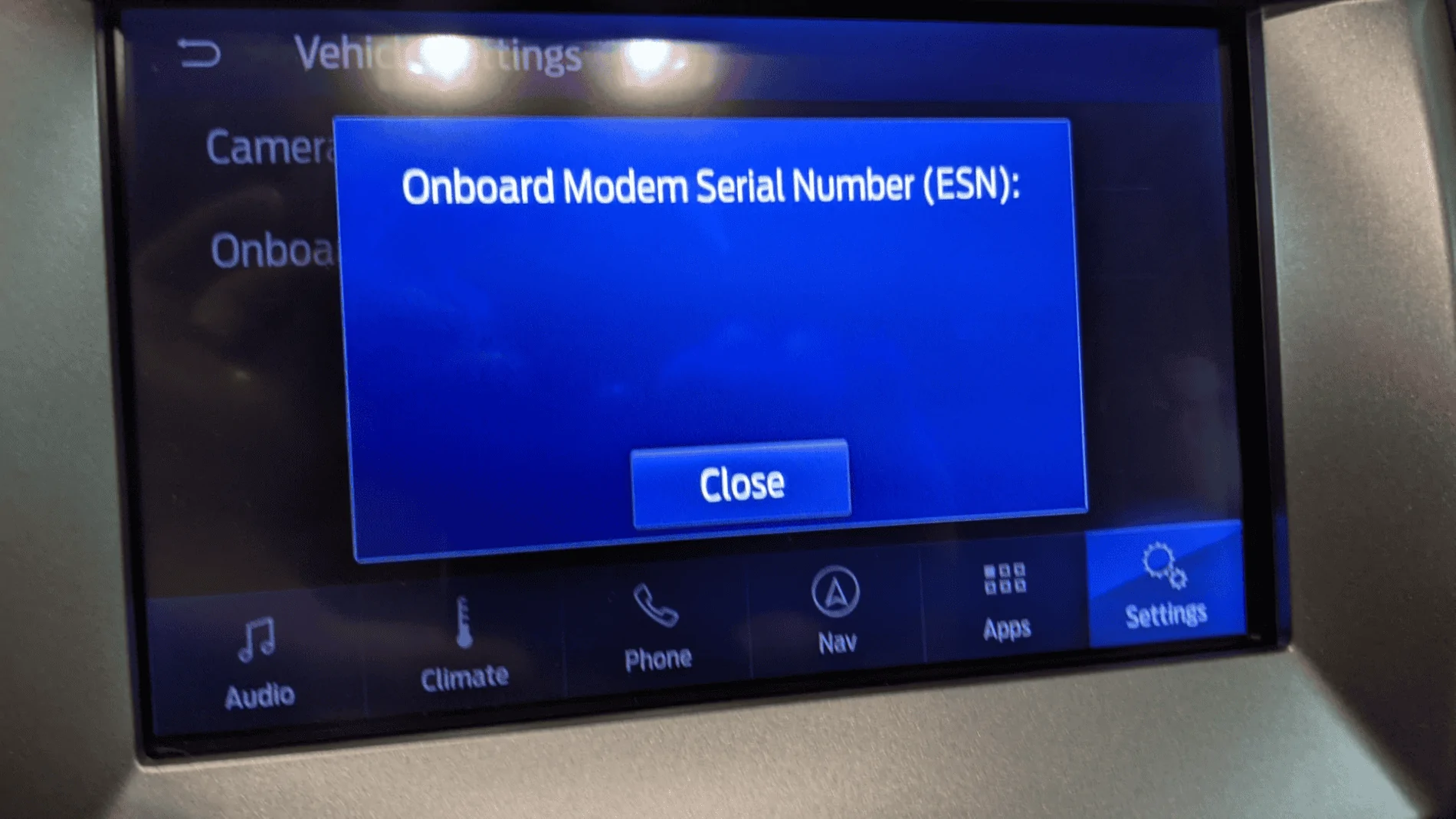

Check in the vehicle settings and see if you have an ESN for the onboard modem. If it is blank (no ESN), your modem is bad. Mine is too, but I just don't care enough to deal with taking it in. It's a known problem.
