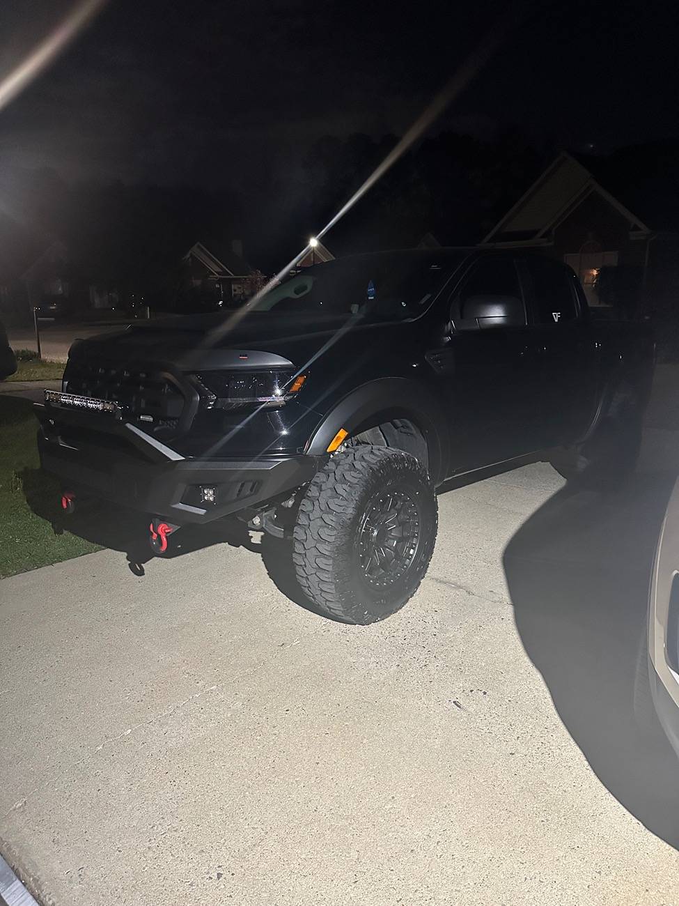

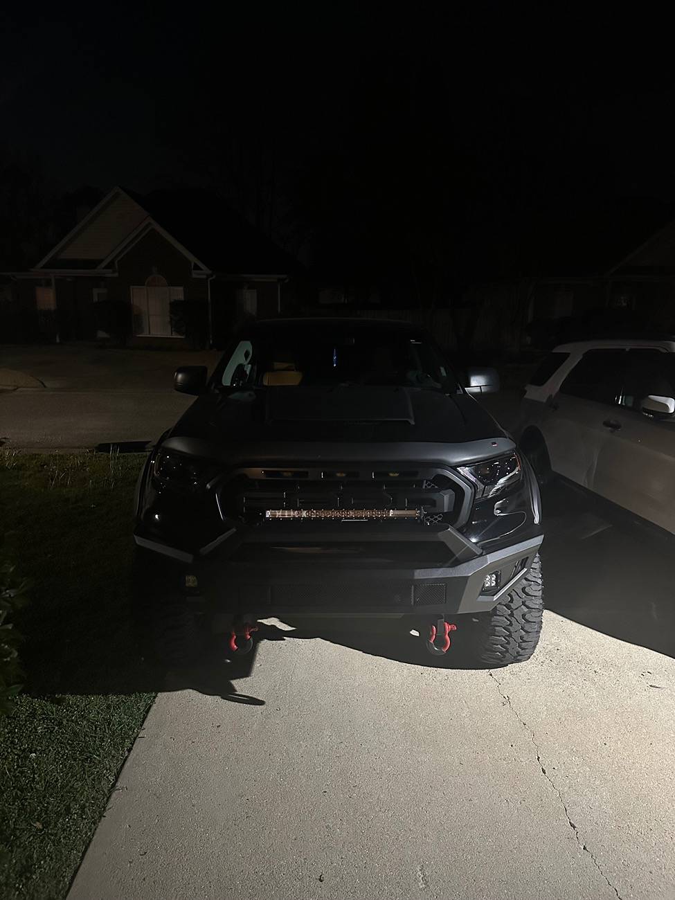

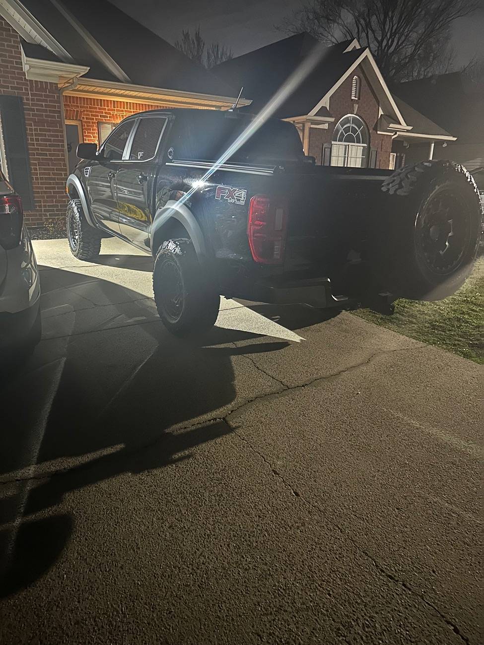

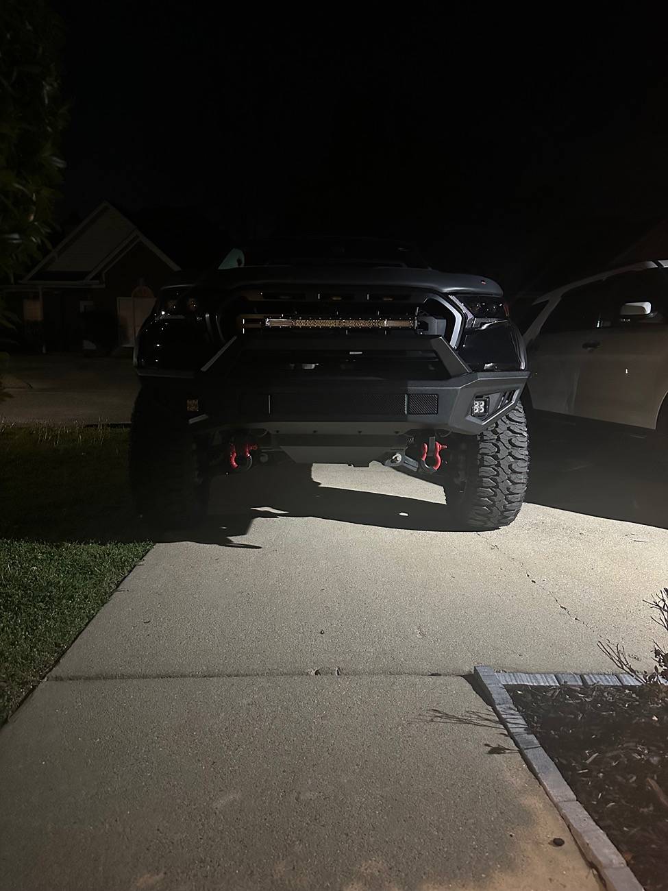

Hey everyone,
First post here and new to the group. My Ranger has a slight pause/stutter from 3rd to 4th gear. Any ideas of what I’m looking at here? Any advice/thoughts would be appreciated. Here’s some pics of my ‘20 Ranger XLT for your view too, thanks!
