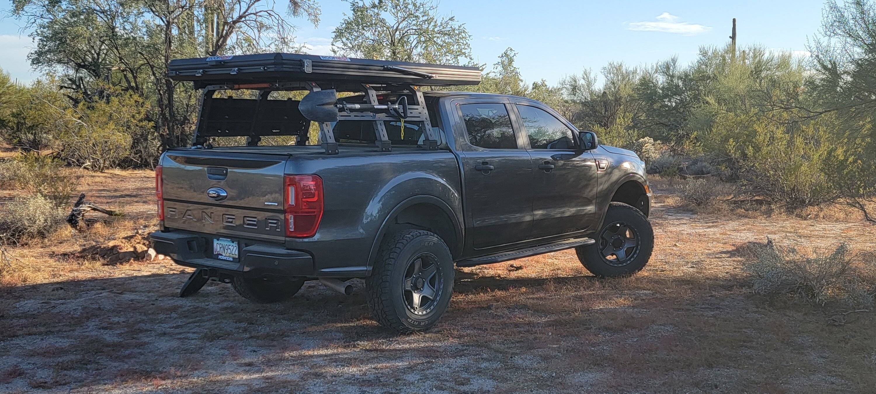

Im running a modified RCI rack with their lifted mounting brackets. My tri-fold tonneau will not open with this rack which is kinda good for security reasons. The bed is so short on this truck that I can just drop the tailgate (non dampened) and reach whatever I need. If you have to haul something taller than the tonneau then there's a problem.
As for getting in and out of the tent. I just leave the tailgate down and place an ice chest on it and I can stand on that to get in or out. Very eazy.
That is pretty cool. You are right that not being able to open the tonneau cover all the way due to the rack is not a big deal with the short bed at least when the rack is installed especially with your strong arms due to not having a damper. ?

So there are 7 pages of replies that I'm not going to read through, so I apologize if what I'm saying has been discussed already - at least you know it's not a biased opinion based off of others' thoughts.
1) I would probably recommend getting the Outpost (or similar from another brand) instead of just an at-rail-height rack system. I say this because I have my Overhaul set at the minimum height of 18'' (though I'm soon to modify it to drop it down to 15''), and as it is, it makes crawling through the bed to get something a little bit more of a hassle. If you have a RTT right above your bed, you literally won't be able to access anything in the bed that you can't reach from the tailgate.
2) I would also not really recommend going with the Overhaul. I just took mine off (needed to get large furniture that wouldn't fit under it), and have been driving around without it for the past few weeks - it's legitimately a 2-3mpg hit just having the crossbars up there. I'm excited to cut mine down to get it inside the profile of the cab. Note, fuel economy isn't why I'm doing that, but I'm hoping it's a nice benefit. Plus, you're putting a lot of weight up high on the truck, which is never good for handling purposes. It might seem like a small amount, but the curb weight is ~4000lbs, and let's call it at 30''. Adding a 200lb RTT at 70'' raises your center of gravity of the truck by ~2inches. That's HUGE. Conversely, adding it at 65'' raises it 1.66inches. So I guess you could say that you're only talking 1/3 of an inch difference between the two, and that's not as huge of a deal, but to each their own.
3) As for the tonneau cover, I have the Ford retrax, which I believe is the pro version since it's metal slates. The main downside to it is that you're taking your 5' bed and making it a 4.5' bed. The aforementioned reason that I took my rack off was to buy furniture, and the bed of the truck ended up being really small. I still would get the cover because my truck is very purpose built, and it supports that purpose. I just wanted to let you know that it is a relatively big hit to truck flexibility.

True, a bed height one would be better for CG as well as fuel economy. However, it will also 100% block any visibility out the rear window. Obviously so do a ton of trailers and other options, so that's not a 100% deal breaker for people. One thing that I might consider if I was to just do it all over again, would be a bed topper. My use of the bed rack is for my kayaks, but I don't think a RTT would really be any different of a use. By the time you're done with your tonneau cover and overhaul rack and brackets and whatnot, you're around 3k. That's not that far off from getting a high quality topper. Now, I don't have a topper, but what I will say is that it gives you more space for gear, is less intrusive to doing other things with it, and doesn't really change the access to the RTT compared to having an overhaul. I'm not saying that I would have decided it was the right thing, but I definitely would give it a good hard consideration.

Get the Outpost instead. I sold my Overhaul and bought an Outpost. I used the same HD crossbars. I have no mpg hit with the Outpost, since it is under the cab height. When the RTT is up there, the truck is more stable having the RTT 5-6 inches lower. Also with the RTT, I have a ~2 MPG hit.
Note that anything lower than the Outpost, you will want to check your RTT. Many RTTs open out on all four sides. If the rack is too low, the RTT side towards the front of the truck will not be able to be opened, or popped out. I have a Yakima RTT and had to ever so slightly bend the rain fly supports on the front to not hit the truck cab roof. Any lower and my RTT would not work.
